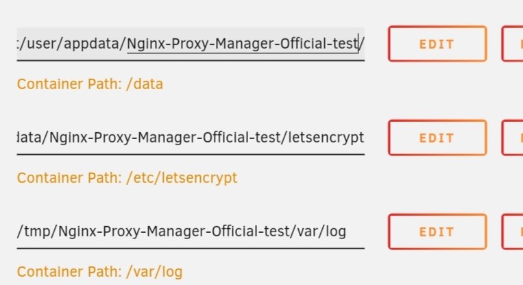

3 minutes ago, mgutt said:
Please execute the following to check all permissions:
ls -la /mnt/user/appdata/Nginx-Proxy-Manager-Official /mnt/user/appdata/Nginx-Proxy-Manager-Official/*
ls -la /tmp/nginx-proxy-manager /tmp/nginx-proxy-manager/*
Did you restore in the past a backup of your appdata directory and/or NPM directory?

I haven't restored any backups, it's on a fresh install.
Ok, I found the bug and updated the container template. Please uninstall NPM and delete the NPM files through the Appdata Cleanup Plugin. You can re-install NPM in ~20 minutes (CA is only updated every 2 hours).

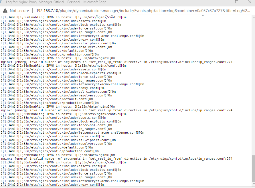

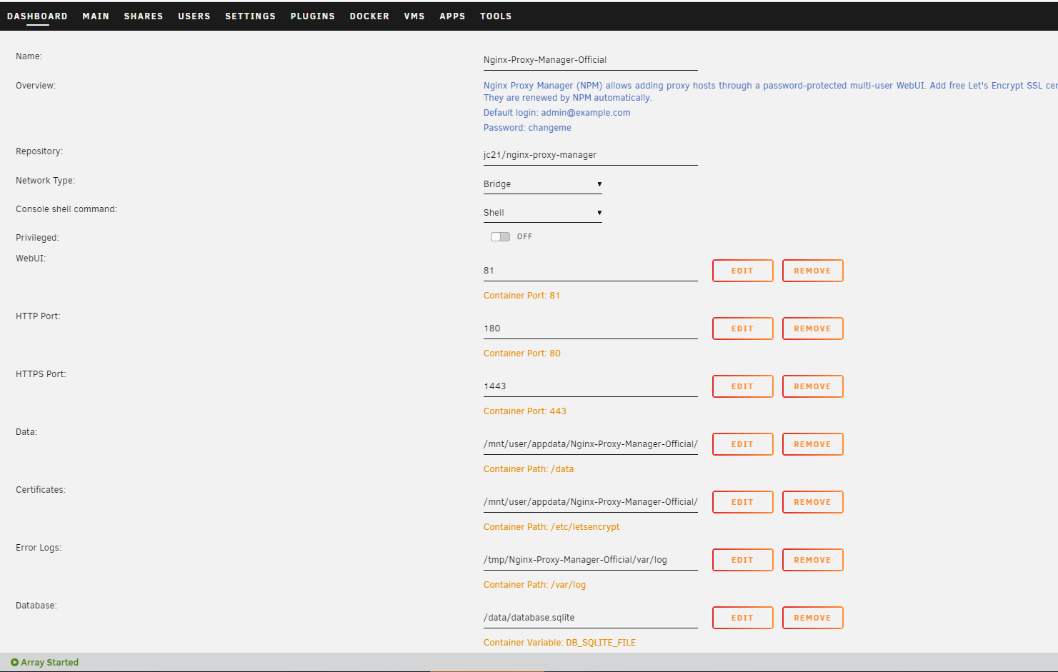

Starting last night, when I try going to NginxProxyManager it just does not want to load anymore.
Here is a quick video showing what I mean: https://youtu.be/x3jTCwPrHPM
Here is an image of the container's configuration page: https://i.imgur.com/ZsUsBrl.png
Could I get some assistance please? Because of this my users can't access Nextcloud so I'd like to get this back up and running.
Edited by jeremytodd1

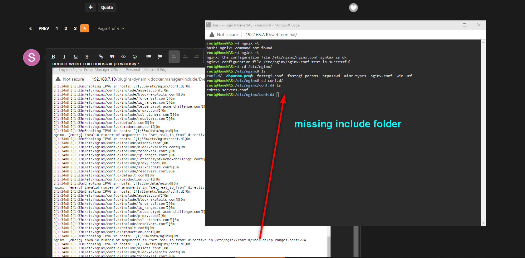

I am missing "include" folder during installation as well . (as shown in my attachment)
5 hours ago, spacezmonkey said:
or is it due to files or folder left behind when i did uninstall previously?
Maybe. Do a simple test. Change the name of your installed container. Then go to the apps and install it a second time, but this time you change all three paths, so the second installation uses different folders. Example:
Hello Sir,
I am getting the same error with a new folder. i have added "-1" to all the 3 link. Is it something to do with my wrong configuration at port forwarding?
Hmm. Strange. I did the same and it was installed successfully. 🤔
Found a mistake in your checks. You used Unraid's webterminal to find the include folder. But you need to use the console of the container:
Then check the content of the file with the following command:
cat /etc/nginx/conf.d/include/ip_ranges.conf

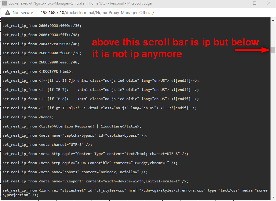

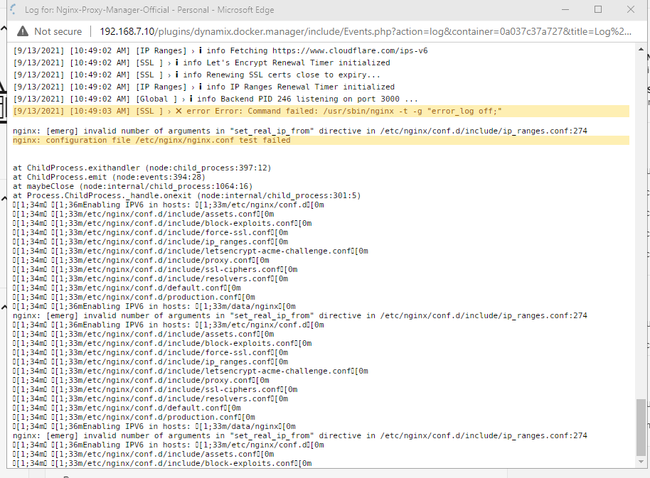

Thank you very much for helping me..i found my ip_ranges.conf file...but when i perform cat /etc/nginx/conf.d/includ/ip_ranges.conf
it show a list if ip address until a point , it changes to text..

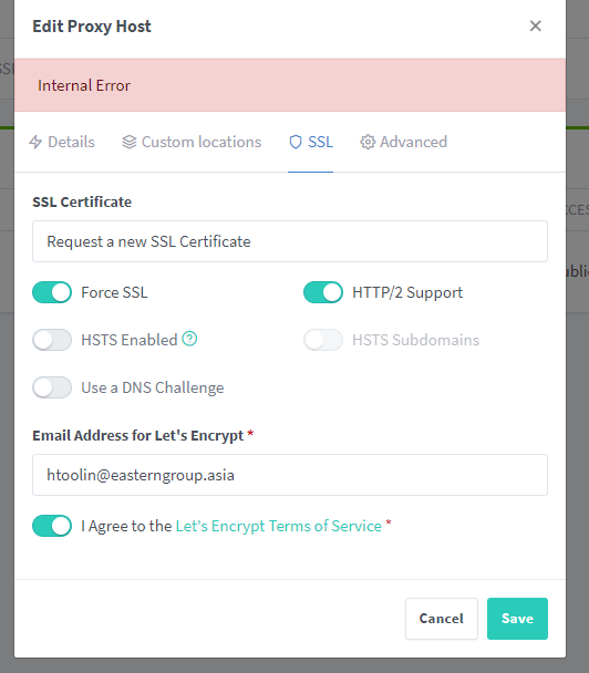

i am able to log into webui for setup, but i am unable save the setting. It show "internal error" and status is not shown "online".
59 minutes ago, spacezmonkey said:
Ok, you found a Bug in the NPM. This HTML code should not be part of this file.
As long this bug is present, please execute this, to remove the HTML code:
 sed -i '/DOCTYPE/Q' /etc/nginx/conf.d/include/ip_ranges.conf
Please verify with "cat" if it worked.

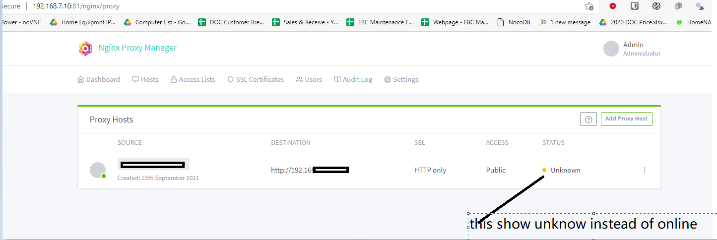

Hello ,
it works....😀 and setting are saving now... and status changed to online...
however, when i restart the docker container, the html code reappear and i have re execute below code. Is there a way to make it permanent?
Anyway i am very happy that docker container is working well now.. 😄
6 minutes ago, mgutt said:
Ok, you found a Bug in the NPM container. This HTML code should not be part of this file.
That happens, because NPM talks to an online API to get the recent list of this IP addresses. As you can see here, it tries to access three different URLs:
https://github.com/jc21/nginx-proxy-manager/blob/b39a59ce72eb032d5b725dce90dd6f3cf08b7d29/backend/internal/ip_ranges.js
And this is done every 6 hours, so it will happen again even if you don't restart the container😒
Maybe you should try to open all three URLs through your PC and solve the captcha (if it hopefully will be shown) to "unlock" your public ip address for accessing them:
https://ip-ranges.amazonaws.com/ip-ranges.json
https://www.cloudflare.com/ips-v4
https://www.cloudflare.com/ips-v6
Or try to lock the file with the following command:
su
chattr +i /etc/nginx/conf.d/include/ip_ranges.conf
A file with the "i" flag can't be modified or deleted.
Optional: If you need to make it editable again:
chattr -i /etc/nginx/conf.d/include/ip_ranges.conf
