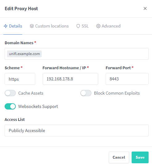

5 hours ago, jackwan1 said:
when I tried to do the same for others, I do not get the steams.
Did you enable cache assets? (you should not)
Your said RTSP. Doesn't it use Port 554? NPM listens only to port 80 and 443. If NPM should listen to 554 you need to:
- open the port 554 on your router with NPM as your target
- open the advanced config tab of the proxy host and add the following rule:
listen 554;
If this does not work we need to check the nginx.conf. This the nginx conf, created by NPM if no option has been enabled:

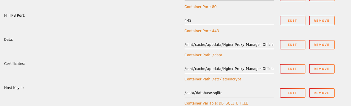

Dear @mgutt
I think I found a typo in your template because I don't remember in setting this folders.
It seems that you set Data and Certificates to /mnt/cache/appdata instead of /mnt/user/appdata.
My UNRAID has different cache drivers and I found the NPMO appdata in the wrong drive. LOL
I don't know if it was something I did before and my UNRAID kept the template saved. However, I would suggest for you to double check there.
Thank you again.
All the best,
Lucas
17 hours ago, mgutt said:
This is something which will be removed in future Unraid versions. My suggestion: Run NPM as host and run all other containers as bridge.
Ohh, thank you!.
I will redo the settings with your suggestions.
Should I set "Privileged" on in the NPM?
I forgot HOST network provides the UNRAID server IP to the docker.
I will follow your Plex suggestion @mgutt making a new bridge network and add it to the NPM. I think it is the safe way to go.
Thank you very much for your time and dedication. Your work is awesome.
Lucas

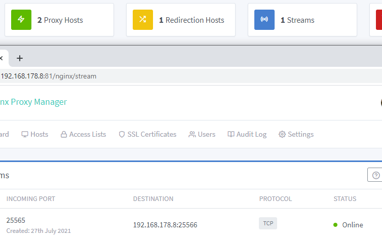

But I think it should even work with a "stream" rule as mentioned here:
https://stackoverflow.com/a/66621298/318765
NPM supports stream rules through the stream tab, which I'm using for my minecraft server (but you can't add multiple streams for the same port depening on different domains):

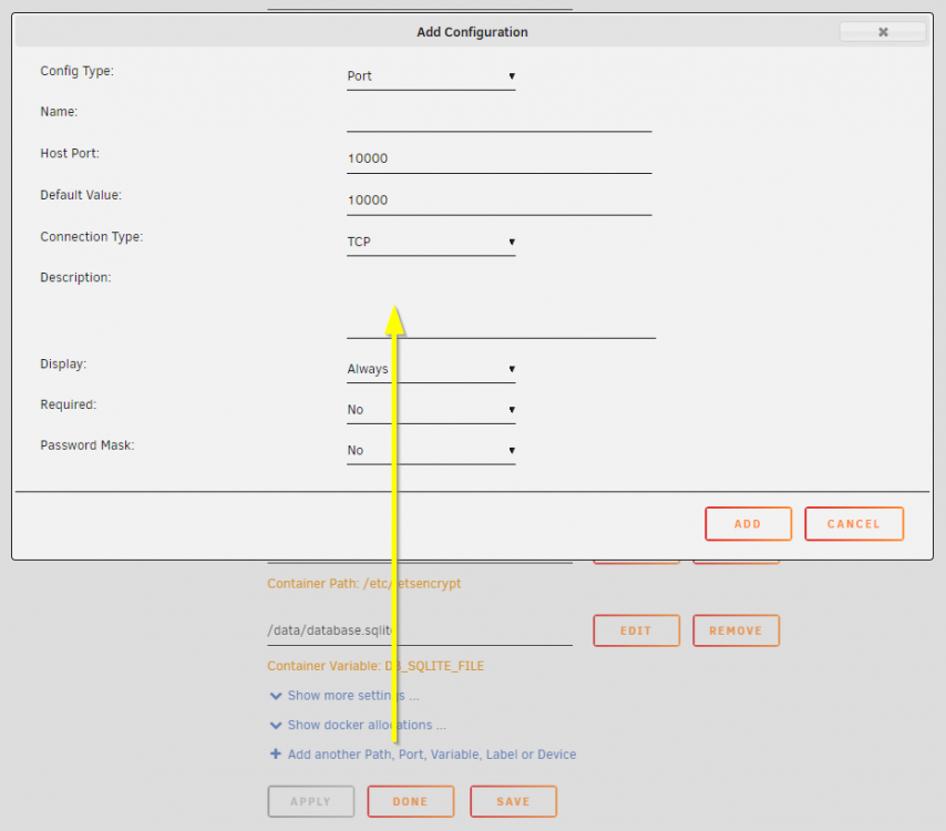

b) allow NPM and your proxy host, to listen to port 10000 by adding this to the advanced config:
listen 10000;
Now, NPM does not listen only to the ports 80 and 443. It listens to 10000 as well.
But beware, this does not work if your webmin container and your nging proxy manager container both use the same network like bridge (as only one can listen to the same port). So it could be necessary to change the webmin container host port to for example 10001 while its still listening internally to 10000:
Of course you need to change the NPM proxy host accordingly, so it forwards the traffic from 10000 (and 443) to 10001:
And if NPM is running as bridge, you need to add this port in the containers config:

9 hours ago, jackwan1 said:
There is a suggestion on a websocket fix on ubiquiti community forum.
I tried to reverse proxy the Unifi Controller Container. As long I did not enable Websockets I received this error message:
But after enabling "Websockets Support" in the Proxy Host settings, the error was gone (but I never had an empty UI):
Another important part is the "https" Scheme as unifi does not allow communication through "http".
Note: Enabling Websocket Support adds these rules to the nginx config file:
proxy_set_header Upgrade $http_upgrade;
proxy_set_header Connection $http_connection;
proxy_http_version 1.1;
This would be the complete config if you enable Websocket Support, add SSL, force SSL and adding something through the Advanced Tab:
# unifi.example.com
server {
  set $forward_scheme https;
  set $server         "192.168.178.8";
  set $port           8443;
  listen 80;
  listen [::]:80;
  listen 443 ssl http2;
  listen [::]:443;
  server_name unifi.example.com;
  # Let's Encrypt SSL
  include conf.d/include/letsencrypt-acme-challenge.conf;
  include conf.d/include/ssl-ciphers.conf;
  ssl_certificate /etc/letsencrypt/live/npm-2/fullchain.pem;
  ssl_certificate_key /etc/letsencrypt/live/npm-2/privkey.pem;
  # Force SSL
  include conf.d/include/force-ssl.conf;
  # Websockets Support
  # Logs
  access_log /data/logs/proxy-host-3_access.log proxy;
  error_log /data/logs/proxy-host-3_error.log warn;
  # Rules added through the Advanced Tab
  #listen 8080;
  location / {
    # Proxy
    add_header       X-Served-By $host;
    proxy_set_header Host $host;
    proxy_set_header X-Forwarded-Scheme $scheme;
    proxy_set_header X-Forwarded-Proto  $scheme;
    proxy_set_header X-Forwarded-For    $remote_addr;
    proxy_set_header X-Real-IP          $remote_addr;
    proxy_pass       $forward_scheme://$server:$port;
So you don't need to add those results through the Advanced Config again. If you need to add rules, add only those that aren't already part of the config.

2 hours ago, Juise99 said:
ENOENT: no such file or directory, open '/data/nginx/proxy_host/7.conf'"
/data points to mnt/user/appdata/Nginx-Proxy-Manager-Official/data
So please check the content of this folder.
