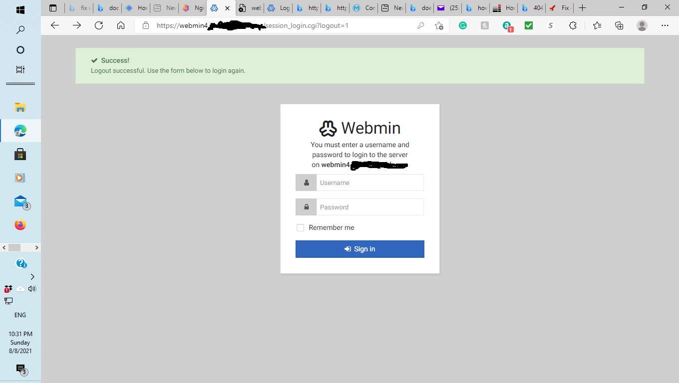

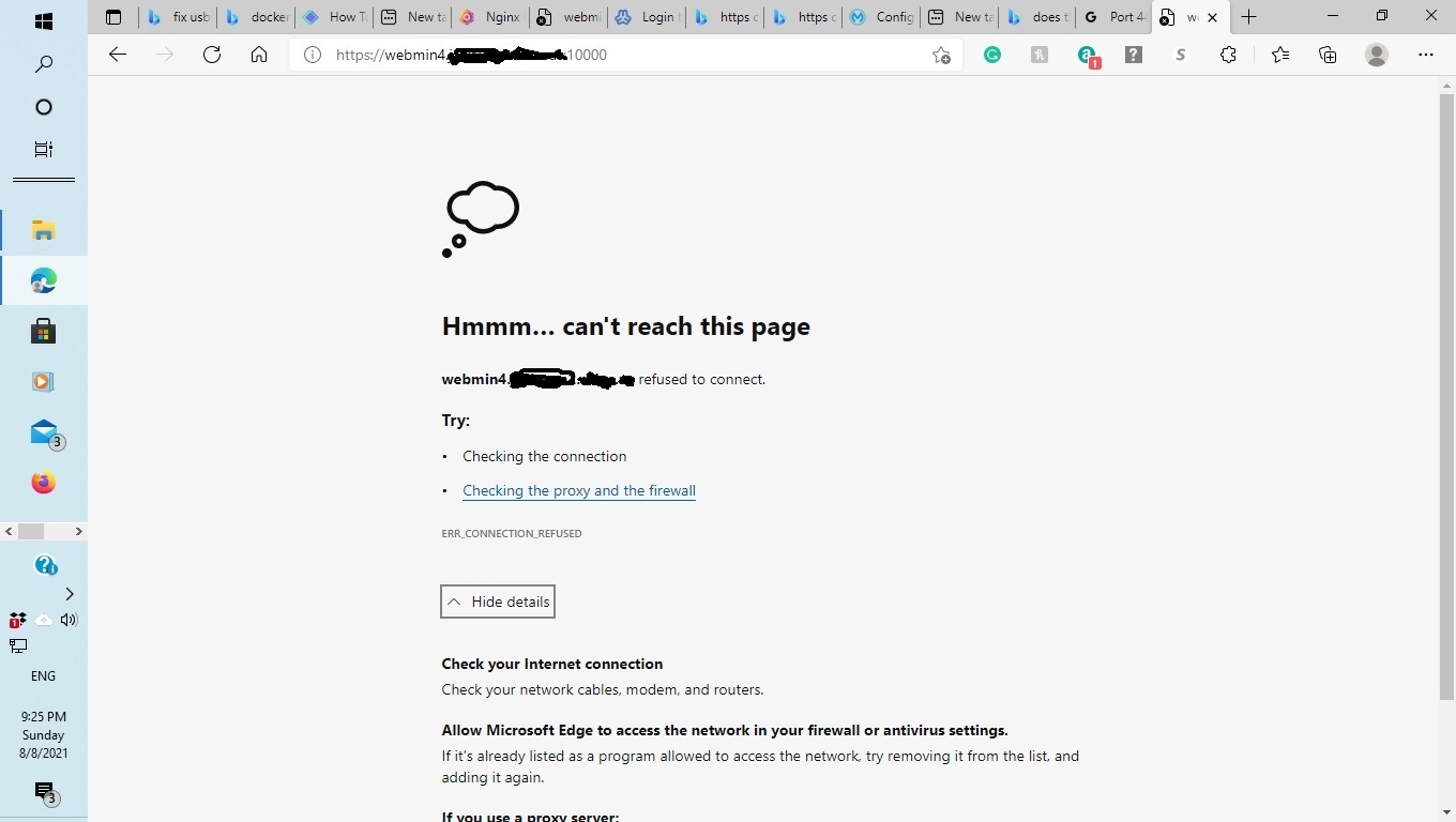

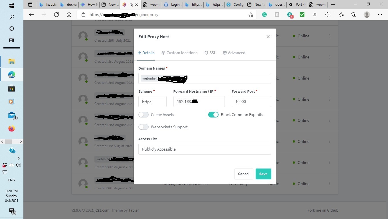

  12. OK @mgutt Your solution a. works, however I have to modify it as follows: proxy_redirect https://webmin4.dns:10000 https://webmin4.dns; Notice both urls uses https not one http and the other https. Once it passed the webmin login, the url became internal to the webmin, so it was https://dns:10000 all we have to tell nginx is to redirect it to https://dns, problem solved. And my external http to https Json conversion also works. so now all I have to do is type in a web browser the dns without http or https and it will reach the webmin login page and when I login, it goes to the dash board.
  13. Hi @mgutt I have a few elementary questions about setting up https in proxy-manager. 1. Does every dns require a separate ssl certificate? 2. Does the server has to listen on port 443 for https? I am trying to setup webmin access via proxy-manager, as you know webmin default port is 10000 and the default access scheme is https. so here is my setting in proxy-mgr, I also ran a ssl certificate in proxy-mgr for that. my config.json autoindex_localtime on; autoindex on; server { listen 80 default_server; server_name _; return 301 https://$host$request_uri; } location / { try_files $uri /index.html; } when I enter in the browser webmin4.dns name It has no problem to connect to the login page of [email protected],x (see photo) However, after I login I got a page like this. Note the url has port 10000 defined and it returns a bad connection error. If I remove the port designation(10000) on that error page, I will be directed to the webmin dash board, no problem defind https://webmin4.dns name wont help What did I do wrong?
