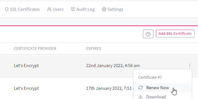

7 hours ago, braydination said:
[10/28/2021] [7:45:48 PM] [Express ] › ⚠ warning Command failed: certbot certonly --non-interactive --config "/etc/letsencrypt.ini" --cert-name "npm-6" --agree-tos --authenticator webroot --email "*****@gmail.com" --preferred-challenges "dns,http" --domains "sonarr.*****.com"
Your subdomain "sonarr" uses an lets encrypt ssl certificate which couldn't be validated. This could mean that lets encrypt was not able to reach NPM through "http://sonarr.example.com" (maybe because of your access list rule?!), which is a requirement to validate that your domain is controlled by you. You could try to re-new the certificate manually through the SSL Certificates tab, but at first check the above mentioned how-to, to validate, that NPM can be reached through the internet.
