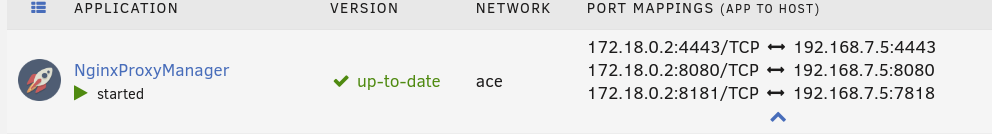

  10. So I tried that forwarding to port 444 in NPM, tired HTTP only then HTTPS (all without certificate) and the server just sends RST every time. So I went ahead and swapped the ISP router with my personal linksys router and I now can access valutwarden through my domain! I tried nextcloud, had some issues but I need to re-configure it back to square 1 but I am out of time and need to leave for work. It appears that the ISP router was blocking or re-routing? If I can get it all to work I will probably return their router and just use mine. update: I saw one thing I messed up, now nextcloud is working by accessing on my domain. All in all this was a router issue/settings that I am not familiar with. I really appreciate the help and hanging in there with me!
  11. I may have, I have tried many things over the last 4 months on and off. I followed the instructions but when I query for cloud.duckdns.org or just duckdns.org nothing came up. I went ahead and inputted both in the delete anyway. Normally I use brave but I tried the could.duckdns.org:8080 on konqueror and got the same result. I changed in my hosts file from cloud.duckdns.org to testing.home and inputted testing.home:8080 and get Congratulations! You've successfully started the Nginx Proxy Manager. If you're seeing this site then you're trying to access a host that isn't set up yet. Log in to the Admin panel to get started. So it seems something is redirecting that specific domain to unraid login and saves it? The difference between vaultwarden and nextcloud is http verse https; should I still have no issues in network using https?
  12. Yes like this 192.168.7.5 vault.duckdns.org cloud.duckdns.org When I ping could.duckdns.org, it returns from vault.duckdns.org (192.168.7.5) The port disappears and the new url looks like this: https://cloud.duckdns.org/login (line through https)
  13. I tried again with both nextcloud and vaultwarden domain added to my hosts file, here are the results: Valutwarden: vault.duckdns.org - Unraid login screen vault.duckdns.org:8080 Valutwarden login screen Nextcloud: cloud.duckdns.org - Unraid login screen cloud.duckdns.org:8080 Unraid login screen cloud.duckdns.org:4443 Unraid login screen cloud.duckdns.org:444 Nextcloud login screen It appears that if I try to go through NPM, I am re-directed to the Unraid login screen
