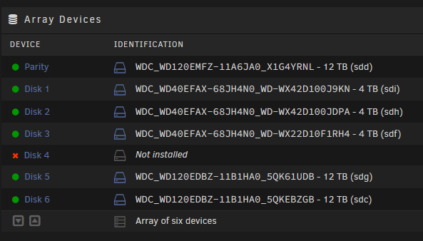

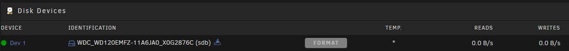

  6. I've been having a couple issues lately with a HDD from my array show as not installed as well as GPU not showing up. I just swapped over my HBA and GPU around in their PCI slots on the motherboard which seems to have fixed my GPU issue. This swap has also now decided to show my missing HDD upon reboot under the 'Disk Drives' section. This is the first time since it started showing as not installed at has appeared at all. I tried to stop the array and add it back under 'disk 4' but it didn't seem to do anything. It is letting me preclear. Should I do this and let the array rebuild the drive?
  7. I've encountered this same issue and been really reluctant to even take it offline as everything has been working fine, I can even access the data on my disk4 using MC. Based on the previous reports I have also uploaded my diagnostics and can see no 'disk4' under the SMART logs. I'm afraid this means a new HDD will be required, but am really hoping not. citadeltower-diagnostics-20231229-1405.zip
