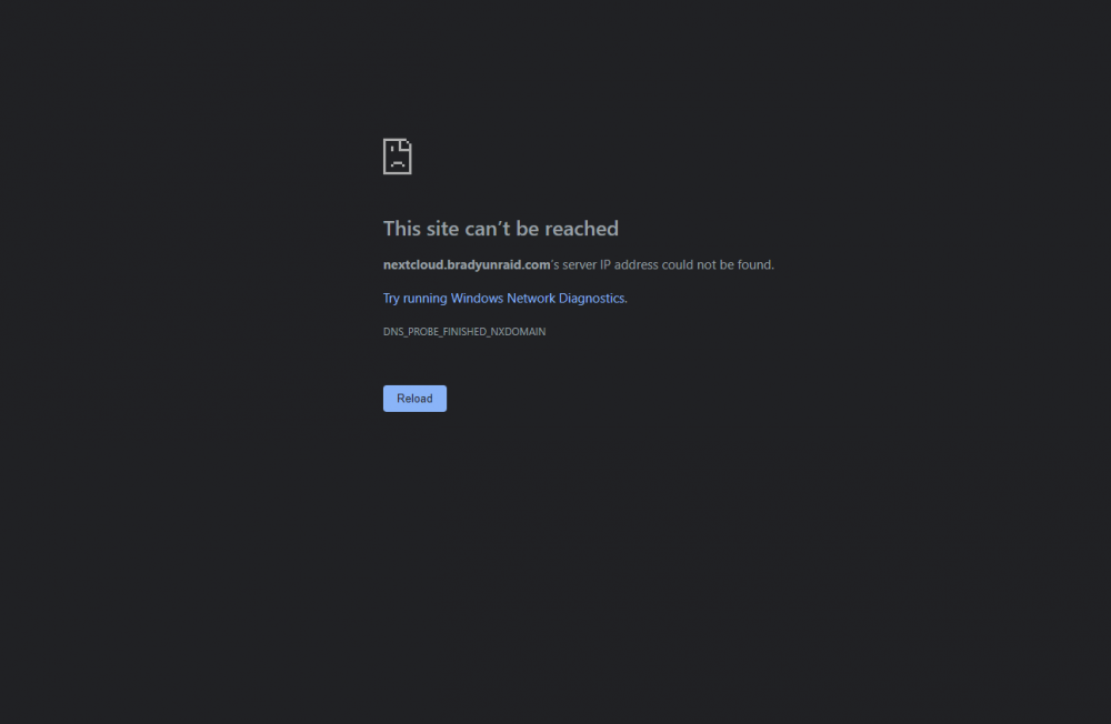

Not sure where I have gone wrong. I have setup my own domain and made the necessary adjustments to my config files, but after restarting both letsencrypt and nextcloud dockers, I cannot load Nextcloud at all. I have attached the error I am getting whether trying to access directly from the web url or from the IP address attached the docker. -
