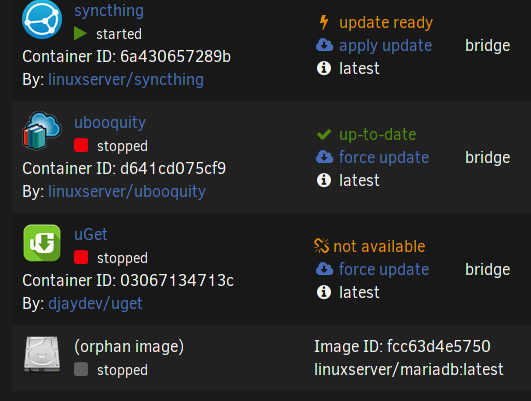

August 26, 20215 yr Author Hello, thank you for help. I change repository to linuxserver/mariadb:110.4.21mariabionic-ls31, click apply, but now can not find Mariadb in Docker Containers. Its missing. Please where I can find now Mariadb config file to change and start again? Now I find container in orphan image. How I can rebuild again? Edited August 26, 20215 yr by Pava
