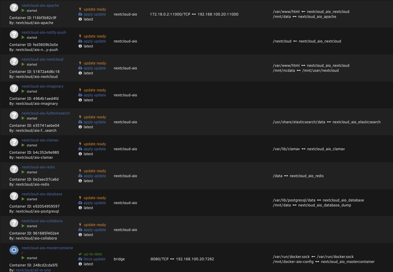

  4. Hello many thanks for your help. this is very strange because i cannot access the mastercontainer webui. i also noticed that for some unknown reason the ip address from docker on this container is missing, still my unraid instance is working fine. has anyone encountered this problem? EDIT => ok never mind. found it upon posting my screenshot. For some reason the network reverted to bridge instead of nextcloud-aoi. this probably went away when i updated unraid to 6,12,14
  5. How exactly do you update the different components on unraid nextcloud AIO now ? each time i try to update a get a message saying "configuration not found. was this container created using this plugin? All my dockers display update ready apply update but nothing to update.

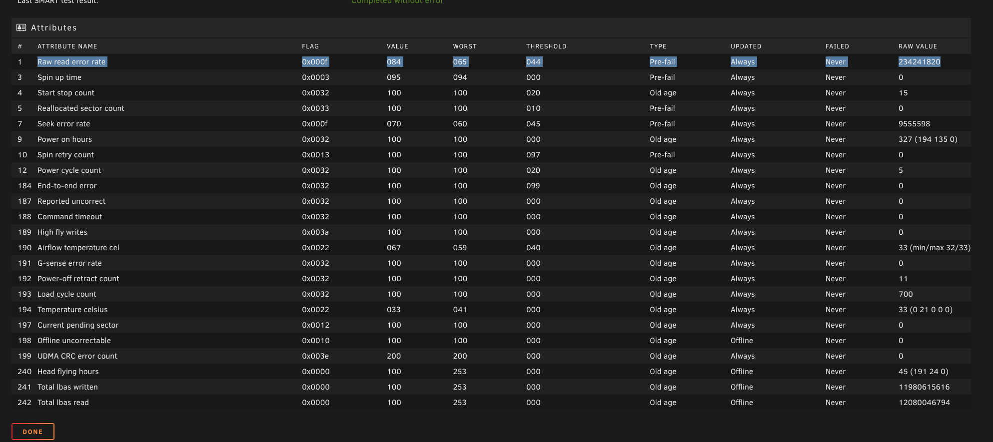

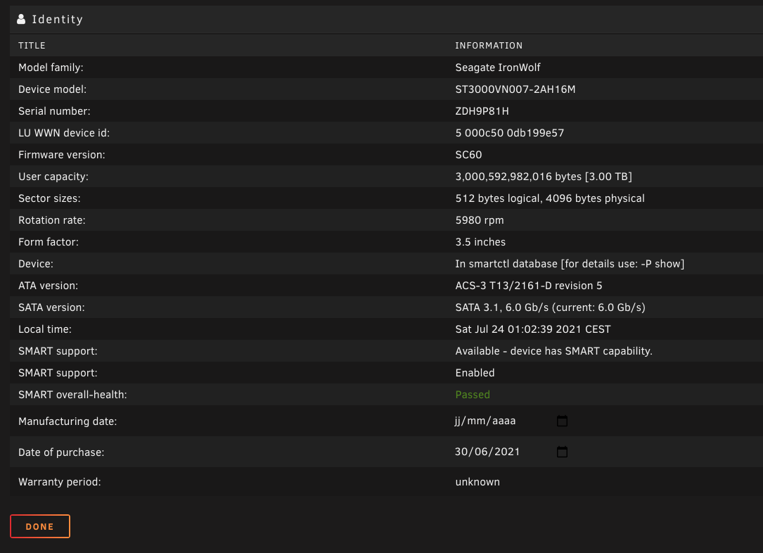

  12. Hello. Many thanks for the link. indeed it seems normal. still i think this drive is toasted while being brand new. todays hard drive quality is not up to yesterday's standards. i moved the drive to another backplane and in another tray. change the sata cable with another one. everything was different. i have stressed the drive with the pluging "preclear disk" no problems found. so re inserted the drive in the pool. rebuilt the parity. everything was good for a week and then the drive failed again with high count of raw read errors. i am going to try a western digital drive.
