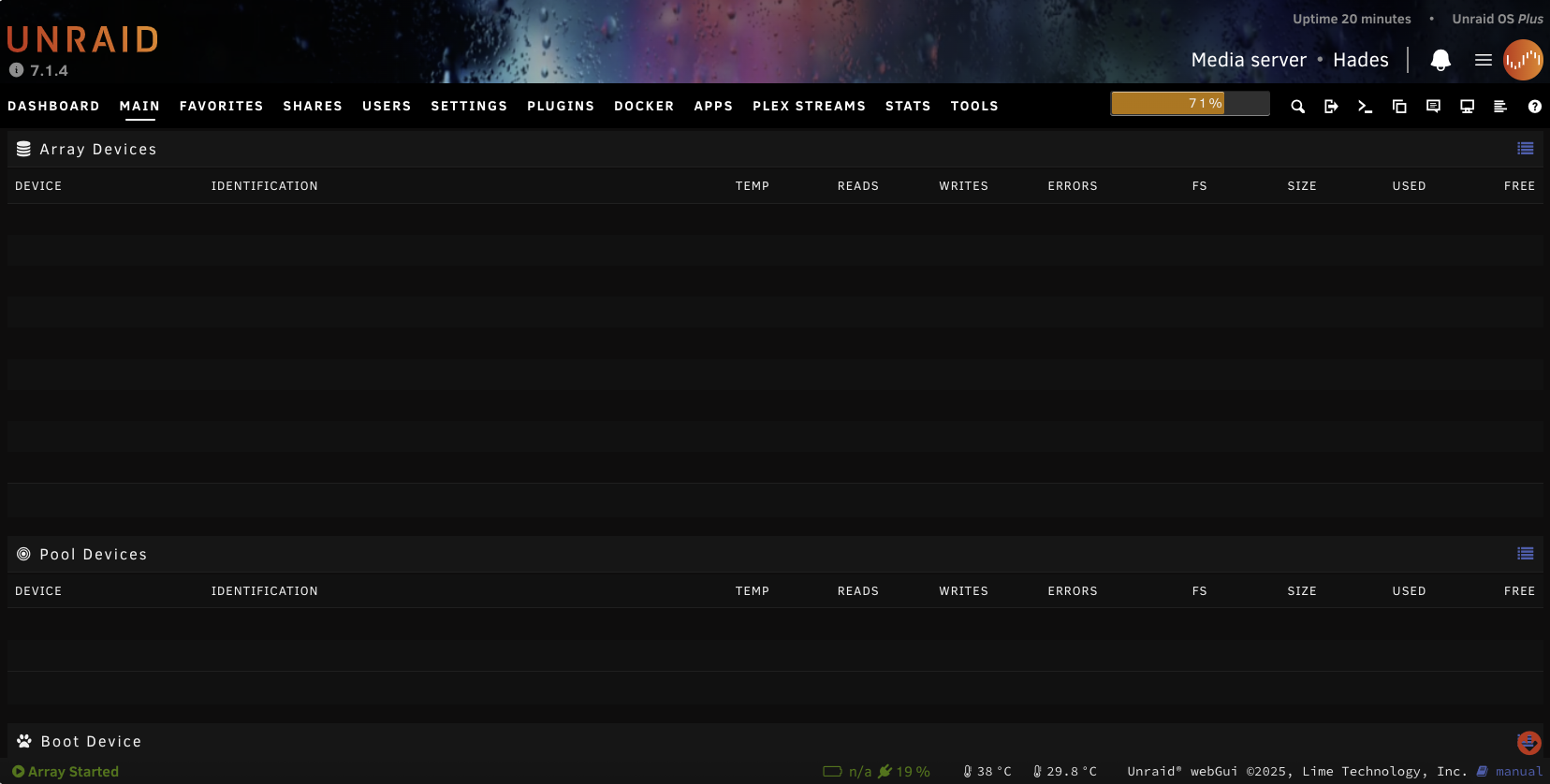

I just upadted 2 servers, 1 went off without problems, but the other is having some issues with displaying some of the webgui after the update. Some sections of the dashboard, and most sections of the main page are just blank. No disks are showing, no network devices are showing, etc
Any suggestions on how to resolve this?

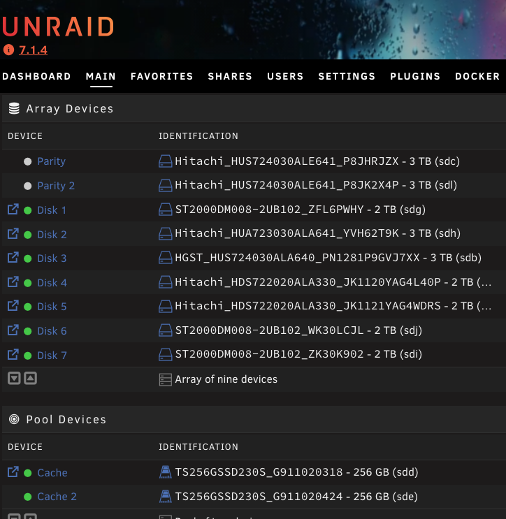

Does it work correctly with a different web browser? Try flushing your browser cache.
That worked. But now what could be the issue then?

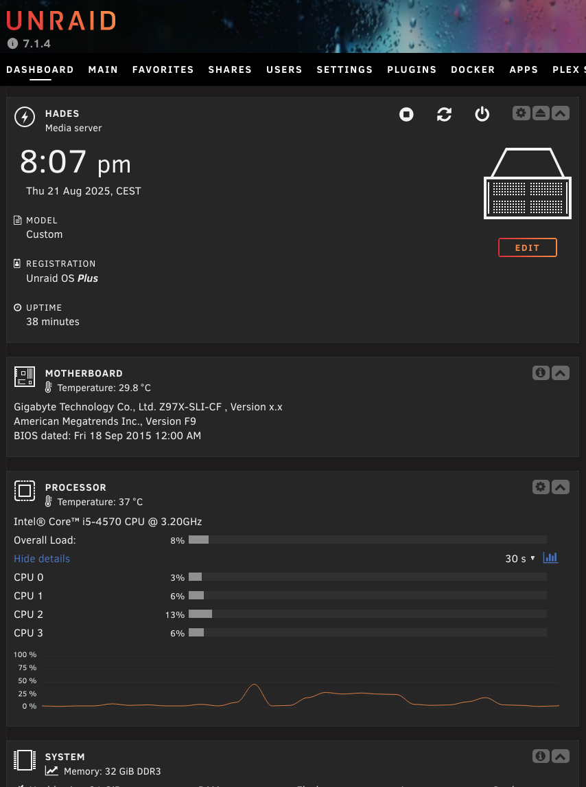

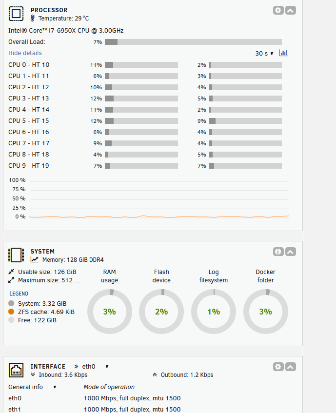

Hi, facing same issue here. the webGUI just went empty after the update. no array or usb stick is showing. but they are there and the array is spooled up and running. no cpu activity, no memory activity. no fan information displaying Capture d’écran 2025-08-21 à 18.57.14.pngCapture d’écran 2025-08-21 à 18.56.37.png
Try booting in safe mode and/or using a different browser; if the same, it may be worth trying 7.2.0-beta.2, it may help with that issue.

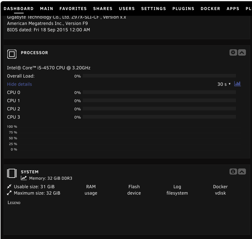

Here is what i did.
=> Reverted the update to 7.1.2 => Not ok. unRaid is on version 7.1.2 but the webGUI is still missing cpu, memory and array.
=> deleted plugin Unraid Connect that was on latest version and triggered again the update to 7.1.2 > 7.1.4
=> after reboot/update and login, the webGUI works as expected. everything is normal.
=> re installed plugin Unraid Connect > everything is still ok and works as expected.
Seems that before you update from 7.1.2 to 7.1.4 you need to remove unraid connect from the plugins and then update.
I have a second server that hosts VMs and a bunch of other things. i plan to do it later this night and will keep you posted on the result.
Thank you to all

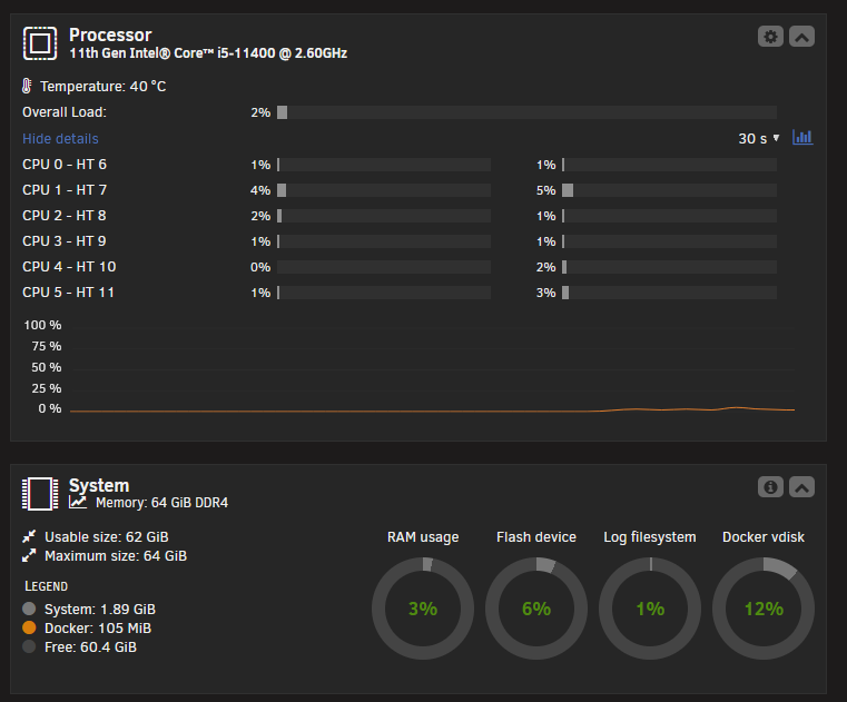

Capture d’écran 2025-08-21 à 20.07.40.pngCapture d’écran 2025-08-21 à 20.07.00.png
I am having this same problem, however, I have never installed the Unraid Connect plugin. I will try installing to beta.
I tried 7.2.0 beta1 and the slowness on the GUI is still affecting my server. The CPU and Memory are perfectly fine. The server runs fine, its only loading things that takes forever. My Plex Docker Server is also having the same issues. Loading Libraries and starting movies or skipping through the movie takes extended time to load, but once loaded it runs fine with no hiccup.

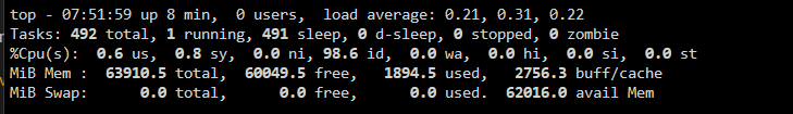

TOP via CLI shows no CPU Wait time as well.
For the Unraid GUI, the issue is like the initial poster's issue. The pages load, but the details on the CPU/Memory, Shares, and the Array Drives take between 30 seconds to 2 minutes to load and sometimes they dont load that information at all.
