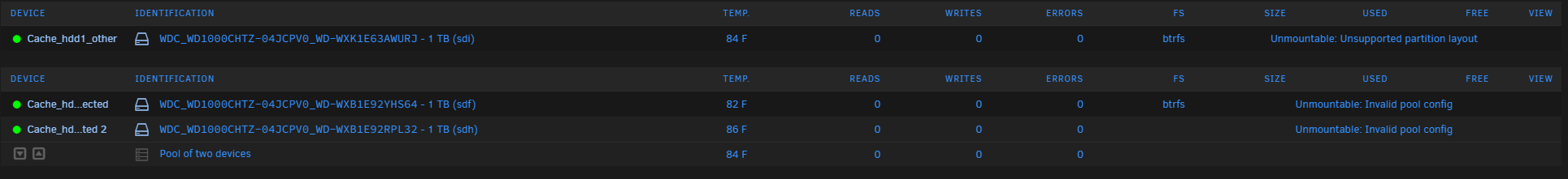

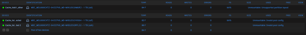

I have a couple of cache drives, 1 is a single cache drive that is "unmountable: unspported partition layout" from my crash the other is a pool of 2 drives that says: unmountable: Invalid pool config. Can I recover the pool somehow with the 2 drives or not sure why I got this error on the 2 drive pool? The single drive I will likely pull and back up for UFS Explorer but thinking the 2 drive pool might be something related to this post but not sure: Other update-I have backed up Disk 3 and will format and move data back using UFS Explorer
