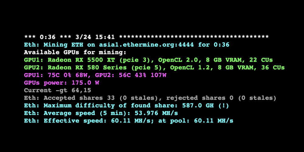

  8. Run it, check the logs constantly for the first 20 mins or so to ensure it is working and your card doesn't overheat. If something looks incorrect, stop the container and double-check your config. I like to try and keep my 5500XT around 75c and my RX 580 around 55c (modded bios).

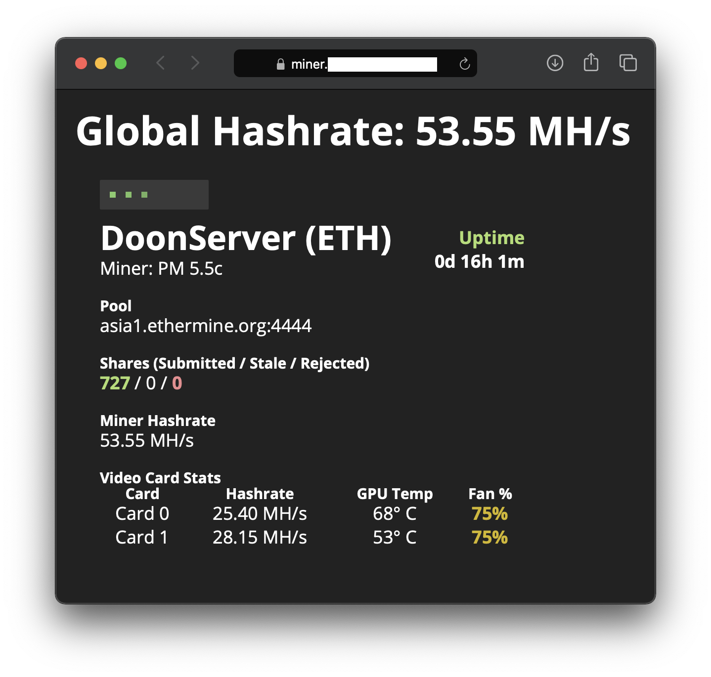

  9. (Optional) If you want to monitor your miner from a web app rather than a representation of the logs, check out PhoenixStats in CA.

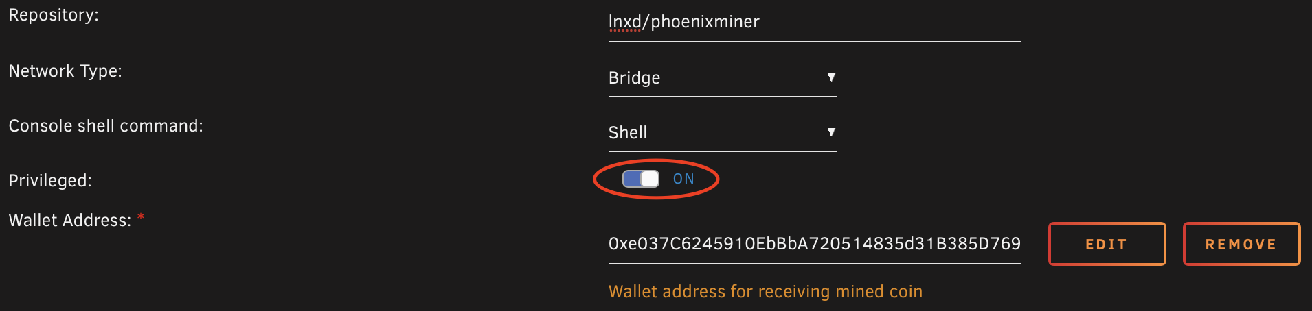

Warning: If you don't leave privileged mode enabled for the container, your GPU's default fan curve will be used, which is usually optimised for gaming. Make sure you have Bergware's Dynamix System Autofan installed to prevent overheating. I recommend enabling it and setting the high temperature to 25c at most. Low I set to 20c. I could not get the PWM min speed, but this didn't affect anything for me during testing.

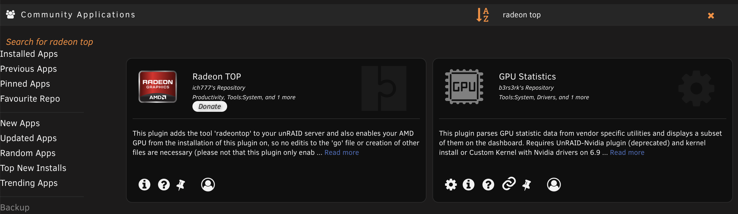

You don't need Radeon Top specifically, but you need to let the Unraid host load the drivers, which is why this relies on 6.9.0 or later. As long as Unraid is up to date on your host, you should be able to see it in there. It looks like the only requirement for the plug-in set by ich777 is 6.9.0. If you're going top-down through the steps, I'm guessing you're already on 6.9.1.
505970678_ScreenShot2021-03-25at5_19_48pm.thumb.png.4c0b13591ddda32dcf25ed8d445b8012.png
I would very strongly recommend installing this plug-in. It might be worth visiting settings from the sidebar in CA and temporarily setting "Hide Incompatible Applications" to No, and doing another search to see if that turns it up. Best to make sure you change it back afterwards.

In your original post you have a image of your two GPU's with their temp and fan %, is that from your PheonixStats app? I have the app installed however it doesnt look anything like that and isnt pulling in the data when I go to webgui. My Webgui is just text with no data.
Edited by SPOautos
Wow that looks beautiful, doesn't it? I'm so proud.
Just kidding.
I just updated the template a few seconds ago to make it more generic, you've left the default settings so it's trying to connect to my server IP which doesn't exist on your local network. You'll need to edit the docker container and add in your own server IP as the Miner Host which appears to be 192.168.1.103, you can also add in a Server Name eg. Unraid
Edited by lnxd
Just kidding.
I just updated the template a few seconds ago to make it more generic. You'll need to edit the docker container and add in your own server IP as the Miner Host which appears to be 192.168.1.103, you can also add in a Server Name eg. Unraid
Sweet, its working now.....so in the mining container settings it says fan control "only works if privileged mode is enabled"......how do I set up privileged mode?   Should I delete my ip from the thread?  Maybe that isnt good to publish
Edited by SPOautos
Perfect!
It's on by default, so you should be fine unless you turned it off.
