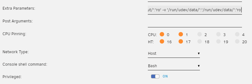

  3. at last!!! In fact the problem lies with Chrome based browsers, I don't know why they can't detect more than one gamepad at a time. The tests I had done with Mozilla had failed because it does not detect any gamepad since Steam-Headless was installed in the docker with flatpak, therefore it does not have access to these devices (xD that's what I understood in my research) To fix this on Mozilla installed with flatpak, you need to run this: "flatpak override --user --filesystem=/run/udev:ro org.mozilla.firefox" Additionally, in docker you must have the following configuration Privileged: ON and Extra Parameters: "--hostname='SteamHeadless' --add-host='SteamHeadless:127.0.0.1' --restart='unless-stopped' --shm-size='2G' --ipc='host' -v '/tmp/.X11-unix/':'/tmp/.X11-unix/':'rw' -v '/tmp/tmp/pulse/':'/tmp/tmp/pulse/':'rw' --ulimit='nofile=1024:524288' --device='/dev/fuse' --device='/dev/uinput' --device-cgroup-rule='c 13:* rmw' --cap-add='NET_ADMIN' --cap-add='SYS_ADMIN' --cap-add='SYS_NICE' --security-opt='seccomp=unconfined' -v '/dev/input/':'/dev/input/':'ro' -v '/run/udev/data/':'/run/udev/data/':'ro'" If these parameters are not added, Mozilla will detect the mouse with an additional gamepad, for my use case this prevents me from being able to play. And that's it, Mozilla will have access to the devices. Both gamepads will work at the same time in the Mozilla browser. In my case, for EmulatorJS it is not recommended to use Mozilla, however I just did a test and I can play... I can play with both gamepads at the same time. Thank you very much for your patience and support (Discord).

  14. It also changed the PCIe ACS override to "Both" and generated this Can you think of any way that when connecting a usb device, it connects to the GPUs? in order to achieve the passthrough
