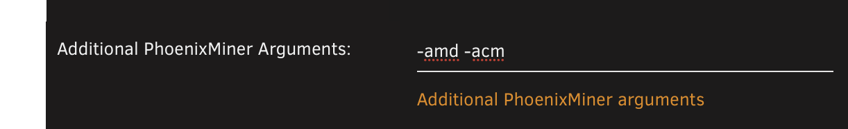

wow @NixonInneshow did you achieve such a good rate.  I have same card and see 2.5MH?
@lnxd in my unraid syslog I am seeing this message many times
kernel: amdgpu 0000:01:00.0: [drm] Cannot find any crtc or sizes
Any ideas to why I get this?
In addition I have activated compute mode for my card using -acm in the docker by adding another docker argument but it doesnt seem to improve the MH rate.  I assume the why I have activated compute mode is correct?
That should work just fine, yup.
Edited by lnxd

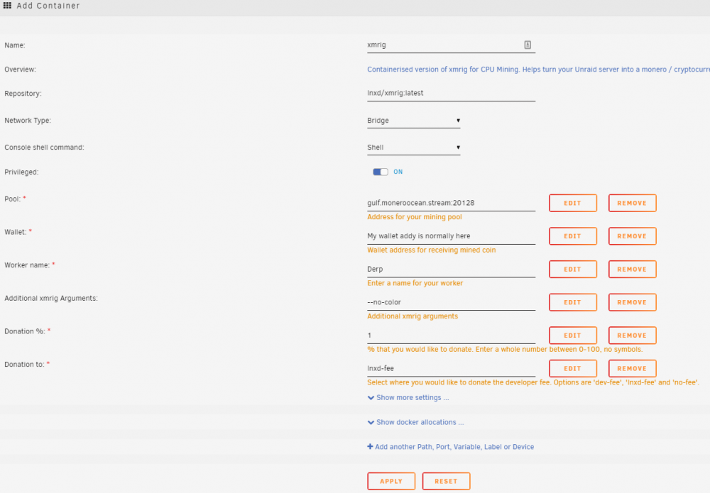

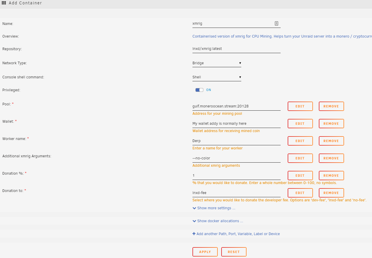

Pressing xmrig support takes me here. Trying it out and I cant seem to get it working.. Do I need to add a port or something?
I think I got it going now.. but im getting [2021-03-31 17:23:56.731] msr FAILED TO APPLY MSR MOD, HASHRATE WILL BE LOW .. Any way to fix this?
Edited by superderpbro
Reasons
😂 Derp is a good worker name.
Ah, I forgot to make the new support post before I fell asleep. Thank you for reminding me!
This is expected at the moment on Unraid unless you use a custom kernel build, I didn’t want to strip MSR from the builds. The impact on hash rate is negligible in my testing so don’t stress.
