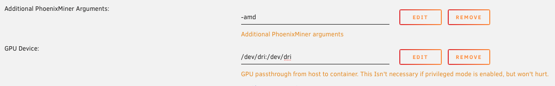

I have a Nvidia GPU with Unraid drivers. How should it be set up?
377407789_Screenshot2021-04-03at01_35_33.thumb.png.853e83ba67e3ccf1a114981f6e971280.png
Like that but take out the -amd 😅 I'll add that into the instructions in OP.

Removing -amd, it only popped in again. I removed the whole line.
The log says it can't find the Nvidia drivers. But the GPU runs fine with Plex, etc.

90811574_Screenshot2021-04-03at12_43_33.thumb.png.235913c3da18a49900a759ac8b0dce12.png
Very interesting, I'm going to see if I can find out more information on your card's compatibility with the built-in drivers and go from there. I'll get back to you in the next day or so. You have a very high end server 😅

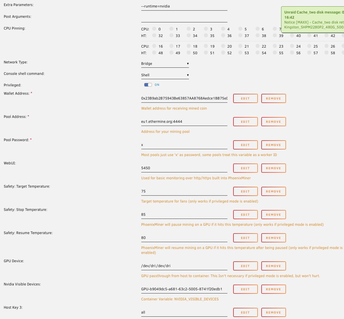

Have you set the Variables 'NVIDIA_VISIBLE_DEVICES' set to your UUID of your GPU, 'NVIDIA_CAPABILITIES' to 'all' and in the Extra Parameters also '--runtime=nvidia' in the Docker template?

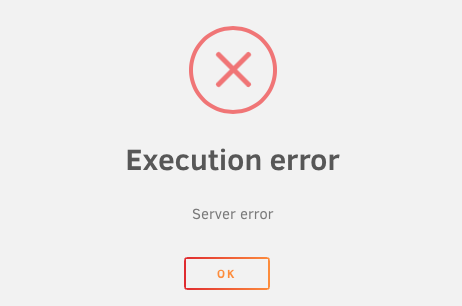

I tried without and with it. Error message with the setup below (and not in the log file):
Also, Server error when removing the line "GPU Device"
764637618_Screenshot2021-04-03at17_01_43.thumb.png.2b45b973017e1bf02b097647f51ff89d.png
Then there is something wrong with the plugin or the nvidia driver itself.
Can you change a setting in the container template itself and post the Error that you get when the docker run command is executed.
Also what is this server error?
Also please remove the /dev/dri entry.

Saving a setting is fine, starting the docker:
Nothing in the log file.
Ah, yes, they have changed that, try to remove the parameter '--runtime=nvidia' and then start up the container.
When it is started click on the container and then add the '--runtime=nvidia' again and it should output what's wrong with it.

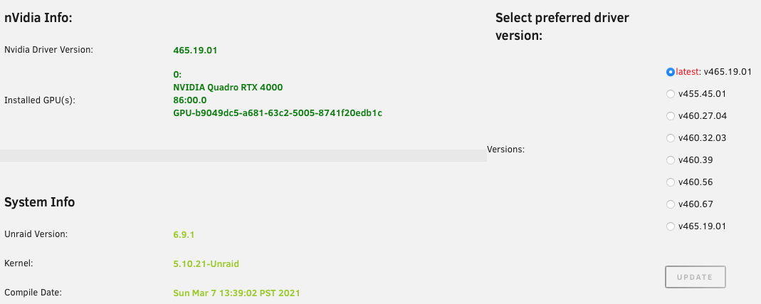

Have you restarted your server after installing the Nvidia Driver Plugin?

Yes, server is restarted many time. But to be sure I tested with a new restart.
Something seems wrong with your Docker service since it can't actually connect to the nvidia runtime.
