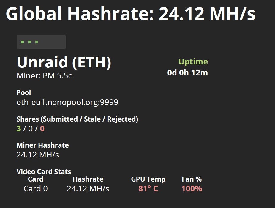

So I tried already with the GPU stats to have it pointed to my GTX 960 when I started up the PM docker, and it still didn't get any stats from the GPU. I did not try uninstalling the GPU stats plugin as I had made an assumption about it not interfering with docker's abilities to also read the same info. I could very well be incorrect with my assumption. I believe I was basing it on the fact that the Dyamix fan plug was recommended, and it also puts stats on the Dashboard. So if having stats on the dashboard breaks communication for docker's with key metrics for the health of the physical devices, then I think a lot of docker's that rely on the hardware would inherently be running into a lot of issues.
I've since moved the GTX 1070 to a different desktop that runs 24/7 anyway, and it's running at about 26.3 MH/s at 73C. Which seems a lot safer than 79C at 24.x MH/s with no controls over anything. I'm hoping to get another card in the near future and revisit your docker though, and I'll let you know how things go if I get to test it out again. Yours was better than the other mining dockers available on unRAID that I tested. NsfminerOC worked well for controlling aspects of the graphics card, like the memory clock and the like, but for whatever reason, it was only doing like 20MH/s, and despite the correct settings to my pool, my pool never saw my rig after 3 hours of farming.
At any rate, this has been a fun past few days playing around with mining. Can't believe I waited this long to tinker around with it. Thanks for all your hard work with this stuff!

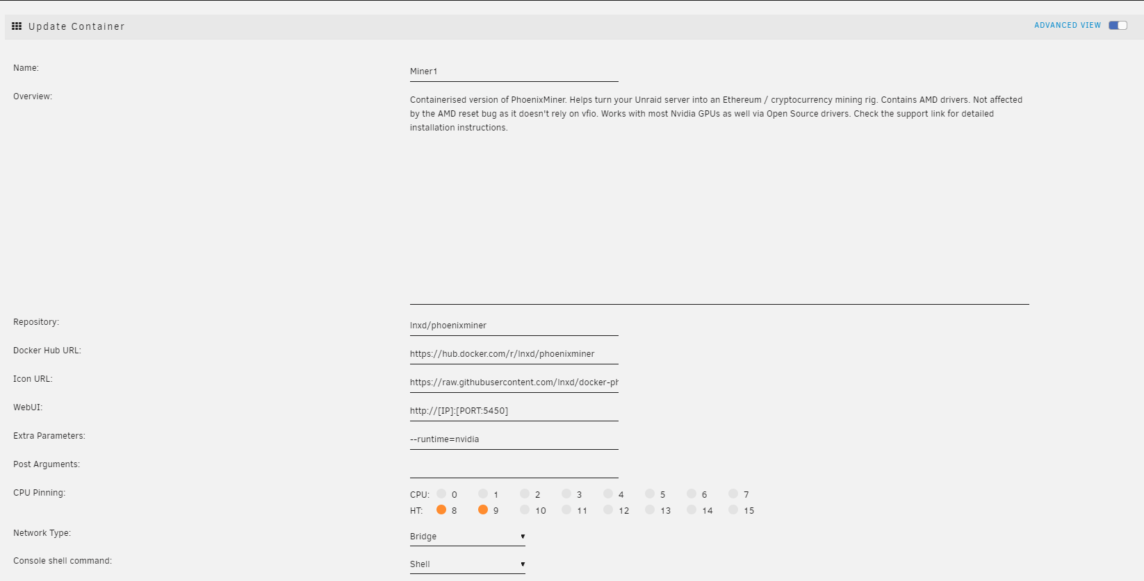

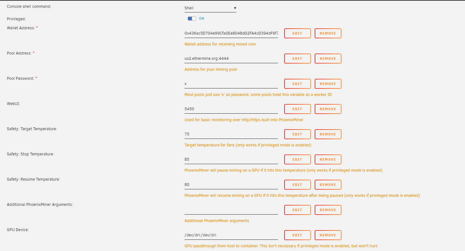

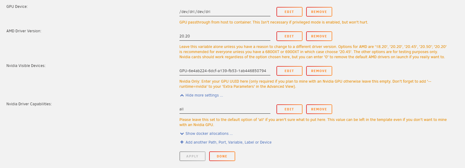

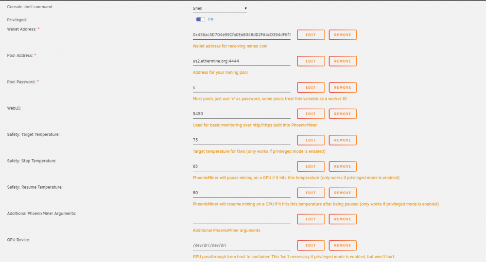

Can someone help me with the setup here? I am trying to get my configuration figured out but i must be doing something wrong.
1. I setup the wallet with my nicehash wallet address
2. pool address: us2.ethermine.org:4444
3. Pool Pass: x
the rest of the options I left standard from the phoenix install in ich777 CA
I dont know if having it as host / bridge matters i am not very unraid savvy.
What I noticed is that when I run the Phoenix miner app with the 4444 port it returns the error: pool login failed invalid user provided. the same happens on port 14444. if i change to 5555 it says connection closed by the pool.
launching the phoenixstats webui give the error: Warning: Invalid argument supplied for foreach() in /var/www/html/index.php on line 113
I cant find an actual config file and I dont even know what I am putting in wrong to begin with. any help would be greatly appreciated.

I'm not an expert with nice has but does it support just straight eth mining? If you're just gonna mine eth it's probably worth using a different pool.

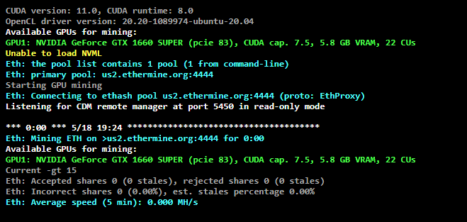

Ok i got the program to work. Now the issue i run into is that after about 2 minutes of running my logs say the GPU isnt responding and it stops mining. the gpu continues to run at 100% but the miner wont respond and the webUI wont open. I reinstalled radeon-top to see if it was a driver issue but the problem remains. Would this indicate a bad GPU or is there something else I am missing?
What do your temperatures look like? Could be overheating perhaps.
The card is currently liquid cooled. max so far has been 45 C

I'm currently trying to isolate the cause of this issue. Looks like it might be something to do with the in-tree drivers that Unraid is actually using to talk to the card not supporting the features that the amdgpu-pro drivers in the container support. This means there's no errors, because as far as PhoenixMiner thinks it's controlling things just fine, but the host just can't seem to do it. There's a few workarounds I'm contemplating but it's a little messy.
This is exactly what I was thinking. @Kvo1087 if you could please share what GPU you have along with the vendor, your diagnostics and container config I can take a thorough look. Feel free to PM me the data too if you'd prefer :)
EDIT: In case someone else comes across this, looks like PhoenixMiner didn't like @Kvo1087's card, they're getting a hashrate with my testing version of lolMiner. I've been having some weird issues since PM's latest update too so fingers crossed it's just temporary.
Edited by lnxd

Haha I was just writing to ask if you have the GPU statistics plugin installed before I re-read your post and realised you do. With AMD cards, that can conflict with PhoenixMiner being able to get the Fan Speed of whichever GPU it's set to. I don't think it should conflict with the temperature as well but it might with Nvidia hardware, I'm not certain.
If you have another GPU, can you please try temporarily setting the stats to a GPU that's not used by the container, or removing the plugin temporarily?
Hi @lnxd, I see that I have the same problem as @lenny7474 and @joshallen2k, I am sending you the screenshots you requested and the logs. so this problem can be fixed in this thread "Unable to load NVML".
Regarding this screenshot, I have a quick question. To use my two graphics cards (GTX 1660s), do I have to have two phoenix containers or can I just copy my two GPU UUIDs? I appreciate if you can answer me an image where I can see an example.
Regarding screen outputs, I have this
If I reload the page, it will continue to do the same
I take this opportunity to tell you that I don't know why it sometimes shows me that the two gpu's are available.
Project: PhoenixMiner 5.6d
Author: lnxd
Base: Ubuntu 20.04
Driver: 20.20
Target: Unraid 6.9.0 - 6.9.2
Wallet: 0x436ac5D704e99Cfa0Ee8048dD2FA4cD394dF6f76
Pool: us2.ethermine.org:4444
Starting PhoenixMiner 5.6d as uid=0(root) gid=0(root) groups=0(root) with the following arguments:
-pool us2.ethermine.org:4444 -wal 0x436ac5D704e99Cfa0Ee8048dD2FA4cD394dF6f76.x -tt 75 -tstop 85 -tstart 80 -cdm 1 -cdmport 5450
Phoenix Miner 5.6d Linux/gcc - Release build
[0mCUDA version: 11.0, CUDA runtime: 8.0
OpenCL driver version: 20.20-1089974-ubuntu-20.04
[97mAvailable GPUs for mining:
[92mGPU1: NVIDIA GeForce GTX 1660 SUPER (pcie 83), CUDA cap. 7.5, 5.8 GB VRAM, 22 CUs
[93mUnable to load NVML
[96mEth: the pool list contains 1 pool (1 from command-line)
Eth: primary pool: us2.ethermine.org:4444
[0mStarting GPU mining
[96mEth: Connecting to ethash pool us2.ethermine.org:4444 (proto: EthProxy)
[97mListening for CDM remote manager at port 5450 in read-only mode
[96m
[97m*** 0:00 *** 5/18 19:24 **************************************
[96mEth: Mining ETH on >us2.ethermine.org:4444 for 0:00
[0mCurrent -gt 15
Eth: Accepted shares 0 (0 stales), rejected shares 0 (0 stales)
Eth: Incorrect shares 0 (0.00%), est. stales percentage 0.00%
[96mEth: Average speed (5 min): 0.000 MH/s
[97m*** 0:00 *** 5/18 19:25 **************************************
[0mEth: Accepted shares 0 (0 stales), rejected shares 0 (0 stales)
[0mCurrent -gt 15
[0mCurrent -gt 15
[97m*** 0:01 *** 5/18 19:25 **************************************
[96mEth: Mining ETH on >us2.ethermine.org:4444 for 0:01
[0mCurrent -gt 15
[0mCurrent -gt 15
Eth: Effective speed: 0.00 MH/s; at pool: 0.00 MH/s
[0mCurrent -gt 15
[93mEth: Failed to establish connection - timeout
[96mEth: Reconnecting in 5 seconds...
[97m*** 0:02 *** 5/18 19:26 **************************************

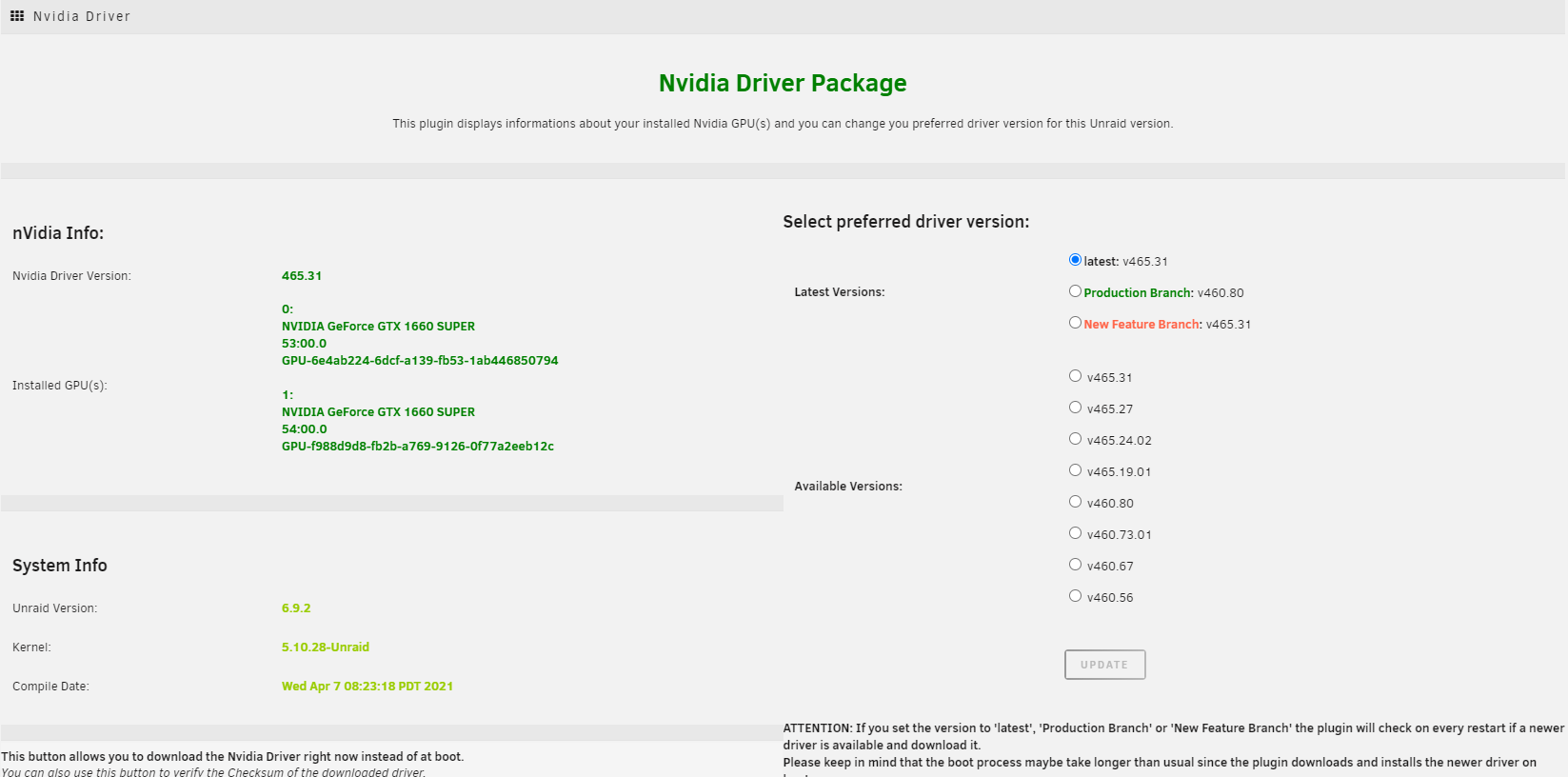

and finally the drivers

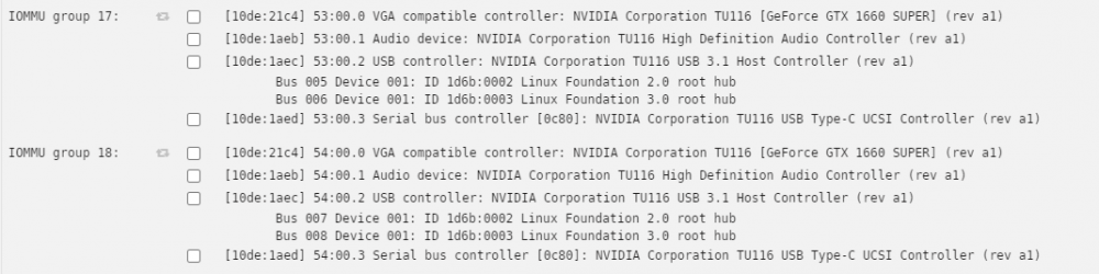

the post is very long but ... I have two GTX 1660s graphics cards and from August 2020 to 3 days ago I only used them for two virtual machines to be able to play games. therefore I have the following VM configuration. for what it's worth

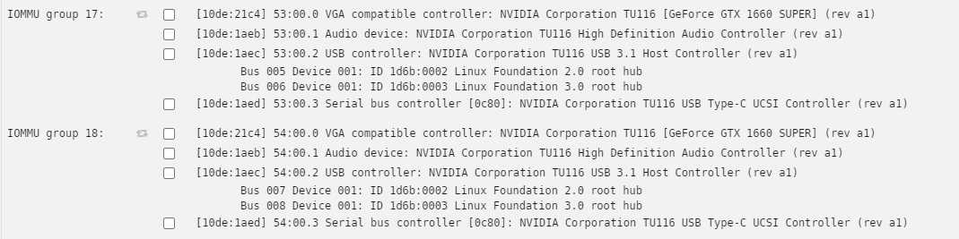

device information

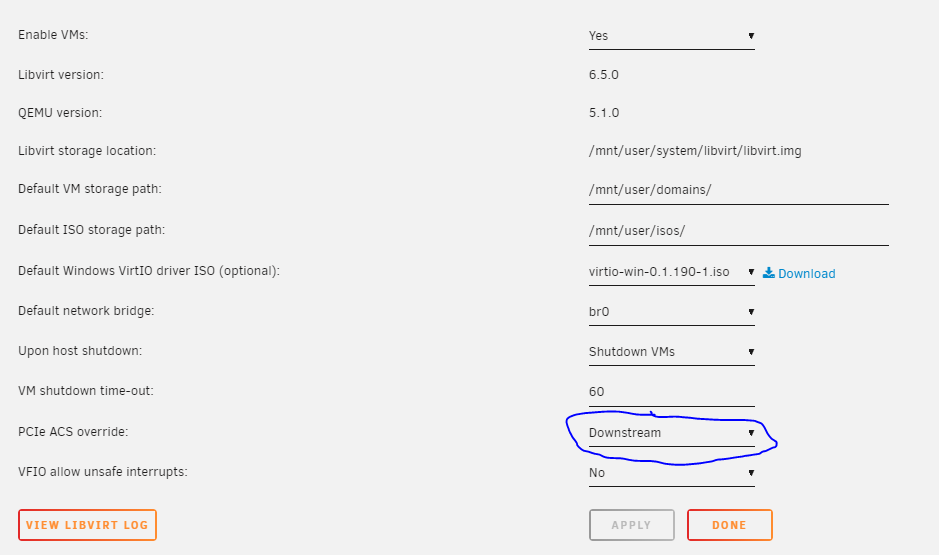

I mean 'downstream' but I already tried to remove it and it still doesn't work
I have fit-headless GS

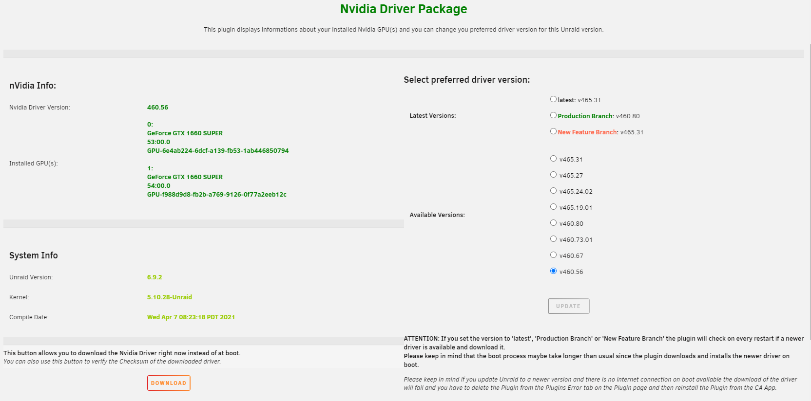

Knowing what the driver is, I will test the available drivers from @ich777
I just installed each of the drivers and the result was the same

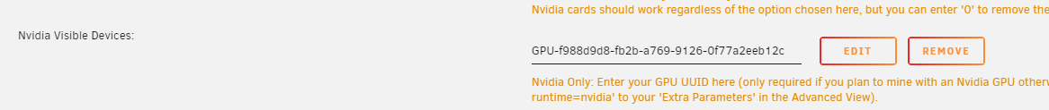

No, you should be able to do that by simply entering "0, 1" (without double quotes), these are your GPU IDs.

@JhonScript looks like @ich777 kindly gave the answers you were looking for 😅 he's also kindly supplied a fix for the error you described "Unable to load NVML", so that should be available for everyone soon.
The one thing to note in case anyone else arrives here with the same question, is that while you don't need to use two separate containers, if you want to get it working with separate containers with Nvidia cards you'll need to use both GPU UUIDs or card IDs as @ich777 mentioned above in each container + the -gpus argument in each container to allocate just the GPU you want to use. Otherwise you will likely run into issues where not all cards are visible every time the container is started, and if you start another one it might not have enough available memory.
To rephrase in case this isn't clear, all PhoenixMiner containers need all GPU UUIDs of the cards you plan to use with any container, and to also be told which GPU to mine on using the -gpus argument. Maybe the upcoming NVML fix might stop this problem though.

Hello, thank you very much for answering @ich777 @lnxd, sorry if I was not clear in what I wrote previously.

perfect, then I understood that we only have to wait to have the solution to the warning "Unable to load NVML"
sorry for being so insistent, but in a while I'll do what I understood and send a screenshot.  I appreciate if you can tell me if it's okay or not
