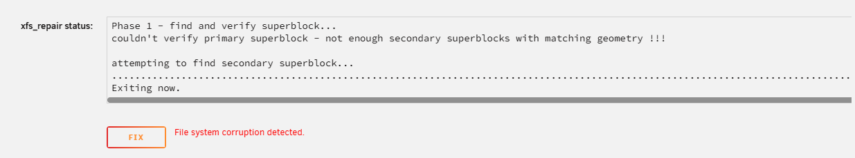

  6. tried to fix it twice but this was the result both times. what should i do?
  7. it ran one check and then had a fix button. it is currently going through that process and then I will check in again if it doesn't work. Sorry for the delay. Each one seems to take about 24 hours

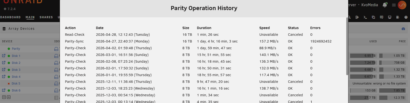

  9. I was updating my parity drive to a larger size. when it finished the parity check my disc 5 started to have issues and says unmountable. since the check on 4-27 says the status is ok and I want to change all my drive to a larger size I am wondering if I can just replace the disc 5 with a new larger drive and be able to rebuilt it with the parity? I am assuming the answer is no with the huge number of errors but not sure why it would show the status as OK if the parity was not intact

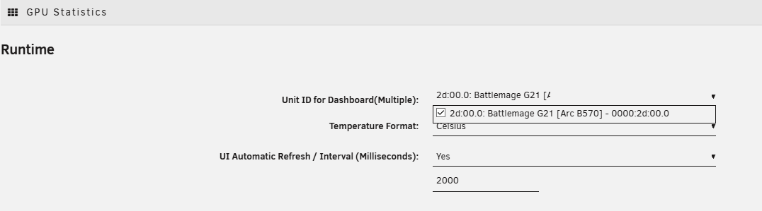

  10. I recently watched the video by spaceinvaderone about changing plex files from x264 to 265. I purchased an Intel B570 to use with Tdarr . I installed the GPU stats plugin and the Intel TOP plugin and then installed the GPU into the machine. for some reason it puts me into a boot loop for a while with an error about my sata controller card unless I plug and unplug an hdmi into the video card. I am not sure if this is the heart of my issue but I think it might be. When I do get unraid to launch it doesnt seem to recognize the GPU correctly. But it at least sees the card and knows what it is: I have been trying this fix that is suggested to be the most common but I cannot find the intel_top_command_timeout in the settings page for GPU stats If anyone can talk to me like I am 5 years old and tell me what I am doing wrong I would really appreciate it.
