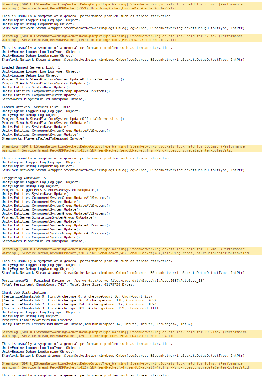

  18. V Rising Lag - Error when playing with friend? SteamLog [SDR k_ESteamNetworkingSocketsDebugOutputType_Warning] SteamNetworkingSockets lock held for 190.1ms. (Performance warning.) ServiceThread,RecvUDPPacket(x29),ThinkPingProbes,EnsureDataCenterRoutesValid This is usually a symptom of a general performance problem such as thread starvation. UnityEngine.Logger:Log(LogType, Object) UnityEngine.Debug:LogWarning(Object) Stunlock.Network.Steam.Wrapper.SteamSocketNetworkingLogs:OnLog(LogSource, ESteamNetworkingSocketsDebugOutputType, IntPtr) SteamLog [SDR k_ESteamNetworkingSocketsDebugOutputType_Warning] SteamNetworkingSockets lock held for 9.9ms. (Performance warning.) ServiceThread,RecvUDPPacket(x412),SNP_SendPacket(x4),SendUDPacket(x4),ThinkPingProbes,EnsureDataCenterRoutesValid This is usually a symptom of a general performance problem such as thread starvation. Never got this error playing solo on my server but it started popping up constantly when my friend joined. we get lag frequently. I have a ryzen 3900x and 64gb of ran. the appsdata is on my nvme cache drive. The only other docker running on my server is plex so I am not sure what would be causing the thread starvation. Any help is greatly appreciated!

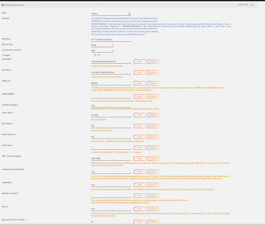

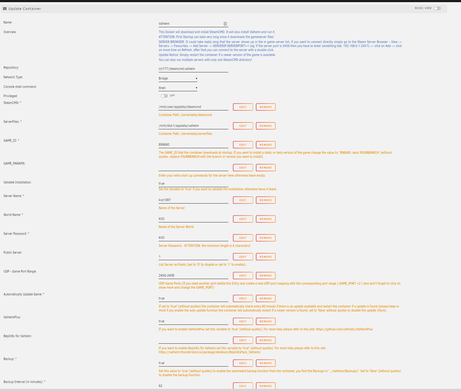

  22. I tried adding the server to favorites and looking for games at this address but it says the server is not responding. this is my setup in the edit logs, is this the template you were referring to? In the past when I had a hard time finding the server for Valheim or Lost Ark I could see it under local servers. I am really at a loss about this one.
  23. Looking for some help on Valheim server. I had this running Valheim Plus on my unraid server about a year ago and wanted to get it started again. I ended up purging the install from my personal machine and my server to try starting from scratch cause something was broken. I got it installed on the server again but I cannot see the server in local servers on steam and can't figure out if it is failing somewhere or just not launching at all. Ports are all forwarded and both the server and personal machine im trying to connect with have Valheim plus installed and are on the same network. Any help would be greatly appreciated. I will attach the Log output: ---Ensuring UID: 99 matches user--- ---Ensuring GID: 100 matches user--- ---Setting umask to 000--- ---Checking for optional scripts--- ---No optional script found, continuing--- ---Taking ownership of data...--- ---Starting...--- ---Update SteamCMD--- Redirecting stderr to '/serverdata/serverfiles/Steam/logs/stderr.txt' [ 0%] Checking for available updates... [----] Verifying installation... Steam Console Client (c) Valve Corporation - version 1648077083 -- type 'quit' to exit -- Loading Steam API...OK Connecting anonymously to Steam Public...OK Waiting for client config...OK Waiting for user info...OK ---Update Server--- ---Validating installation--- Redirecting stderr to '/serverdata/serverfiles/Steam/logs/stderr.txt' [ 0%] Checking for available updates... [----] Verifying installation... Steam Console Client (c) Valve Corporation - version 1648077083 -- type 'quit' to exit -- Loading Steam API...OK Connecting anonymously to Steam Public...OK Waiting for client config...OK Waiting for user info...OK Update state (0x3) reconfiguring, progress: 0.00 (0 / 0) Update state (0x5) verifying install, progress: 19.01 (227121459 / 1194900573) Update state (0x5) verifying install, progress: 61.67 (736842548 / 1194900573) Update state (0x5) verifying install, progress: 98.92 (1182053481 / 1194900573) Success! App '896660' fully installed. ---Prepare Server--- ---ValheimPlus enabled!--- ---ValheimPlus Version Check--- ---ValheimPlus v0.9.9.8 up-to-date--- ---Server ready--- ---Starting Backup daemon--- ---Start Server--- ---with Valheim Plus--- ---Update Check for Valheim enabled, running automatically every 60 minutes.---
