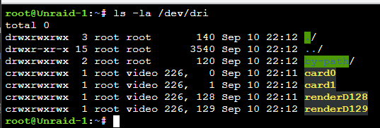

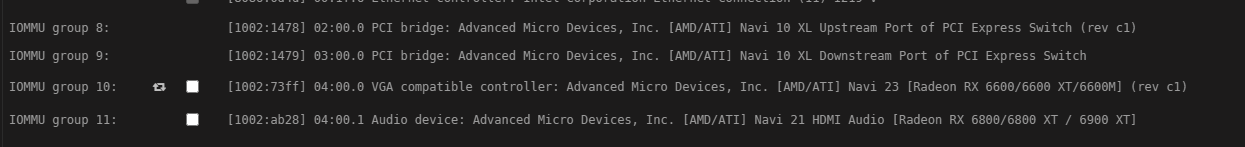

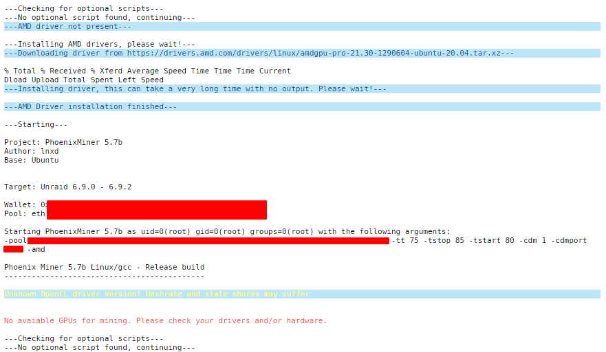

i got a new 6600 xt and tried it, with your container, but i can't get it work.
one of them is my igpu
Driver:21.30
Even with the newer Version/Driver, it won't work.

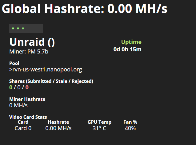

So I can see that I'm actively mining in nanopool, but I'm not getting any statistics.
@eagle470, based on the pool address, you are trying to mine ravencoin? My understanding is that Phoenixminer only mines for ethereum.
I have both 6800 and 6600xt installed in the system. The container only mines with 6800. How can I tell the container to use the 6600xt as well?
Back on the 14th of Sept with @sonic6's help I was able to confirm that version 5.7b and earlier of the PhoenixMiner binary weren't compatible with this card. I've since updated it to 5.9d now that it's available and it may (probably) work now, I haven't got a 6600xt available to test it with.

21.40.1 doesnt work for me:
---AMD driver not present---
---Installing AMD drivers, please wait!---
---Downloading driver from https://repo.radeon.com/amdgpu-install/21.40.1/ubuntu/focal/amdgpu-install_21.40.1.40501-1_all.deb---
% Total % Received % Xferd Average Speed Time Time Time Current
Dload Upload Total Spent Left Speed
---Installing driver, this can take a very long time with no output. Please wait!---
---AMD Driver installation finished---
and thats it...
i suspect the install is failing because it goes from "installing" to "finished" in about 10 seconds/
