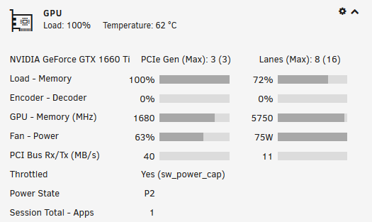

I haven't needed to do anything special with my 1660Ti, t-rex doesn't seem to utilize all the memory. Otherwise, if that's not the case for you, I'm not sure the best way to limit it. Perhaps you setup a User Script to only run it at night?
On 2/5/2021 at 9:25 PM, hk21x said:
Hey! I'm mining using a GTX 1050 Ti however the hash rate is incredibly low, is there a way to check it's utilising it to the full capacity, rather than nvidia-smi - as this isn't showing anything specific to T-Rex?
You might try the GPU Statistics plugin but I'm pretty sure that just uses nvidia-smi
