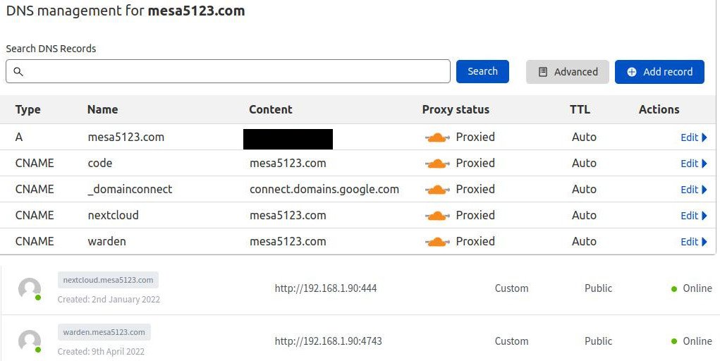

I am back again to ask for help with a problem that I never figured out (probably due to my understanding) of Cloudflare and NPM.
I created a Cloudflare account and NPM in unraid.
I got my Nextcloud up and running thanks to the great tutorials online.
But my problem still lies if I try to add more than one proxy in NPM.
If I add Vaultwarden and click on it it opens up Nextcloud and not Vaultwarden.
I am attaching a picture of what I have setup. I tried to follow the suggestions that everyone provided about 5 months ago but failed. I need to see if I can get this figured out for at least my own learning experience.
Please let me know what other information may be needed.
What happens if you open 192.168.1.90:4743 through your browser?
It goes to http://192.168.1.90:4743 and does open.
And your router forwards the traffic to NPM? If you see Nextcloud through the warden domain, it seems you're router is forwarding the traffic to Nextcloud.
What happens if you open your public IP? You should see the NPM proxy welcome page.
I am lost at the folloing statement you made
"What happens if you open your public IP? You should see the NPM proxy welcome page."
Can you please explain how I would do this.
Thank you.
