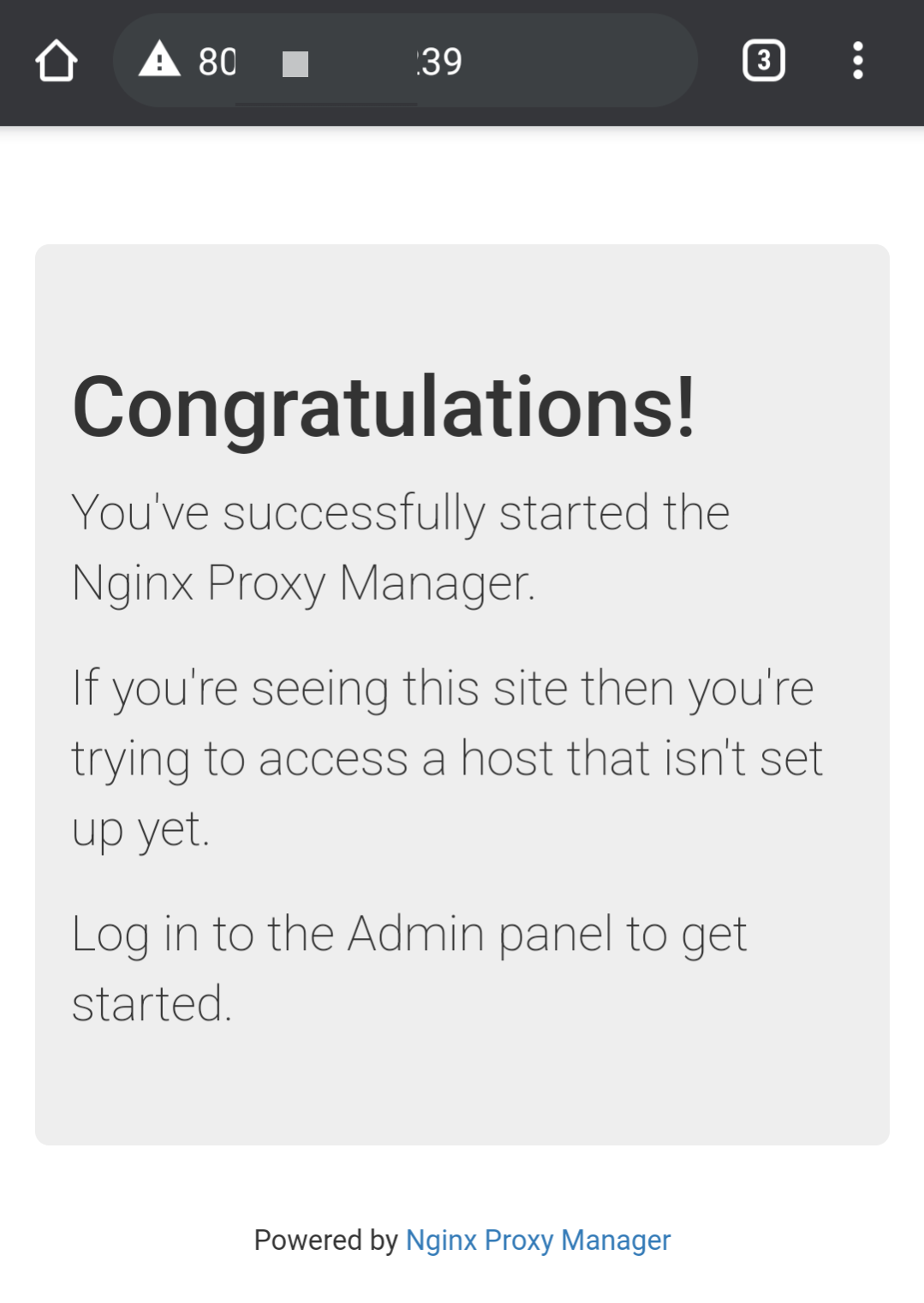

I tried the http://xxx.xx.xxx.232 (http://<publicIP> ) and it says This site can’t be reached.
This is what you should see:
If this does not work:
A) Your router blocks Port 80
B) You don't have a public IPv4 (instead it's a proxified IP of your provider)
C) The traffic of Port 80 does not reach any target
Check your router settings and verify if your are really having a public IPv4 (through your router, too).

This is correct. My screenshot shows only the mobile chrome browser.
EDIT: ah one moment. Maybe you're router does not support hairpinning. Please test the IP from outside of your local network (cell phone mobile data).
I tested the IP from outside of my local network using my cell phones mobile data and got the same message that it could not connect.
And which ports did you open in your router and what are the targets of the forwarding?
