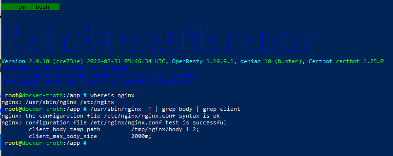

Hey everyone, I'm trying to upload videos from my iPhone via photosync using this docker and I'm getting an error 413-request too large. I've searched and attempted to add in some of the custom config given in the advanced tab on npm, but non seem to work. Any help would be appreciated, thanks!
Maybe the problem is the target container and not NPM?
How would i know? What can i check? I'm a noob at this. It's going to photoprism container.
Same request, no answer:
https://github.com/photoprism/photoprism/issues/2187
NPM shouldn't be the problem because the default setting for file uploads is 2000MB / 2GB:
Does the photoprism container have an unraid support thread? Then ask there or ask at the github project of photoprism. Would be nice if you can post the solution here after you find it.

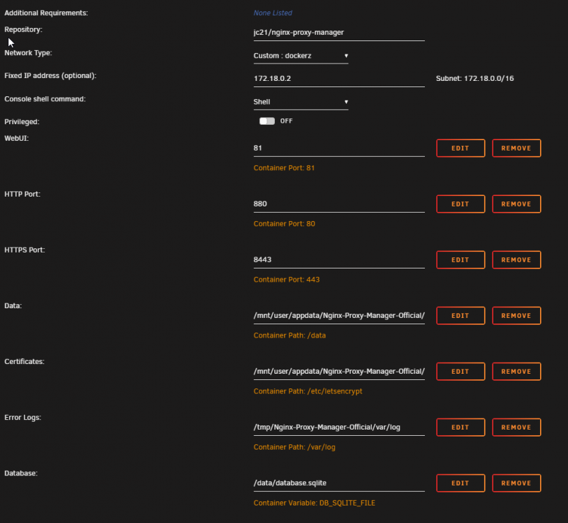

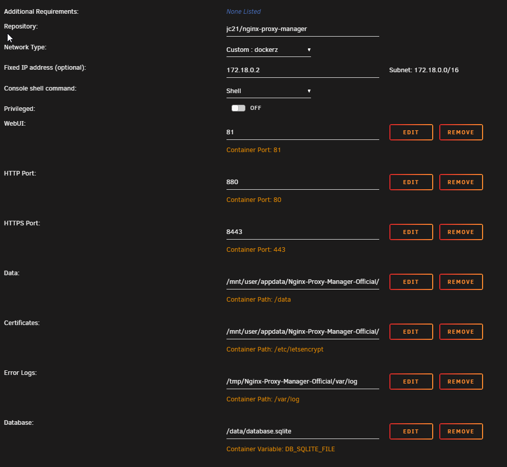

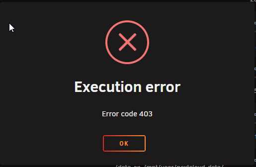

Running into a 403 trying to start the container. There is zero content in the log window. I've done a force update on the container. Still no dice.
Any thoughts?
8 hours ago, aglyons said:
Running into a 403
I don't think this is related to the container. Seems to be something else:
I figured it out. I had assigned an IP on the dockerz network. Another container on the same network was started prior to NPM starting and it was assigned the same IP address. Once I cleared the assigned IP NPM started ok.
I made the assumption that defining an IP on a container would reserve the IP from the Docker DHCP. But the Docker network is not like a router. There is no IP reservation. At least defining it in a container is not going to reserve it lol.
Custom networks have integrated DHCP and DNS servers. So the best solution would be to leave the IP field blank and use the Container name as long both containers are in the same network.
