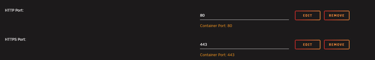

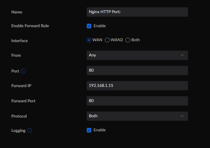

That did not work.  Having said that, I'm still confused.  I double checked all my port forwarding stuff, and everything looks correct.
I don't understand why/how it would be different on a Ubiquiti UDM Pro vs a Netgear router.

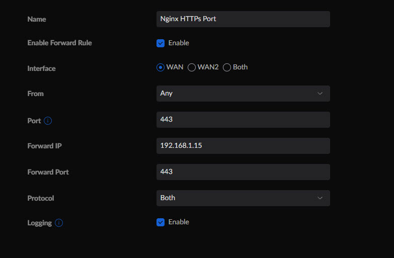

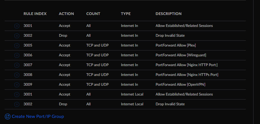

Here are the Port forward rules I have setup in my system.  I even checked under firewall rules, and it looks ok.
8 minutes ago, coltonc18 said:
This time you need to enter "http://[8888:7777:6666:5555]" (the square brackets are important and again do not use "https://"!).
This explanation is for IPv6. Does your DDNS domain have an IPv6 record / are you really using IPv6?! Most people use only IPv4.

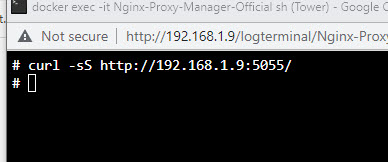

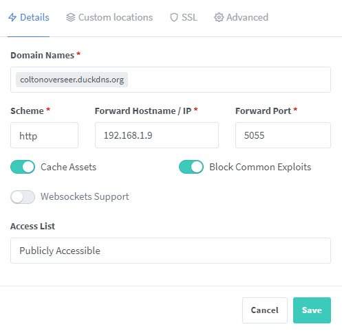

My issue appears to be at the curl, when I go to test the curl nothing happens.  I can open overseer and it does work at this IP, so I know that is not the issue, reading down below that I wasn't sure what action to take next.
I tried to change the Bridge network on Overseer to Custom Br0 to match this, but then Overseer wouldn't work, and I tried to do the same on binhex-nginx, and while that one allowed the change I still couldn't access the page attached to it.
When I tried to change the network on nginx to bridge it just didn't work.  The strange thing is all of these worked as they are right now, the only thing I changed was my router this weekend, and I have been working on getting everything set back up since then.
Looks good to me. The response is possibly empty because it redirects. Use -LsS as curl options and curl follows the redirect and you will see the html content if the page.
If this works, than NPM reaches the target container.

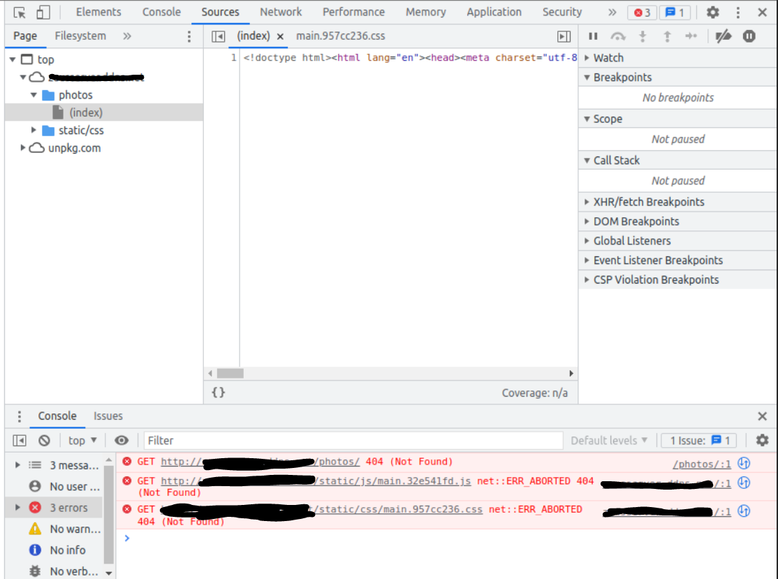

Hopefully this is the info need and have also current config from NPM
Check the network monitor, not sources. And don't forget to reload the page. The network monitor must be open for the complete loading process.
Apologies, hopefully right this time.

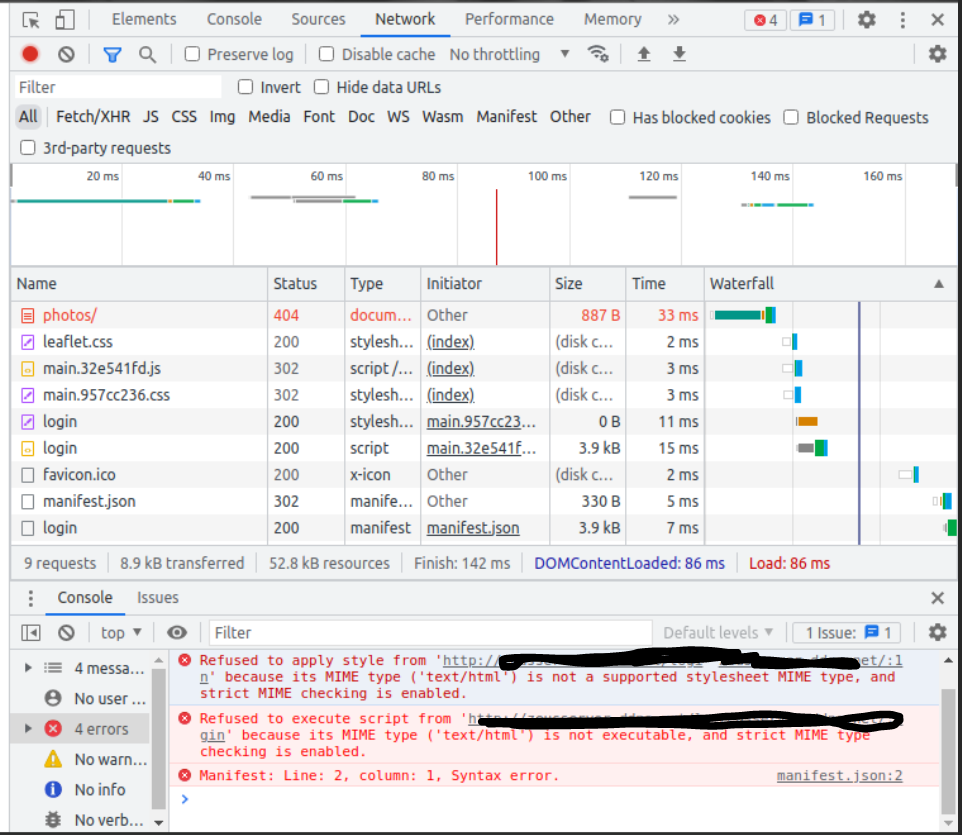

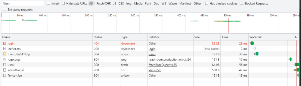

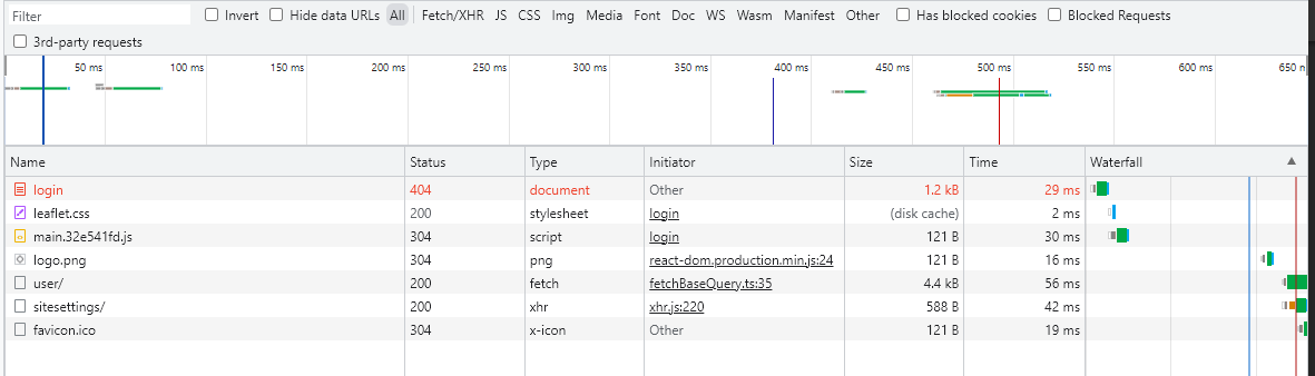

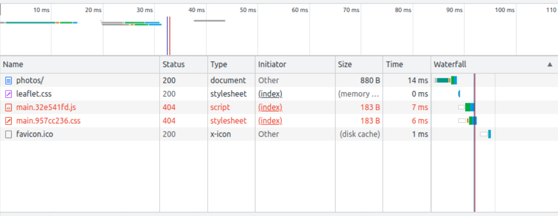

1st image is trying to run via custom location and 2nd is normal loading directly with target ip
44 minutes ago, Rutj87 said:
1st image
As you can see. It can't load the JS and CSS file. You can click on the entry and it will show you the path. It think it tries to find the JS file in the root directory if the domain and as you are in the subdir, this path does not exist.
Now you need to find out if this container / software allows to set the "base url" from / to /subdir. So this has nothing which can be solved through NPM.
@mgutt - it seems its now reading from base url correctly but giving style error. Is this something with the config of NPM and the mime types enabled?
