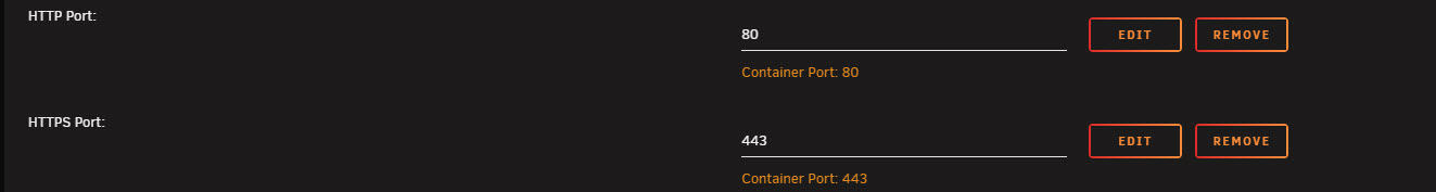

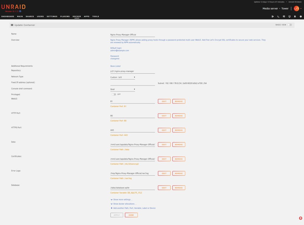

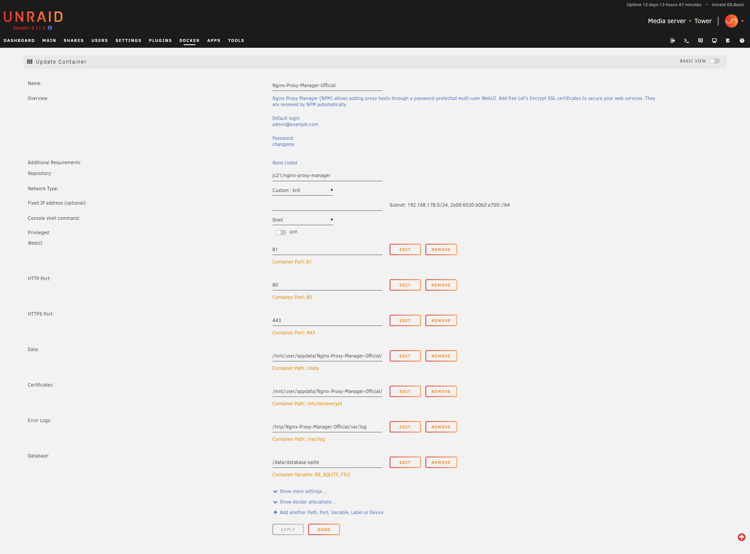

1 hour ago, PlanetDyna said:
Installing your docker but WebUI is not working:
The logs do don't contain any errors. Which network did you use and which ports are set?

As you can see it used the IPv6 address 2a00... and it seems that this IPv6 address does not target your NPM container. Try to open http://[2a00:1450.....]/ through your browser. It must return the NPM welcome page.
I'm sorry I purchased unRAID to host a cloud for my family and I'm not totally familiar with what you're saying. I'm not in IT. I appreciate you replying but if you could point me towards correcting this I'd appreciate it! Thanks!! I don't want to rely on duckdns alone.
When I type that 2a00:1450:400e:80f::2013 in my browser it just launces a google search and tells me it's an address in the Netherlands
You must write http://[] and then put the IPv6 between the brackets (they are important).
Then I suggest to disable IPv6 in your router and use only IPv4. This is much easier.
After that try to open http://1.2.3.4 while replacing 1.2.3.4 against your public IPv4 (yes, this time without brackets). If you don't see loading NPM, then you probably don't have a public IPv4. Then ask your provider if this is changeable. If not: Give up. No joke. Providing a server behind a proxified IPv4 is only possible by renting an VPS server, setting up a tunnel through IPv6 and so on... This is the most complicated setup.
If you have a public IPv4 and you still want IPv6, then:
- NPM must use the host network
- NPM must use port 443 and port 80 (which means you forward port 80 to 80 and 443 to 443 in your router)
- the Unraid GUI must be changed to different ports like 5000 and 5001
- your DDNS domain needs an AAAA DNS record with the IPv6 of your NPM container
- if you are using a DDNS container to update the DNS records, it must support IPv6 and run in host network, too
The address in brackets didn't load a page. "This site can't be reached" "ERR_ADDRESS_UNREACHABLE"
IPv6 is toggled off on my router. It's been the same for 3 years. It worked fine and Duckdns still gets me to nextcloud so something is working. I'm definitely not going to give up. No port forwarding rules have changed. I don't want IPv6. My public IP takes me to the same generic NPM Congratulations page as every time I type in my subdomains from google domains. Something is getting through.  I don't know how it started. I'll continue to look for a solution.  Thanks.
Edited by DuneJeeper
ipv6 clarification
. I don't want IPv6
Then login into your dns settings of your domain and delete the AAAA entry.

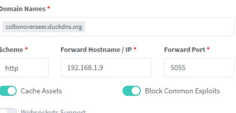

Hello,
I recently switched from a netgear router, to UDM Pro, and its screwed up my Proxy setup and I can't figure out how.  One of the connections it screwed up is to Overseer.
I just watched another video on it, and everything looks correct, I've attached the relevent pics.  If someone could look at it I would appreciate it.
When I try to click on my site, it tells me the site is not safe, so I click to view it anyways then I get this.
This site can’t be reached
coltonoverseer.duckdns.org took too long to respond.
Try:
Checking the connection
Checking the proxy and the firewall
Running Windows Network Diagnostics
ERR_CONNECTION_TIMED_OUT
