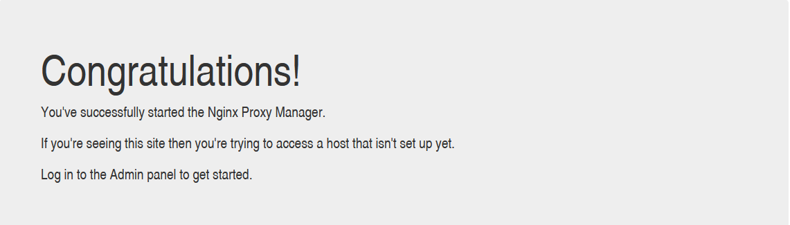

hi guys and girls
When i try to make an ssl it won't work
and when i try to make subdomains like on the pictures. it alle leads back to unraid only.
what am i doing wrong.
Did you open Port 80 on your router and point it to NPM?
Yes I open the port. Tried every time to make an ssl and all subdomains keeps pointing to unraid even though I point them to other apps

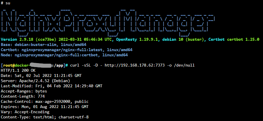

If it's correct. Please verify that you not able to reach the domain from inside and outside your local network (like a mobile phone).
11 minutes ago, mgutt said:
Check which public ipv4 your internet connection has and compare it with the IP which is provided through this domain.
The public IPv4 is the same as the current ip in DuckDNS.
From the cell phone via the mobile internet it does not work either. In Safari, it comes, “Safari could not open the site because the server stopped responding.” And in Firefox over mobile data, “The request timed out. NSURLErrorDomain”.
3 minutes ago, mgutt said:

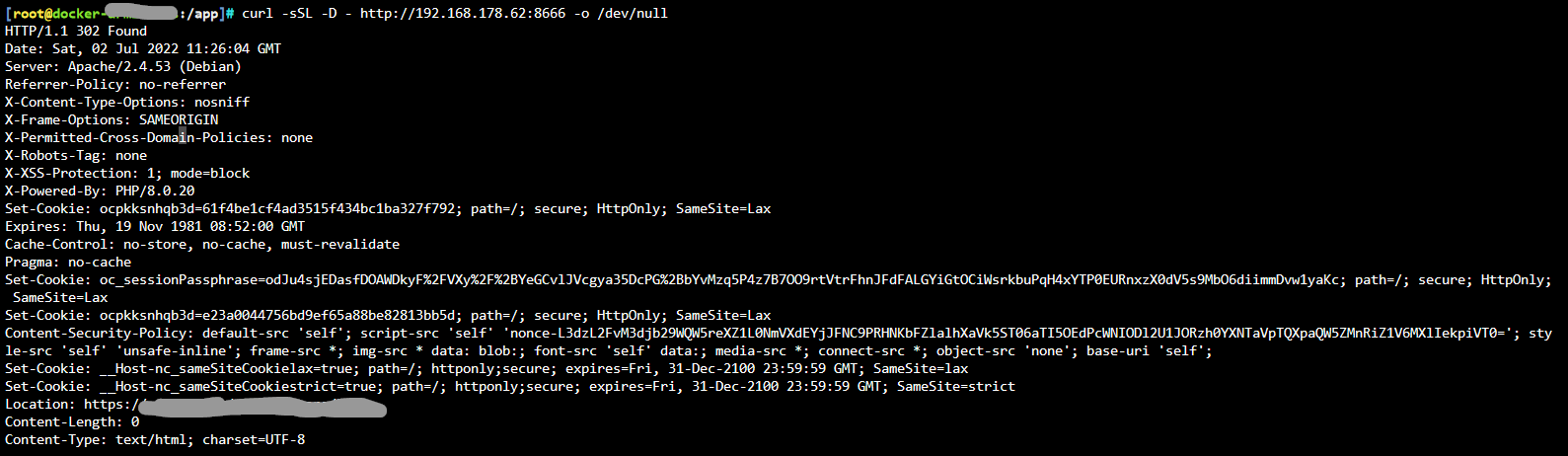

Are you able to load NPM through the public IPv4 as mentioned in the second step?
Yes, that is possible.
Something seems to be wrong with Nextcloud:
Edit: But both of them are not reachable via the URL stored in Nginx Proxy Manager.
Edited by 4n0nyM
addition
Looks good. 302 only means there is a redirect to a different URL. But NPM is able to reach this IP, which is the important part.

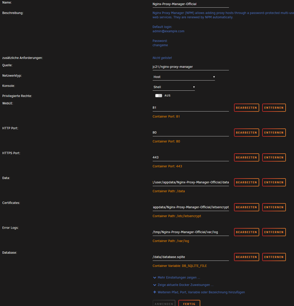

I may have rejoiced too soon. Access to FreshRSS and Nextloud via Nginx Proxy Manager seems to fail sporadically now. Right now, for example, I could access Nextcloud, but not FreshRSS. Then I tried accessing FreshRSS again and after an unusually long wait it did open.
Edited by 4n0nyM
Is your log for NPM in Unraid showing anything spamming over and over? Perhaps something about a port conflict or 80 or anything?
It says something about IPV6, but I actually use IPV4.
Then comes: Current database version: none
But SQLite is entered in the Docker settings.
Here are the logs:
text  error  warn  system  array  login
`QueryBuilder#allowEager` method is deprecated. You should use `allowGraph` instead. `allowEager` method will be removed in 3.0
`QueryBuilder#eager` method is deprecated. You should use the `withGraphFetched` method instead. `eager` method will be removed in 3.0
QueryBuilder#omit is deprecated. This method will be removed in version 3.0
Model#$omit is deprected and will be removed in 3.0.
s6-svscanctl: fatal: unable to control /var/run/s6/services: supervisor not listening
❯ Enabling IPV6 in hosts: /etc/nginx/conf.d
  ❯ /etc/nginx/conf.d/include/assets.conf
  ❯ /etc/nginx/conf.d/include/block-exploits.conf
  ❯ /etc/nginx/conf.d/include/force-ssl.conf
  ❯ /etc/nginx/conf.d/include/ip_ranges.conf
  ❯ /etc/nginx/conf.d/include/letsencrypt-acme-challenge.conf
  ❯ /etc/nginx/conf.d/include/proxy.conf
  ❯ /etc/nginx/conf.d/include/ssl-ciphers.conf
  ❯ /etc/nginx/conf.d/include/resolvers.conf
  ❯ /etc/nginx/conf.d/default.conf
  ❯ /etc/nginx/conf.d/production.conf
❯ Enabling IPV6 in hosts: /data/nginx
  ❯ /data/nginx/default_host/site.conf
  ❯ /data/nginx/proxy_host/1.conf
  ❯ /data/nginx/proxy_host/17.conf
  ❯ /data/nginx/proxy_host/6.conf
  ❯ /data/nginx/redirection_host/1.conf
[7/2/2022] [3:26:26 PM] [Migrate  ] › ℹ  info      Current database version: none
[7/2/2022] [3:26:26 PM] [Setup    ] › ℹ  info      Logrotate Timer initialized
[7/2/2022] [3:26:26 PM] [Setup    ] › ℹ  info      Logrotate completed.
[7/2/2022] [3:26:26 PM] [IP Ranges] › ℹ  info      Fetching IP Ranges from online services...
[7/2/2022] [3:26:26 PM] [IP Ranges] › ℹ  info      Fetching https://ip-ranges.amazonaws.com/ip-ranges.json
[7/2/2022] [3:26:26 PM] [IP Ranges] › ℹ  info      Fetching https://www.cloudflare.com/ips-v4
[7/2/2022] [3:26:26 PM] [IP Ranges] › ℹ  info      Fetching https://www.cloudflare.com/ips-v6
[7/2/2022] [3:26:27 PM] [SSL      ] › ℹ  info      Let's Encrypt Renewal Timer initialized
[7/2/2022] [3:26:27 PM] [SSL      ] › ℹ  info      Renewing SSL certs close to expiry...
[7/2/2022] [3:26:27 PM] [IP Ranges] › ℹ  info      IP Ranges Renewal Timer initialized
[7/2/2022] [3:26:27 PM] [Global   ] › ℹ  info      Backend PID 247 listening on port 3000 ...
[7/2/2022] [3:26:28 PM] [Nginx    ] › ℹ  info      Reloading Nginx
[7/2/2022] [3:26:28 PM] [SSL      ] › ℹ  info      Renew Complete
[cont-finish.d] executing container finish scripts...
[cont-finish.d] done.
[s6-finish] waiting for services.
[s6-finish] sending all processes the TERM signal.
[s6-finish] sending all processes the KILL signal and exiting.
[fix-attrs.d] done.
[cont-init.d] 01_perms.sh: executing...
Changing ownership of /data/logs to 0:0
[cont-init.d] 01_perms.sh: exited 0.
[cont-init.d] 01_s6-secret-init.sh: executing...
[cont-init.d] 01_s6-secret-init.sh: exited 0.
[cont-init.d] done.
[services.d] done.
[7/2/2022] [3:27:19 PM] [Migrate  ] › ℹ  info      Current database version: none
[7/2/2022] [3:27:19 PM] [Setup    ] › ℹ  info      Logrotate Timer initialized
[7/2/2022] [3:27:19 PM] [Setup    ] › ℹ  info      Logrotate completed.
[7/2/2022] [3:27:19 PM] [IP Ranges] › ℹ  info      Fetching IP Ranges from online services...
[7/2/2022] [3:27:19 PM] [IP Ranges] › ℹ  info      Fetching https://ip-ranges.amazonaws.com/ip-ranges.json
[7/2/2022] [3:27:19 PM] [IP Ranges] › ℹ  info      Fetching https://www.cloudflare.com/ips-v4
[7/2/2022] [3:27:19 PM] [IP Ranges] › ℹ  info      Fetching https://www.cloudflare.com/ips-v6
[7/2/2022] [3:27:19 PM] [SSL      ] › ℹ  info      Let's Encrypt Renewal Timer initialized
[7/2/2022] [3:27:19 PM] [SSL      ] › ℹ  info      Renewing SSL certs close to expiry...
[7/2/2022] [3:27:19 PM] [IP Ranges] › ℹ  info      IP Ranges Renewal Timer initialized
[7/2/2022] [3:27:19 PM] [Global   ] › ℹ  info      Backend PID 246 listening on port 3000 ...
[7/2/2022] [3:27:20 PM] [Nginx    ] › ℹ  info      Reloading Nginx
[7/2/2022] [3:27:20 PM] [SSL      ] › ℹ  info      Renew Complete
[7/2/2022] [4:27:19 PM] [SSL      ] › ℹ  info      Renewing SSL certs close to expiry...
[7/2/2022] [4:27:20 PM] [Nginx    ] › ℹ  info      Reloading Nginx
[7/2/2022] [4:27:20 PM] [SSL      ] › ℹ  info      Renew Complete
Something still doesn't seem to be working right. One moment I can open FreshRSS or Nextcloud, then suddenly both, and the next moment neither. Always random.
These are the Docker settings: (has actually worked for months)
