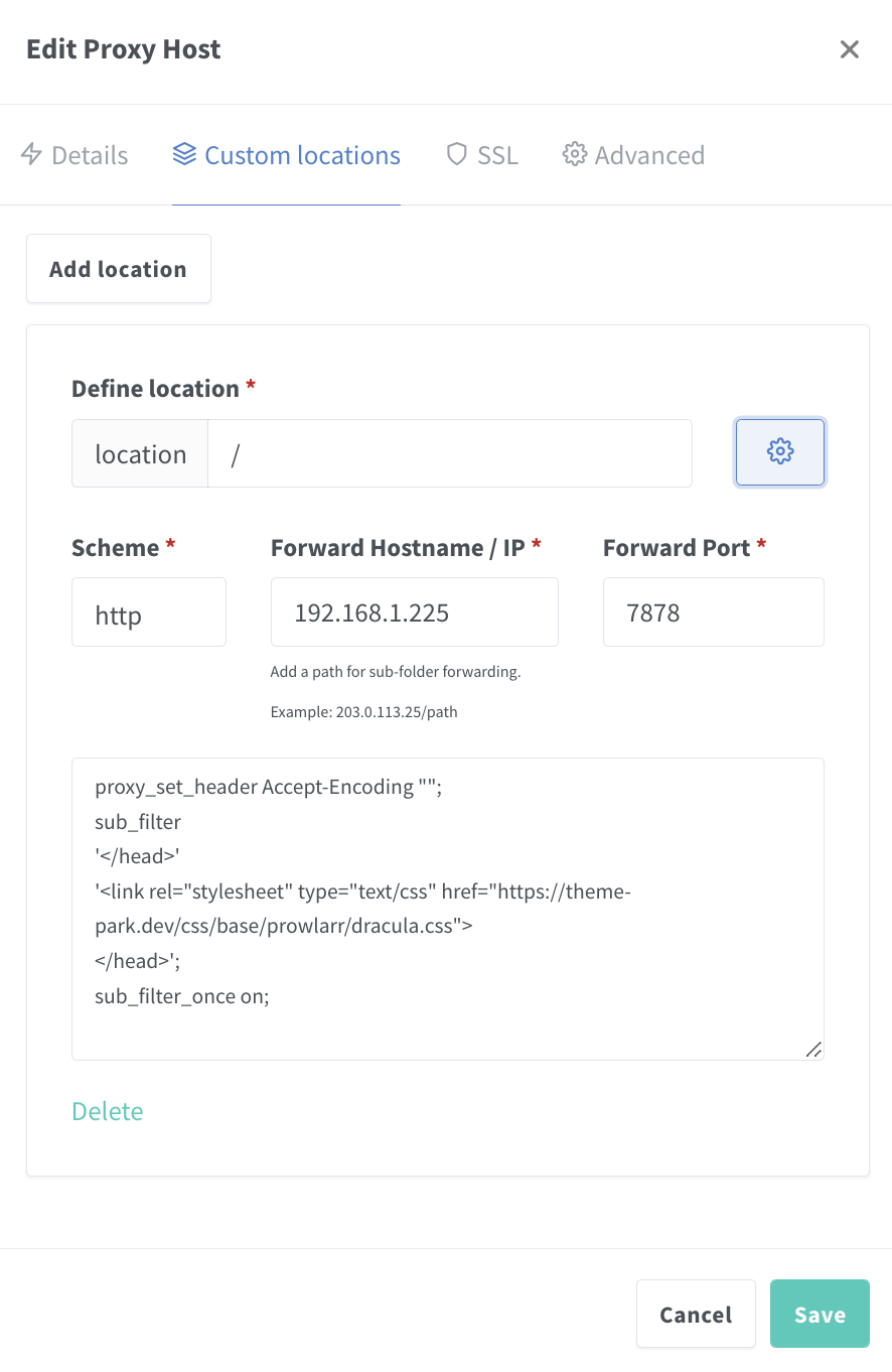

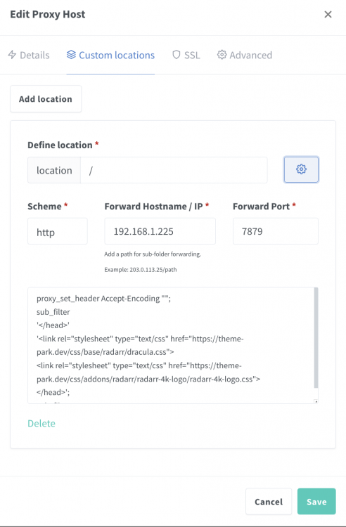

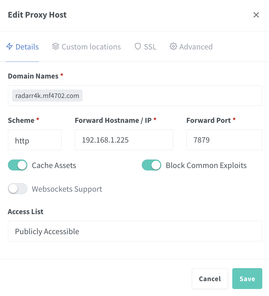

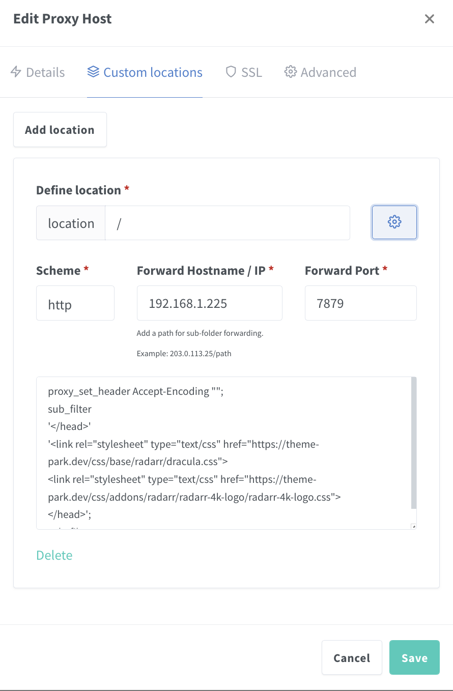

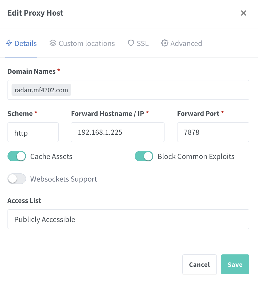

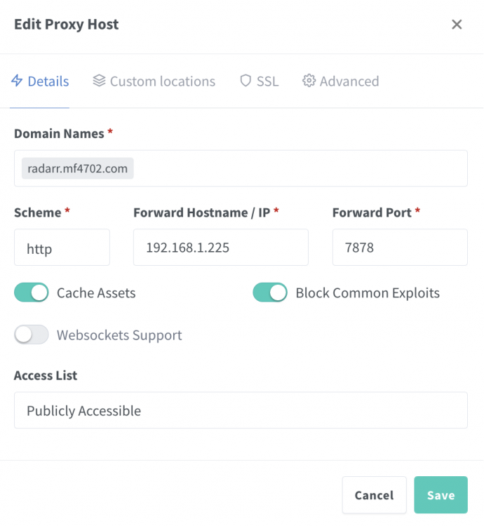

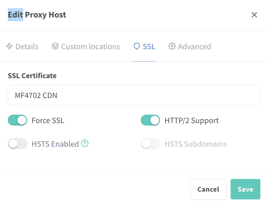

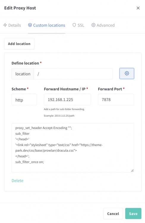

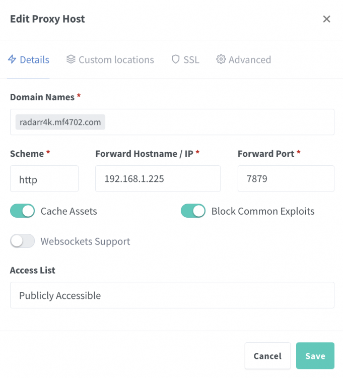

Not sure if this is the right place to ask for help, but I have a weird issue.  I have two Radarr instances in my setup, one standard and one 4k.  Today, my 4k instance is authenticating, but the page never loads fully and doesn't get me into the console, while my standard docker is accessible via the proxy link.  I can access the docker locally and authenticate, and get at what I need, but it does not work correctly when proxied.  I've attached the most relevant screenshots I can think of.  Thanks in advance for any guidance.
***UPDATE***
This issue has resolved itself, apparently.  No action needed, 4K instance is coming up as expected.
Edited by jackfalveyiv
Problem solved
