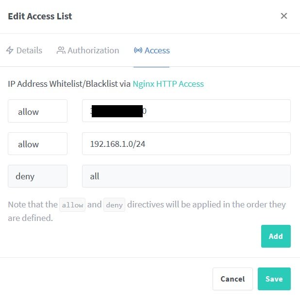

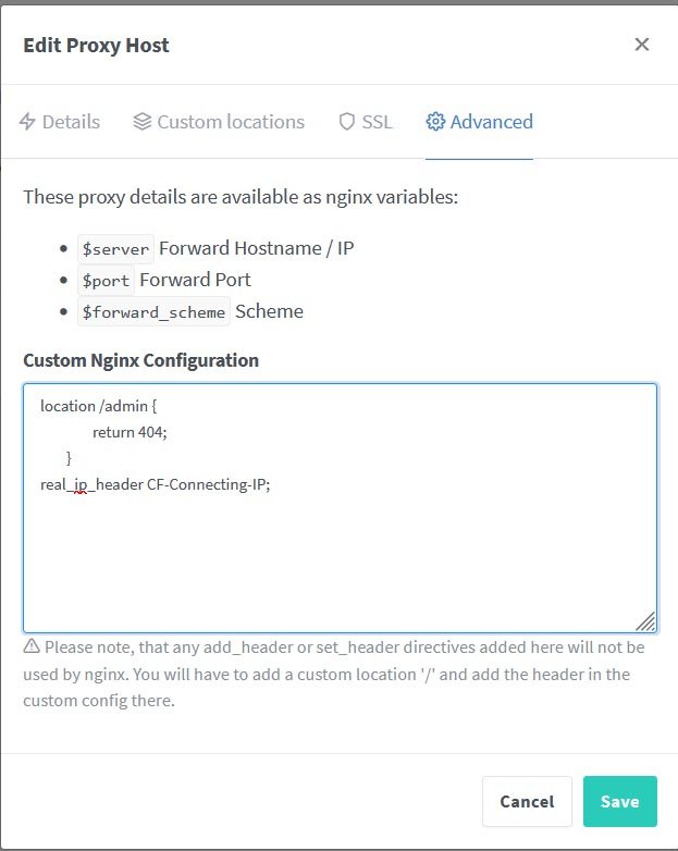

I have vaultwarden running through a reverse proxy that I set up with NGINX Proxy Manager. This used to work fine but suddenly since today I'm getting 403 errors with the reverse proxy. In NGINX I have an access list configured that allows only my external IP and my internal LAN, it denies everything else. This used to work fine. But now I am getting 403 errors when this access list is used. If I set the proxy host to Public Access, everything is fine.
I don't know what could cause the access list to suddenly not work any more. I am using Cloudflare and I did set the custom config real_ip_header CF-Connecting-IP; in the advanced settings of the proxy host. HTTP/2 support is disabled.
Any ideas what could be the issue? I updated NGinx to the latest version. Is the some log that I can check?
How did you do that, isn't this an Enterprise only feature of cloudflare?
Can you access vaultwarden if your remove your rules?
Like so:
This is what I have in my access list:
If I set the Proxy Host to not use this access list, so setting it to Publicly Accessible, then I can reach my vault just fine through the domain, and also login to it without issues.
So the problem is somewhere in the access list, but I can't figure out how.
52 minutes ago, mgutt said:
Ah ok, thought this is only possible with Cloudflare enterprise.
Didn't you need to add the set_real_ip_from rule as well?
https://support.cloudflare.com/hc/en-us/articles/200170786-Restoring-original-visitor-IPs
You're right. Adding the set_real_ip lines to the advanced config fixed the issue for me. Strange that it somehow managed to work for several months without it. Still, working again now. Thanks for the help! :)

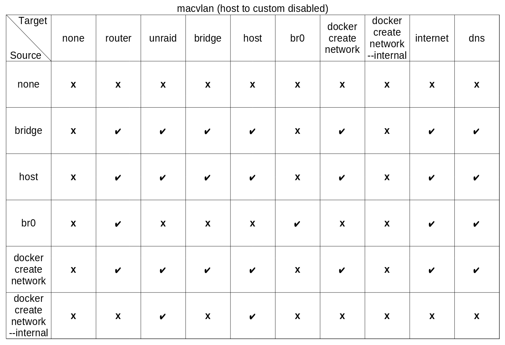

I created a new network for it. Question- do all the dockers running through have to use the same new network? Could that be why is isn’t working?
It depends. Every network type has its own rules:
image.png.30c01df32a20ca804a78f2419e340daa.thumb.png.92c6589f0ff4afb1fb32ee9666c06744.png
Depending on the used networks you can even add containers to multiple networks:
docker network connect <networkname> <containername>

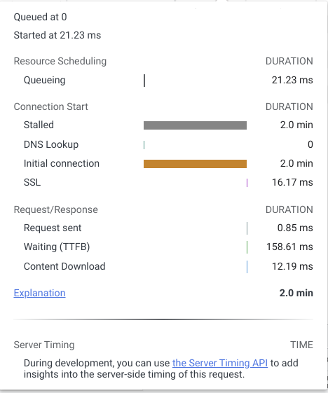

So this is a weird one.  I love using my Chromebook as my daily carry.  I mainly use a Lenovo Duet 5 right now but this issue happens on m Macbook Pro as well.  When I use Chrome browser I get a stall on getting the self hosted website to connect.  This happens all the time on my Chromebook.  When I use the Firefox android app my self hosted sites load up fine on all 3 operating systems.  Is anyone else facing this same issue?  Why is it stalling?!
Edited by GreenEyedMonster
Does this only happen if NPM is in front or does it even happen if you open your website directly through the target container IP?
Only when NPM is in front.  What is really weird is that the VC Code docker loads just fine every single time.  No stall.  Yet, nothing different from the other websites in setup.  Nextcloud, Bookstack, and Ghost have random stalls.
