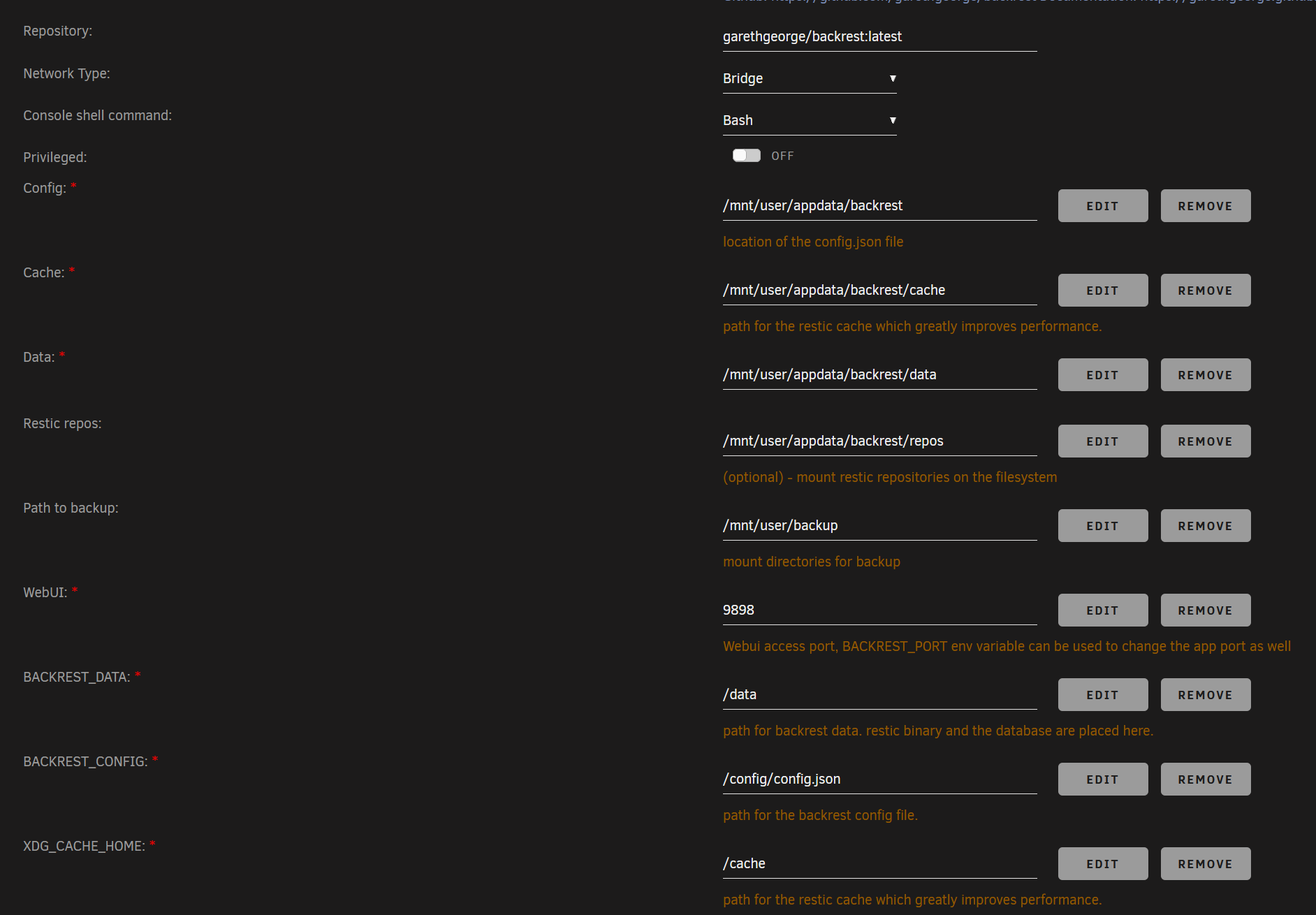

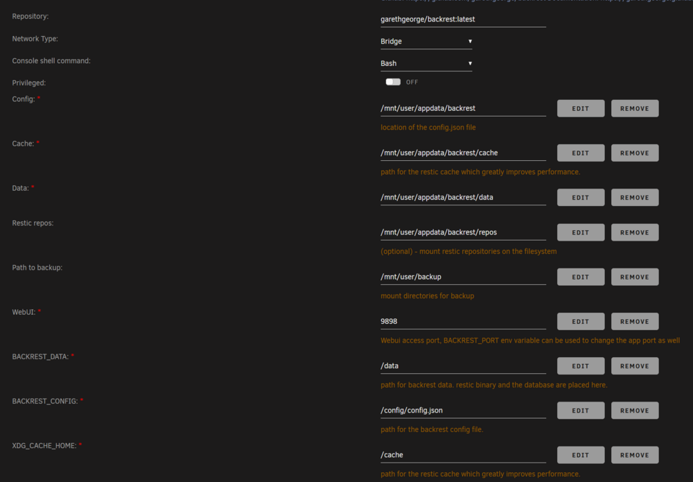

  9. I'm not able to get Backrest working properly. I want to create a repo at the location /mnt/user/resticbackup and I want to backup shares in the /mnt/user folder, like for example /mnt/user/apps. When I create the repo in Backrest I enter the path /mnt/user/resticbackup. When I click on Test Configuration it says "Connected successfully to /mnt/user/resticbackup and found an existing repo." However, there is nothing there yet. No repo is created when I click submit, and when I run a check on the repo it fails because the repo does not exist. Why is this happening? Also, I'm not sure how to get the other shares to show when I create a plan. For some reason the "path" field does not autofill any further than "/mnt", which suggests it can't find anything beyond this. Config attached. What am I doing wrong?
