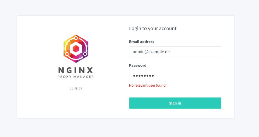

When I try to log in for the first time, I get the following error message: No relevant user found
shame on me. Thank you. 😀
