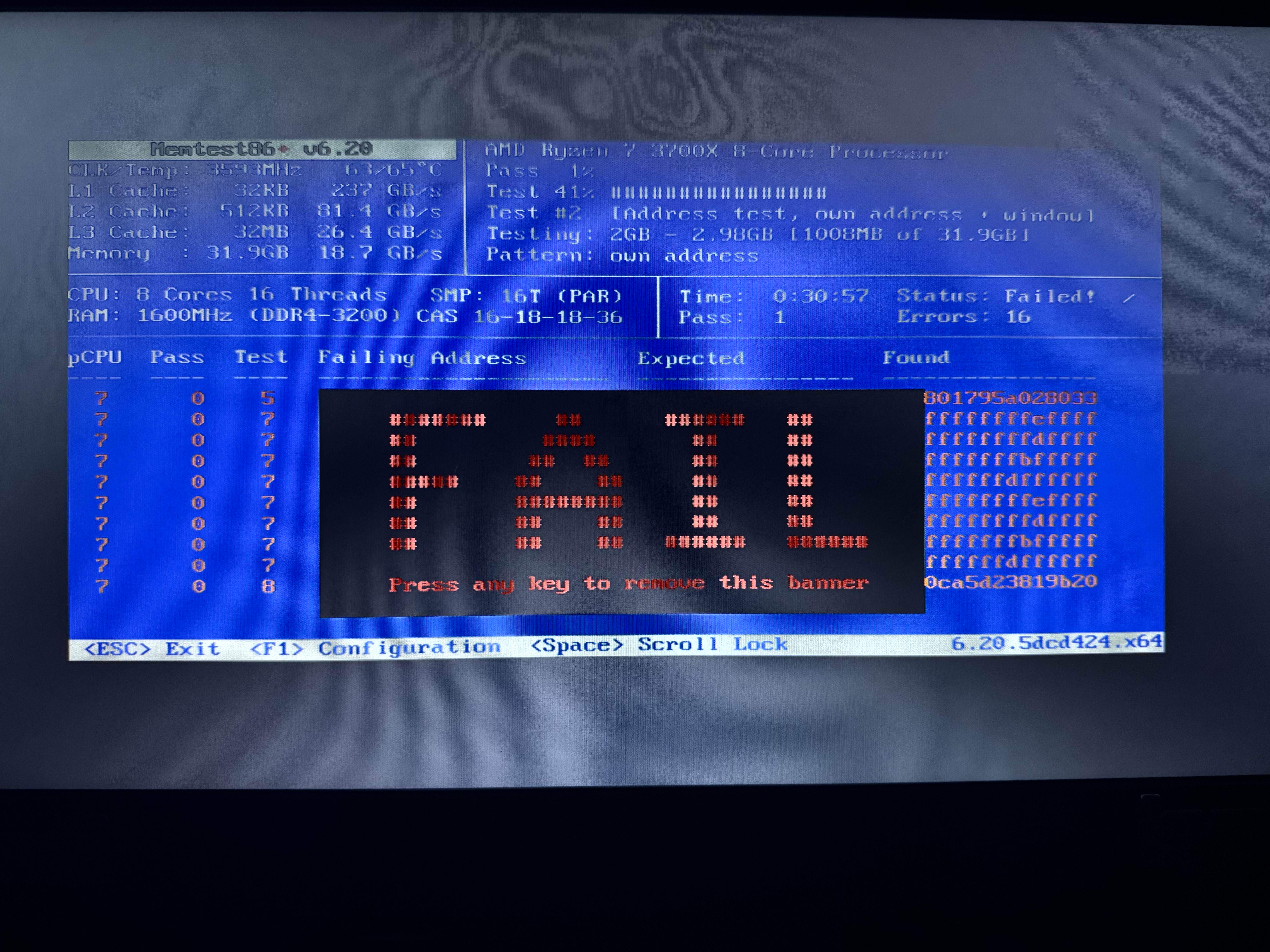

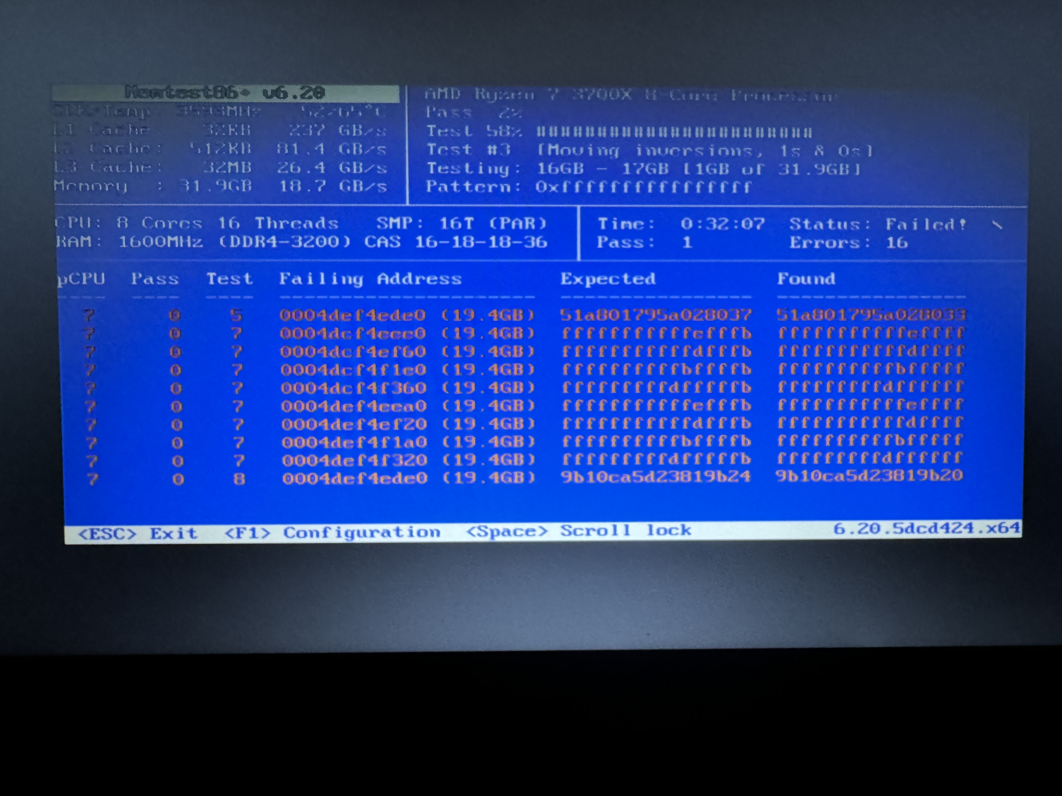

  11. For 3 Days stable, but Mar 19 11:13:39 Server kernel: PMS LoudnessCmd[16217]: segfault at 0 ip 000014ce38ac7090 sp 000014ce335d40b8 error 4 in libswresample.so.4[14ce38abf000+18000] likely on CPU 14 (core 6, socket 0) and Mar 19 12:00:02 Server kernel: BTRFS error (device nvme0n1p1): bdev /dev/nvme0n1p1 errs: wr 0, rd 0, flush 0, corrupt 318, gen 0 Mar 19 12:00:02 Server kernel: BTRFS warning (device nvme0n1p1): csum failed root 5 ino 4711988 off 264597504 csum 0x3019a12b expected csum 0x3ed50501 mirror 1 Mar 19 12:00:02 Server kernel: BTRFS error (device nvme0n1p1): bdev /dev/nvme1n1p1 errs: wr 0, rd 0, flush 0, corrupt 308, gen 0 Mar 19 12:00:02 Server kernel: BTRFS warning (device nvme0n1p1): csum failed root 5 ino 4711988 off 264597504 csum 0x3019a12b expected csum 0x3ed50501 mirror 2 Mar 19 12:00:02 Server kernel: BTRFS error (device nvme0n1p1): bdev /dev/nvme0n1p1 errs: wr 0, rd 0, flush 0, corrupt 319, gen 0 Mar 19 12:00:02 Server kernel: BTRFS warning (device nvme0n1p1): csum failed root 5 ino 4711988 off 264597504 csum 0x3019a12b expected csum 0x3ed50501 mirror 1 Maybe the CPU got problems ... well. I will let it run for a while. We will see.
  12. After a few hours of testing, and swapping the modules around, it seems that one of the Crucial Ballistix BL2K8G32C16U4B 3200 MHz modules died. It was 24/7 online since 28.11.21 - I guess not a server grade RAM module. Well, the test for the last module is running. And I will also check if that is only in that slot. But thank you for your help - I keep you updated. After another 20ish hours, I must say the Crucial ones are working fine. But the kingston ones are gone. So removed the kingston ram's, and till now it's working. Mar 16 18:00:01 Server kernel: BTRFS error (device nvme0n1p1): bdev /dev/nvme1n1p1 errs: wr 0, rd 0, flush 0, corrupt 201, gen 0 Mar 16 18:00:01 Server kernel: BTRFS warning (device nvme0n1p1): csum failed root 5 ino 4711988 off 264597504 csum 0x3019a12b expected csum 0x3ed50501 mirror 2 Mar 16 18:00:01 Server kernel: BTRFS error (device nvme0n1p1): bdev /dev/nvme0n1p1 errs: wr 0, rd 0, flush 0, corrupt 212, gen 0 Mar 16 18:00:01 Server kernel: BTRFS warning (device nvme0n1p1): csum failed root 5 ino 4711988 off 264597504 csum 0x3019a12b expected csum 0x3ed50501 mirror 1 Mar 16 18:00:01 Server kernel: BTRFS error (device nvme0n1p1): bdev /dev/nvme1n1p1 errs: wr 0, rd 0, flush 0, corrupt 202, gen 0 Mar 16 18:00:01 Server kernel: BTRFS warning (device nvme0n1p1): csum failed root 5 ino 4711988 off 264597504 csum 0x3019a12b expected csum 0x3ed50501 mirror 2 Mar 16 18:00:01 Server kernel: BTRFS error (device nvme0n1p1): bdev /dev/nvme0n1p1 errs: wr 0, rd 0, flush 0, corrupt 213, gen 0 Mar 16 18:00:01 Server kernel: BTRFS warning (device nvme0n1p1): csum failed root 5 ino 4711988 off 264597504 csum 0x3019a12b expected csum 0x3ed50501 mirror 1 Mar 16 18:00:01 Server kernel: BTRFS error (device nvme0n1p1): bdev /dev/nvme1n1p1 errs: wr 0, rd 0, flush 0, corrupt 203, gen 0 Mar 16 18:00:01 Server kernel: BTRFS warning (device nvme0n1p1): csum failed root 5 ino 4711988 off 264597504 csum 0x3019a12b expected csum 0x3ed50501 mirror 2 Mar 16 18:00:01 Server kernel: BTRFS error (device nvme0n1p1): bdev /dev/nvme0n1p1 errs: wr 0, rd 0, flush 0, corrupt 214, gen 0 Mar 16 18:00:01 Server kernel: BTRFS warning (device nvme0n1p1): csum failed root 5 ino 4711988 off 264597504 csum 0x3019a12b expected csum 0x3ed50501 mirror 1 Mar 16 18:00:01 Server kernel: BTRFS error (device nvme0n1p1): bdev /dev/nvme1n1p1 errs: wr 0, rd 0, flush 0, corrupt 204, gen 0 Mar 16 18:00:01 Server kernel: BTRFS warning (device nvme0n1p1): csum failed root 5 ino 4711988 off 264597504 csum 0x3019a12b expected csum 0x3ed50501 mirror 2 Mar 16 18:00:01 Server kernel: BTRFS error (device nvme0n1p1): bdev /dev/nvme0n1p1 errs: wr 0, rd 0, flush 0, corrupt 215, gen 0 Mar 16 18:00:01 Server kernel: BTRFS warning (device nvme0n1p1): csum failed root 5 ino 4711988 off 264597504 csum 0x3019a12b expected csum 0x3ed50501 mirror 1 Mar 16 18:00:01 Server kernel: BTRFS error (device nvme0n1p1): bdev /dev/nvme1n1p1 errs: wr 0, rd 0, flush 0, corrupt 205, gen 0 Mar 16 18:00:01 Server kernel: BTRFS warning (device nvme0n1p1): csum failed root 5 ino 4711988 off 264597504 csum 0x3019a12b expected csum 0x3ed50501 mirror 2 Mar 16 18:00:01 Server kernel: BTRFS error (device nvme0n1p1): bdev /dev/nvme0n1p1 errs: wr 0, rd 0, flush 0, corrupt 216, gen 0 I have a few errors on one of the cache SSD's, but I assume that one is about to die. about 70% health ..
  13. Good guess - I guess :-D Faild after 30min But how do I know which module is broken? edit: So ... does that mean 4 modules 8GB each, my 3rd module is broken? Or do I need to check them separately?
