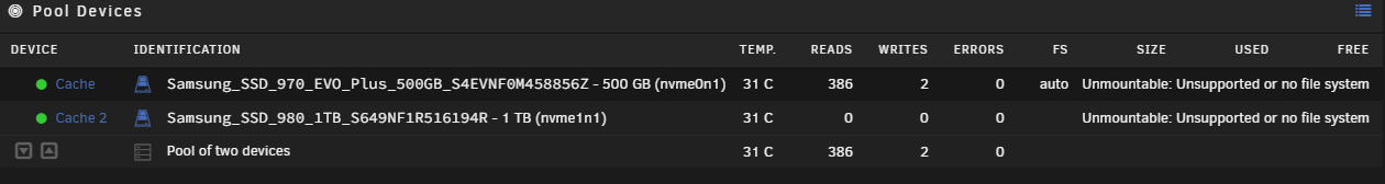

I destroyed my cachepool config
I tried to remove the 2nd SSD of my cachepool.
It used to be a raid1 - since I wanted to remove one disk, I converted it back to single.
Then I removed the 2nd SSD from the config (new config).
But I guess I missed a step. Now I can only wipe the data - which I want to avoid.
So how do I either finish the conversion or restore it back?

Ok, wrong order :-(
Unfortunately not

Label: none  uuid: 53b61841-b900-45f6-a9b6-7446d79b46bc
        Total devices 2 FS bytes used 282.78GiB
        devid    1 size 465.76GiB used 14.00GiB path /dev/nvme0n1p1
        devid    2 size 931.51GiB used 290.06GiB path /dev/nvme1n1p1
looks better I guess?!
Try re-starting the array, the pool should mount now.
If OK then convert the pool to raid1, once done you can remove the device and the pool will automatically be converted to single.
