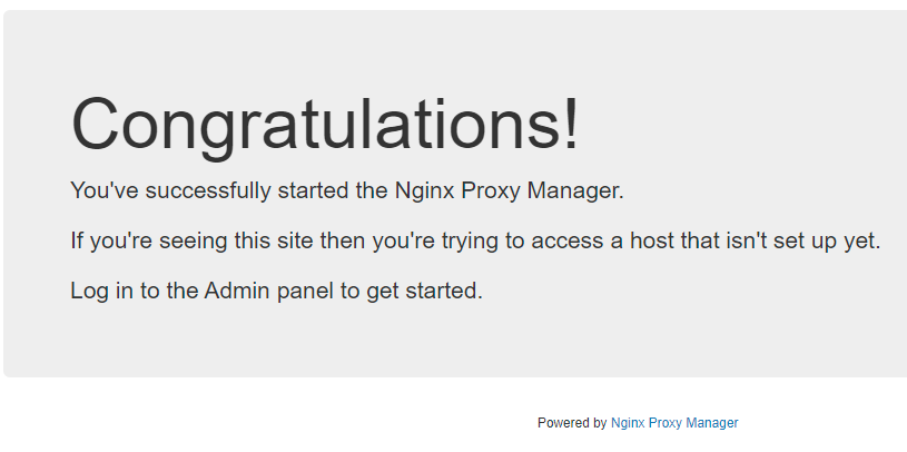

Putting my IP into the browser I reach the default NPM screen:
"Congratulations!
You've successfully started the Nginx Proxy Manager.
If you're seeing this site then you're trying to access a host that isn't set up yet.
Log in to the Admin panel to get started."

Entering my external IP into the browser sends me to the default NPM page:
But entering the urls of the proxy hosts throws the errors.

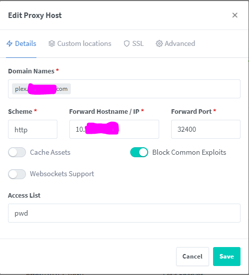

Screenshot from NPM proxy host setting:
4 hours ago, tTownTom said:
404 Not Found
Remove the slash after index.html
For me both requests look good.
