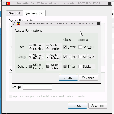

  2. Hi, The permissions that have changed are the removal of write and sometimes read access by the others group as seen in the Krusaders screenshot below: I didn't know that there was a permission reset option in UNRAID. Where can I find it?
  3. So I have UNRAID in a Homelab Active Directory network and UNRAID is connected to said network. Recently, I've been noticing permission issues with my folders where I will randomly lose write access to commonly used folder and then use access to them completely. To get around this, I have to boot up a Krusader Docker as ROOT to reset the permissions and this will allow me full access until it stops working. System infomation: UNRAID 6.11.5 connected to Windows Server 2019 Domain Controller Samba configuration: server min protocol = SMB3_11 client ipc min protocol = SMB3_11 smb encrypt = required Dockers: Navidrome, FileShelter, FlashPapaer, dokuwiki, nextcloud (LinuxServer.io version) and Krusader VMs: Windows 10 Pro, Windows 8.1 Embedded and Ubuntu Clients: Windows 10 Pro and Education 22H2

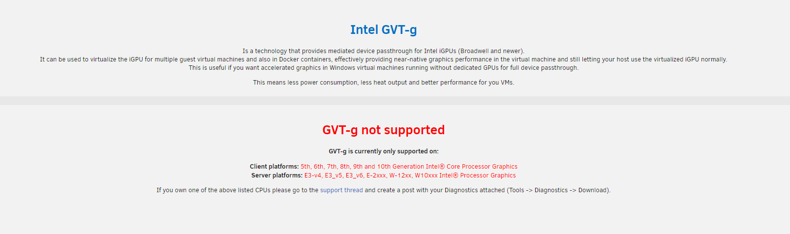

  4. I'm having an issue where GVT-g isn't supported even though I have an Intel Core i5 9400 which should be a supported processor for this plugin. I've attached the diagnostics files to this post. unraid-server-diagnostics-20220319-1339.zip

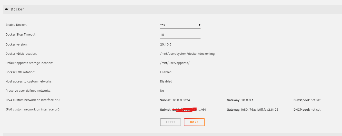

  7. I was wondering if I could just disable it for the docker itself rather than disabling IPv6 support on the entire system
  8. Currently, only an IPv4 address has been assigned to the docker though my network is dualstack so how do I disable IPv6 on the Docker?

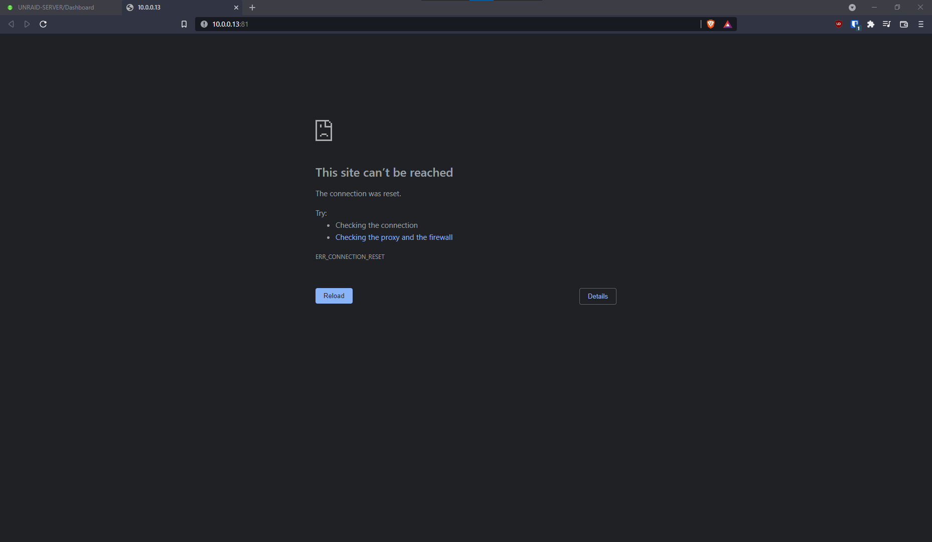

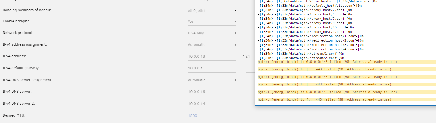

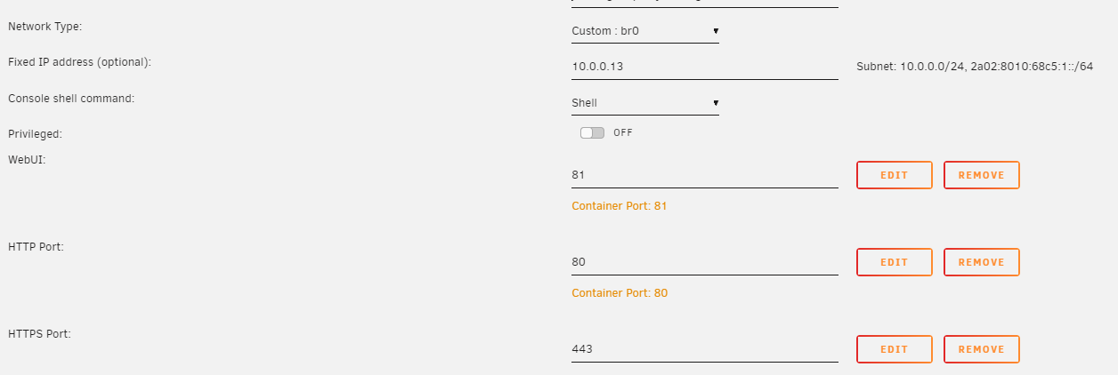

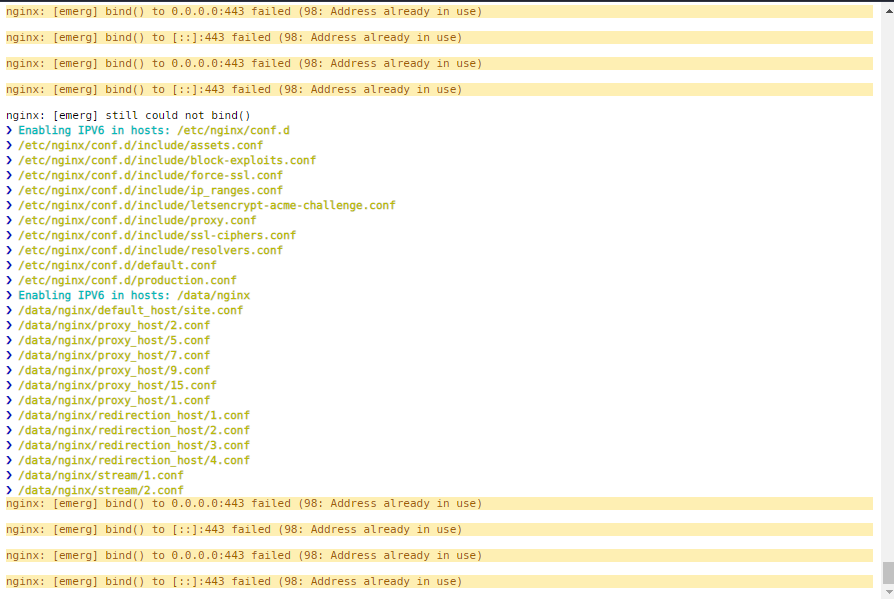

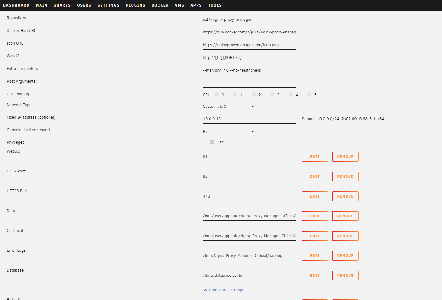

  9. Hi, I've upgraded from UNRAID 6.9.2 to the latest RC2 release and now my connection to the Nginx Proxy keeps resetting Looking at the logs, it looks like it's failing to bind to the ports: The docker is configured to use its own IP address. How would I force the ports to bind correctly so I can get this proxy back up and running? EDIT: I've also tried downgrading back to 6.9.2 and I'm still having the same issue

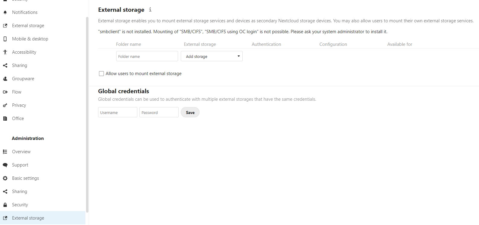

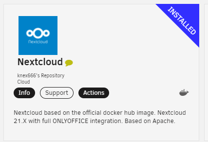

  10. Hi, I'm trying to setup Nextcloud and connect it to my existing shares on UNRAID. I've downloaded and installed the official Docker for NextCloud and enabled external device support but it says it's missing the SMBClient but I can't find it anywhere in the NextCloud webUI or in the apps section of UNRAID so I was wondering how I could install it onto Nextcloud so I could connect my shares.
