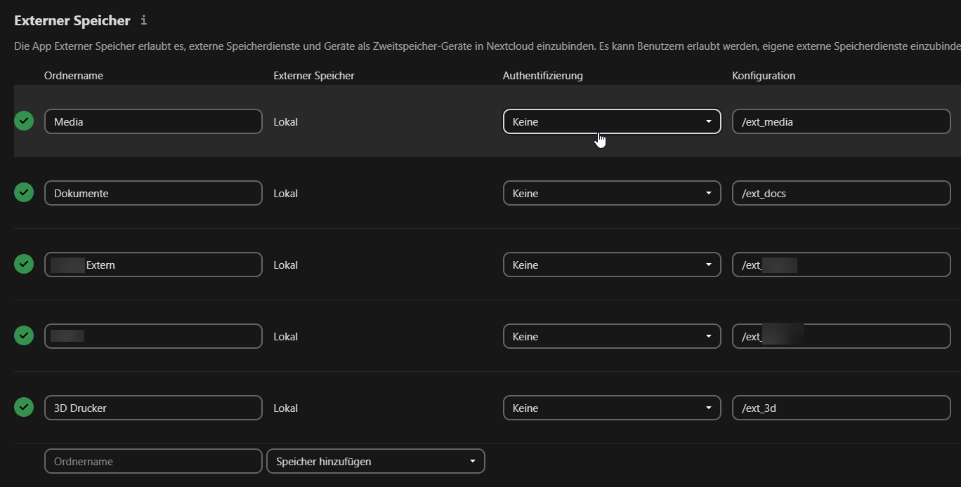

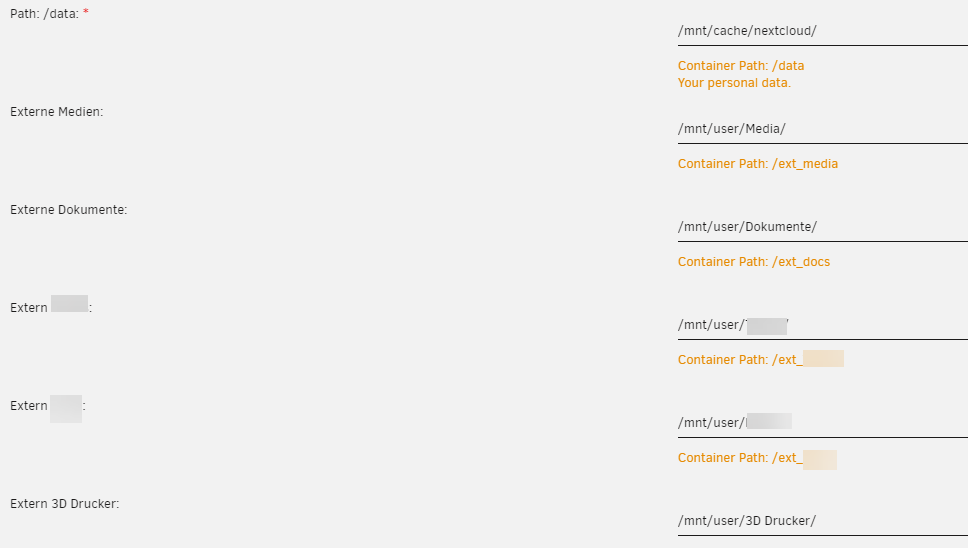

I connected my External Share without the SMBclient, you just have to mount the Shares to the Nextcloud Container, after that you can mount them in the Nextcloud Plugin "External Storage" to your Dashboard. You can choose where to mount the share in the container, i went with "ext_xxxx" so i now it is external storage.
In the plugin, you have to choose "local" instead of "smb" because the share is now mounted to the Docker Container. Works like a charm for me since years.
