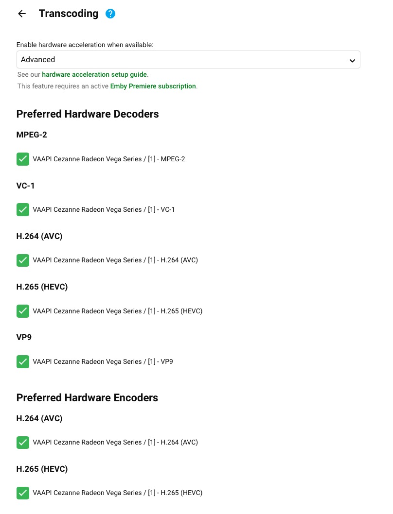

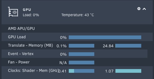

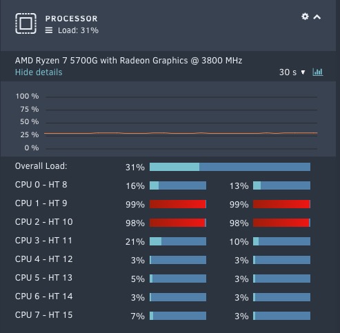

  1. Reviving this old thread as transcoding and conversions when downloading to an ipad has reverted to using the CPU rather than GPU. is anyone else seeing this behaviour? Does anyone know what might be causing this as the GPU is now not utilised and CPU is being maxed out again.
  2. Issue with HW decoding - Please Help Hi I have had the container installed for a while and added a variable to the container for a device and set the variable to /dev/dri to enable hardware decoding. This enabled the preferred Hardware decoders to be seen by emby (see attached screenshot), However when transcoding (or converting a file as part of an offline download to ios) the GPU is not being used and instead the CPU utilisation for cores allocated to the container max out at 100%. The conversions are taking a long time to complete (about an hour for a film). CPU is an AMD Ryzen 7 5700G with Radeon Graphics and I am trying to use the APU for transcoding. Can you advise how i can enable HW decoding and verify its operation for media? I have also attached the CPU usage and the GPU usage graphs during a conversion below. Thanks in advance

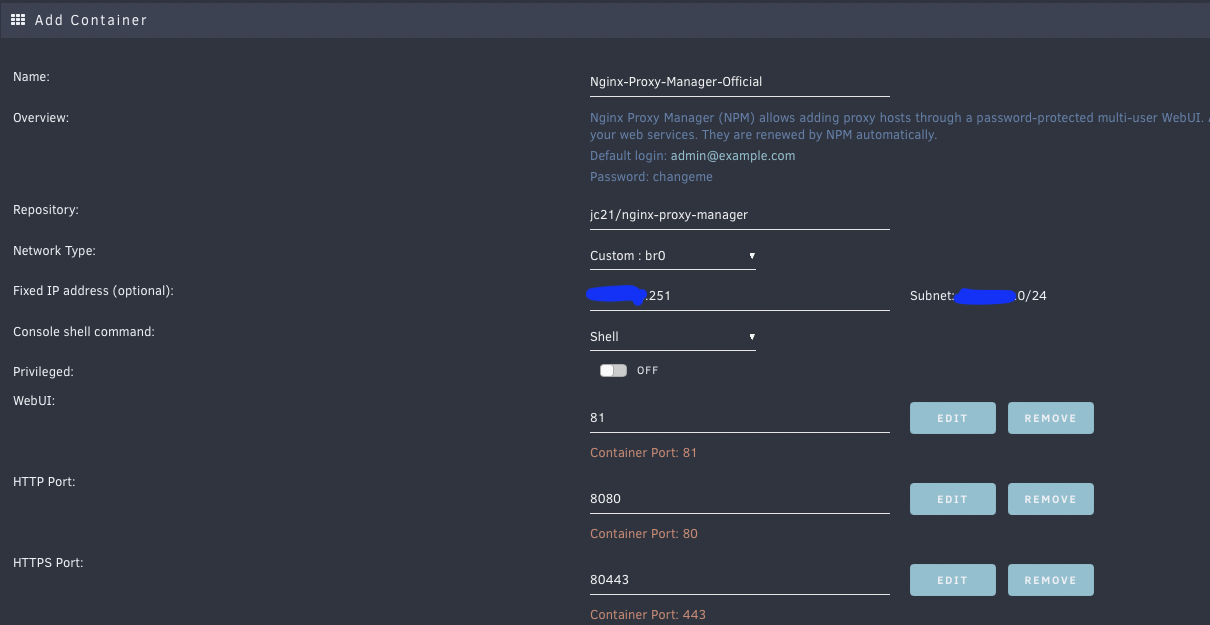

  4. Hi All, having an issue with the Nginx-Proxy-Manager-Official container. I have the container running on a custom network (br0) with a static private ip set. When launching the container i change the values for the http and https port to 8080 and 80443 respectively, however when the container runs it is still opening these ports as their default 80 & 443 values. Has anyone seen this issue before and if so what was the fix?
  5. Thanks rich and econaut, thats solved it transcoding is seamless now and cpu usage has dropped right down so it appears to be working. Thanks very much for the help.
