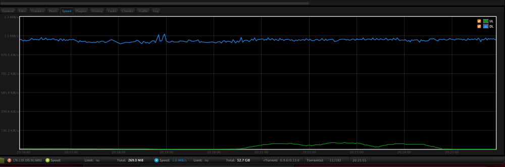

just testing this out and my speeds are ALOT better than with deluge. I think I found my new torrent client. Thanks alot for this.
Yeah it's a hard one to say definitely it's xx percent faster then deluge as it of course depends on which peers your connected to but I'm pretty confident it's faster than deluge.
