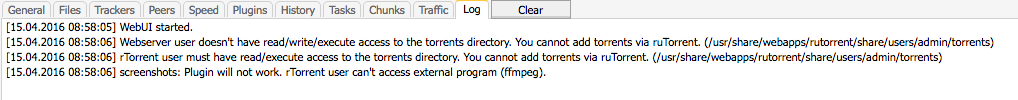

I'm trying to set it up the way I had it before, did something happen to 'automove based on label'? I don't see the option to set up the label filter anymore or tell it how to create the nested folders.
I am still seeing an error rated to the ngnix.conf file
[emerg] 703#0: open() "/etc/nginx/nginx.conf" failed (13: Permission denied)
I have deleted and repulled the docker, deleted and allowed the container to recreate all files.  Here is my docker run command

I have tried the same with airvpn config as well and get the same error.  I also have tried running it with PUID = 0 PGID = 0 to no avail.  I am attaching full logs.
so the nginx.conf file is copied from the container to your host system and then symlinked back in (only if it doesnt already exist), you need to make sure you dont have any permissions issues, esp if you have been switching the user account the docker is running as, this could of screwed up permissions, run the following on your host and let me know the output:-
ls -al /volume2/docker/rtorrent/config/nginx/config/
the permissions displayed from the above command must match the UID and GID for the user account your running the container as. If you want to reset permissions then you can simply stop the container, then delete the file /volume2/docker/rtorrent/config/perms.txt, then start the container.
total 4
drwxrwxr-x 1 rtorrent users   20 Apr 13 11:13 .
drwxrwxr-x 1 rtorrent users   38 Apr 13 11:13 ..
-rwxrwxr-x 1 rtorrent users 3083 Apr 14 09:21 nginx.conf
I chown rtorrent:users the whole /volume2/docker/rtorrent/* just to be sure, and deleted the perms.txt and reran the container and got the same result.  I am going to delete the whole config folder, pull the container again, and start over to see what happens.
You would have to run chown with the -R flag for recursive likely. (might be -r, can't recal).
ya it is -R.  Still did not work.
Deleting the entire config directory and standing up a new container also did not work.  I tried the latest docker as root, UID=0 GID=0, and that also did not work.

Thanks for the speedy response.  Changing the gateway worked to get it running.  However, I'm getting some other errors and was wondering how I can remove them.
2016-04-15 08:51:21,666 DEBG 'rtorrent-script' stderr output:
PHP Warning: require_once(../plugins/rss/init.php): failed to open stream: No such file or directory in /usr/share/webapps/rutorrent/php/initplugins.php on line 227
PHP Fatal error: require_once(): Failed opening required '../plugins/rss/init.php' (include_path='.:') in /usr/share/webapps/rutorrent/php/initplugins.php on line 227
2016-04-15 08:51:21,669 DEBG 'rtorrent-script' stdout output:
[info] Sleeping for 5 mins before rechecking listen interface and port (port checking is for PIA only)
2016-04-15 08:51:22,112 DEBG 'webui-script' stdout output:
[info] starting php-fpm...
2016-04-15 08:51:22,179 DEBG 'webui-script' stderr output:
[NOTICE] [pool www] 'user' directive is ignored when FPM is not running as root
[NOTICE] [pool www] 'group' directive is ignored when FPM is not running as root
2016-04-15 08:51:22,182 DEBG 'webui-script' stdout output:
[info] starting nginx...
2016-04-15 08:52:05,346 DEBG 'webui-script' stderr output:
2016/04/15 08:52:05 [error] 715#0: *1 FastCGI sent in stderr: "PHP message: PHP Warning: fopen(/usr/share/webapps/rutorrent/share/users/admin/settings/uisettings.json): failed to open stream: No such file or directory in /usr/share/webapps/rutorrent/php/getsettings.php on line 7" while reading response header from upstream, client: 25.161.153.240, server: localhost, request: "POST /php/getsettings.php HTTP/1.1", upstream: "fastcgi://127.0.0.1:7777", host: "25.19.28.19:9080", referrer: "http://25.19.28.19:9080/"
2016-04-15 08:52:07,897 DEBG 'webui-script' stderr output:
2016/04/15 08:52:07 [error] 715#0: *3 FastCGI sent in stderr: "PHP message: PHP Notice: Only variables should be passed by reference in /usr/share/webapps/rutorrent/php/util.php on line 546" while reading response header from upstream, client: 25.161.153.240, server: localhost, request: "GET /plugins/tracklabels/action.php?label=nlb HTTP/1.1", upstream: "fastcgi://127.0.0.1:7777", host: "25.19.28.19:9080", referrer: "http://25.19.28.19:9080/"
