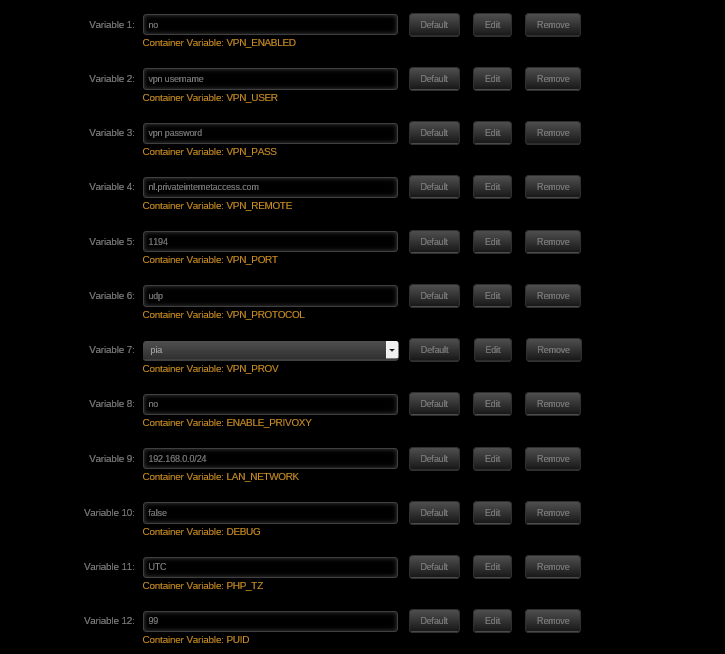

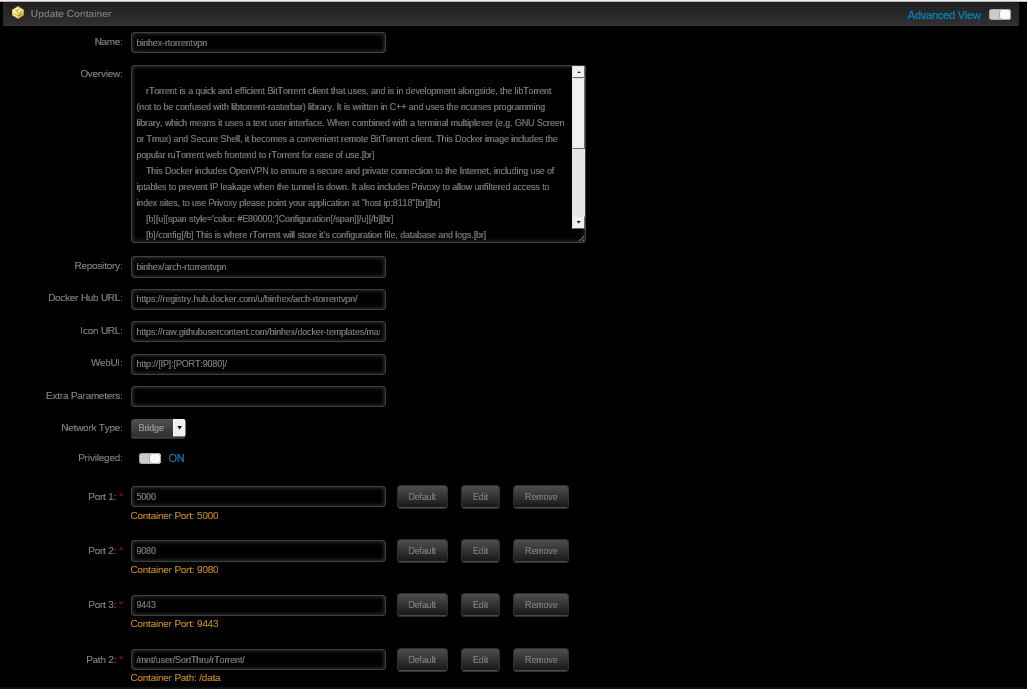

Thanks for this great docker. I can't wait to get it working.
I'm hoping someone can help. When I enable VPN I get a timeout on the webgui, when I disable the VPN it works. I'm using pia and have put in my preferred server and credentials. UNRAID 6.1.9. Attached are the logs while attempting to start with VPN enabled. The only thing that jumps out at me is the iptable_mangle missing error. Any thoughts?

hmm odd, im assuming this has the tick box ticked to run as privileged right?
script: cannot open typescript: Permission denied
This looks a lot like the permissions issue I was getting due to apparmor and the symlink to the nginx config.
Yes privileged and host mode

Host mode? That's your problem if it's set to that, it should be bridge mode.
Sent from my SM-G900F using Tapatalk
My bad, it is bridged and privileged
Myk
Myk
OK can you post a screenshot of the advanced settings screen, it's got to be a config issue, don't forget to hide username and password
Here is container settings
Remember I don't have vpn setup yet - just wanted to get basic container running to look at the web interface etc
Myk
