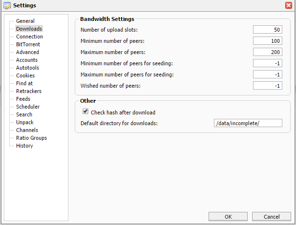

Hi binhex - This docker is awesome. Thanks for developing it.
I'm having some trouble with the docker image growing full as I download torrents. Any suggestions?
Thanks
Thanks

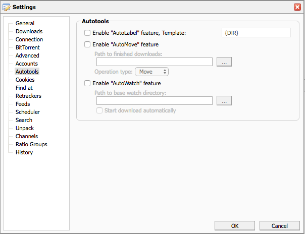

have you configured autotools by any chance? (see attachment), if you have then you need to make sure its set to /data/<folder of your choice>
Thanks
Negative, autotools are disabled

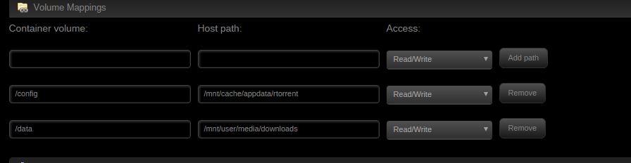

ok so does /data/incomplete exist on your unraid host and can you see incomplete downloads in there?
Thanks
"/data/incomplete" doesn't specifically exist on my host but i mapped the /data folder to /mnt/user/media/downloads. however, i do see /incomplete within /mnt/user/media/downloads.
I do see something interesting though. I downloaded a movie and it went to /mnt/user/media/downloads/incomplete. Great. I'm currently trying to download a tv show and its going to the docker img according to

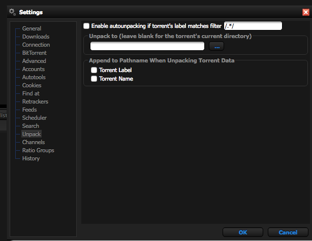

ok so it probably is related to adding a label then, have you configured the unpack settings by any chance? (see attachment) this also allows you to define a different path, if its blank i would recommend setting this to your incomplete folder, so /data/incomplete
Thanks
find /var/lib/docker/btrfs -type f -size +50000k -exec ls -lh {} \; | awk '{ print $9 ": " $5 }'
, but it also has a label "TV" whereas the movie did not have a label.
Ill see if that has anything to do with it.
so it wasnt related to the label, however, sonarr was incorrectly configured. sorry for the confusion and thanks for the help.
