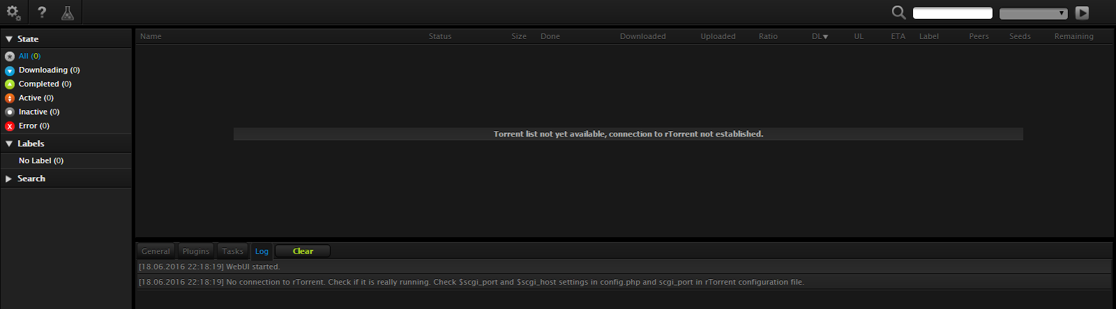

After having the system working well for a few weeks, I'm suddenly getting "Torrent list not yet available..." in the web interface as well as "No connection to rTorrent" in the web interface log tab. The VPN proxy still works, just the torrent interface is down.
I rebooted the container a bunch of times attempting to fix to no avail. Any pointers on where I should look to attempt to resolve?

if you have updates waiting then pull down the latest docker image, it is possible your running into a bug that has been fixed in the later builds.

ok so im going to need the full supervisord.log output located in /config, the contents of any of the config files you might of modified, nginx/rtorrent/php, if you can please attach them then i can take a look.
if the above sounds like a lot of hassle and your willing to reconfigure everything again then the alternative is to blow away your /config folder on the host for this container, then restart and it will then reset it back to out of the box, the choice is yours :-).

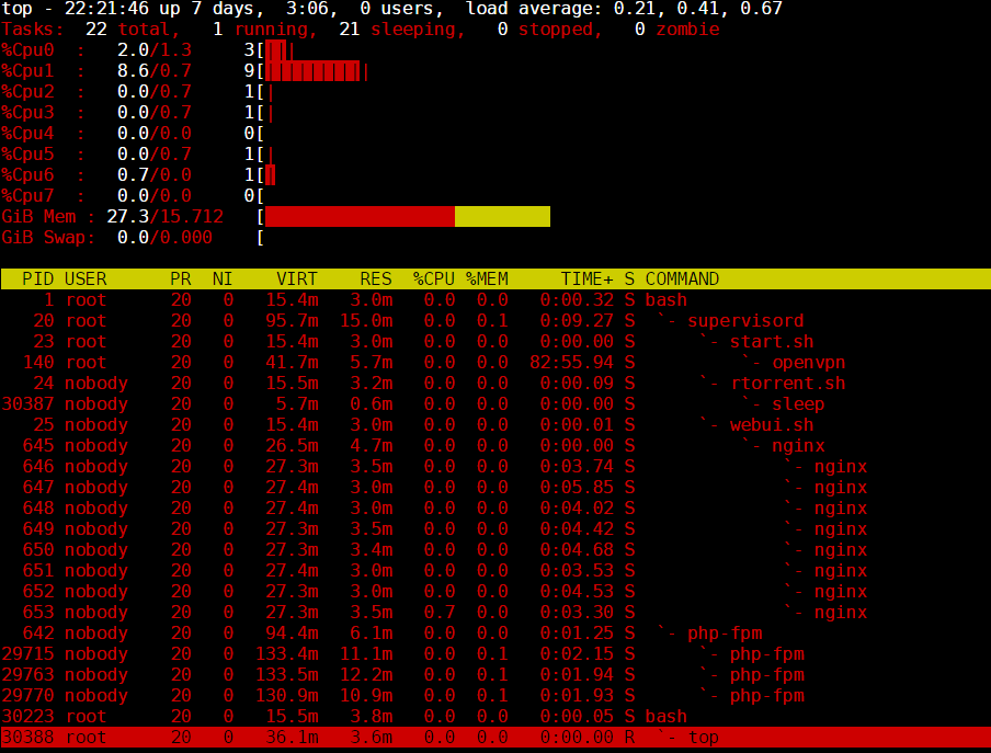

Had this same problem happen to me today.....
It has something to do with the rtorrent session folder....
I left at 5am headed to work, and according to logs - everything stoped at prox 615 am.
If I delete contents of session folder - restart docker, web interface connection - but have lost all current torrents and have to add them back from saved .torrent files.....
Myk
From the tidbits I am finding - it looks like a socket problem - but am not sure on that
Others are having this problem as well

Just had it happen again ealier this am - when it happens is the only time I get this type of line in my supervisord.log file:

The line specific:  Sun Jun 12 06:17:04 2016 TLS: tls_process: killed expiring key
that is when I get problem - and now have to wipe out the session folder to get it back up

Ok, happened again but this time
I wanted to change a option in the .rc config file so I selected everything and did a stop - everything looked good
went to docker tab, stopped docker, edited the rtorrent.rc file and removed a "#" in front of a option, restared docker
come back to web interface and it will not connect anymore - am gonna have to wipe the session folder and readd all torrents to get back up and running again....
here is supervisord.log showing restart of docker after rtorrent.rc file edit....

Myk
ok so quick check, what did you use to edit the file?, did you use notepad?, you need to be careful of line endings, if you use notepad it will save it with windows line endings and this will royally screw up the config file.
I used textpad - when doing a save as - it sees the file as a unix file - so that was not the problem....
I cleared the session folder again, started docker back up and web interface connected - just no torrents again
Am not sure what to look for - this is a bugger to track down
Myk
Myk

So after I've had a few issues with CouchPotato, I decided to just point Firefox at privoxy to find files manually. However, when I perform a DNS leak test, it fails. I've set network.dns.disablePrefetch;true and network.proxy.socks_remote_dns;true in Firefox. Any other suggestions? Also, how I would test rtorrent to make sure it's also not subject to a dns leak? Thanks!
ok, when it goes down and the web ui cannot talk to rtorrent - I executed a bash shell and there is no tmux running - even after manually running a rtorrent.sh reload
Myk
I restarted leaving session folder as it - tmux process is not there
I restarted clearing out session folder - tmux process IS there
something is the session folder either crashes rtorrent on load or is not letting it start
is there a log file somewhere from rtorrent?
Myk
