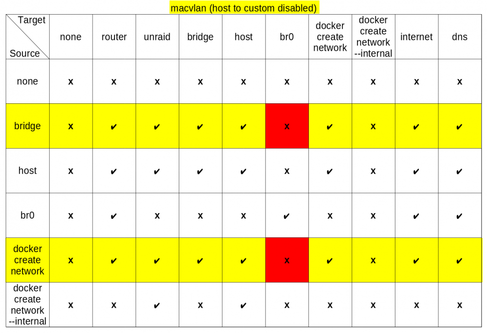

Did something change with the package/binary in the last release or two? I can't pinpoint exactly when the problems started, but all of my Proxy hosts that are pointed to internal sites are all throwing 502 errors. They all show "online" in the dashboard, so I assume that means they are reachable. The cert is definitely getting renewed, and I can renew it through the UI just fine too.
I don't think anything changed on my side that would cause ALL of them to stop working. I'm thinking it's something network-related with the docker container, as I've seen some recent comments on things that might be different there. I'm currently using Custom Br0, and have been for years without issues. I wish the docker CLI had some ping//netcat commands to help troubleshoot network issues, but it looks pretty bare. The single error.log in /var/log/nginx isn't too helpful when the 502 happens. Are there other more detailed logs someplace?
I see curl is installed and when I run that from the docker instance it does show correct data when I point it at an internal host, so maybe not specifically network?
Edited by yoleska
My setup sounds exactly like yours and I was having the same issue. What fixed it for me was to enable "Host access to custom networks" in the advanced Docker settings which is off by default.

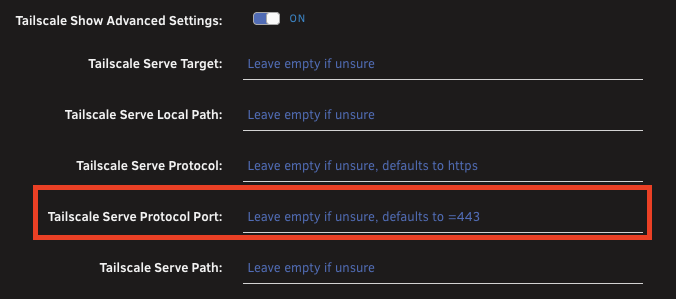

When trying to enable tailscale in this container:
Executing Unraid Docker Hook for Tailscale
Detecting Package Manager...
Detected Advanced Package Tool!
Installing packages...
Please wait...
ERROR: Installing packages!
Ign:1 https://deb.nodesource.com/node_22.x nodistro InRelease
Ign:2 http://deb.debian.org/debian bookworm InRelease
Ign:3 http://deb.debian.org/debian bookworm-updates InRelease
Ign:4 http://deb.debian.org/debian-security bookworm-security InRelease
Err:1 https://deb.nodesource.com/node_22.x nodistro InRelease
Temporary failure resolving 'deb.nodesource.com'
Err:2 http://deb.debian.org/debian bookworm InRelease
Temporary failure resolving 'deb.debian.org'
Err:3 http://deb.debian.org/debian bookworm-updates InRelease
Err:4 http://deb.debian.org/debian-security bookworm-security InRelease
Reading package lists...
W: Failed to fetch http://deb.debian.org/debian/dists/bookworm/InRelease Temporary failure resolving 'deb.debian.org'
W: Failed to fetch http://deb.debian.org/debian/dists/bookworm-updates/InRelease Temporary failure resolving 'deb.debian.org'
W: Failed to fetch http://deb.debian.org/debian-security/dists/bookworm-security/InRelease Temporary failure resolving 'deb.debian.org'
W: Failed to fetch https://deb.nodesource.com/node_22.x/dists/nodistro/InRelease Temporary failure resolving 'deb.nodesource.com'
W: Some index files failed to download. They have been ignored, or old ones used instead.
Building dependency tree...
Reading state information...
Package wget is not available, but is referred to by another package.
This may mean that the package is missing, has been obsoleted, or
is only available from another source
E: Package 'wget' has no installation candidate
Eventually:
ERROR: Unraid Docker Hook script throw an error!
Starting container without Tailscale!
I think there's an issue with the container and the pre-defined tailscale script.
Were you abe to resolve this? This just happened to me today and I had to disable my local NPM and point my URLs to my external NPM for traffic to start working again.
