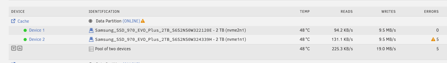

  1. @FlamongOle ahh... for some reason it fell out?? It's been the second cache drive in that pool for years. But you're right - I went into the settings and saw that it was unassigned and added it back. Weird.
  2. Is there any way to refresh this data? This shows one of my NVME drives as "not present" but under Main, there's definitely activity on both drives in the pool. There have been some errors in the past, but nothing currently. Unraid 7.3.2, latest updates for this plugin applied. SMART test run - still shows error in the visual, but SMART reports no problems with the drive. Checking devices, please wait until it is completed...SMART: /dev/sg0 ACTIVE (1f0a04395f) done in 283ms. SMART: /dev/sg1 IDLE (b4e3f66b5a) done in 511ms. SMART: /dev/sg2 ACTIVE (8de8140889) done in 290ms. SMART: /dev/sg3 IDLE (7c13e43d6f) done in 512ms. SMART: /dev/sg4 IDLE (d3cf432007) done in 505ms. SMART: /dev/sg5 IDLE (61288ad540) done in 515ms. SMART: /dev/sg6 IDLE (755233ea79) done in 510ms. SMART: /dev/sg7 IDLE (c89d4a8d1f) done in 511ms. SMART: /dev/nvme0n1 ACTIVE (e156593cbd) done in 49ms. SMART: /dev/nvme1n1 ACTIVE (3f707fed52) done in 27ms. SMART: /dev/nvme2n1 ACTIVE (edbf2f72e1) done in 28ms. Completed after 3.8 seconds.

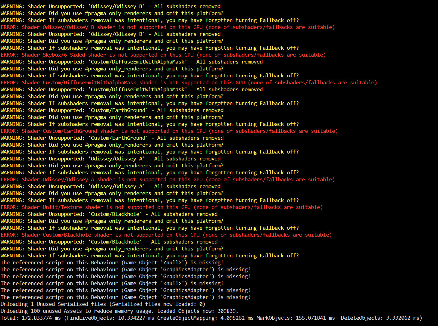

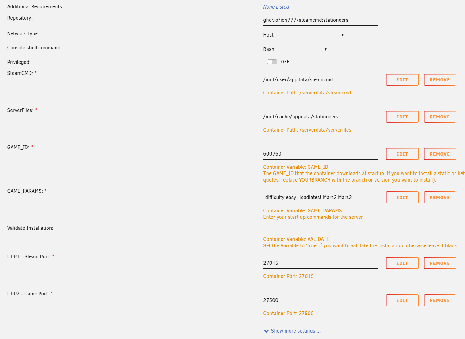

  10. Latest Stationeers update: First, the command line args that you're passing are incorrect - likely from an older game version. There is no "Mars1" world and that was one problem I found. Valid worlds: Europa3, Lunar, Mars2, MimasHerschel, Tutorial1, Tutorial2, Tutorial3, Airlock, FurnaceBasics, Manufacturing, Venus, Vulcan. Once I changed it to "Mars2" I did get a bit further. Second, I can show you logs from both, but was able to get this running in a Windows box, but it's definitely not my preferred method. I understand that both should work (docker and win) but something's just not right with this container. I DID get it to work with default settings and changing the world name, but then the game asked me for a password, and there was none set. Even if I called out the settings.xml file, it still didn't read it, it seems. In Windows, the game launch looks like this: ERROR: Shader Odissey/Odissey A shader is not supported on this GPU (none of subshaders/fallbacks are suitable) ***Stationeers - 0.2.5906.26015*** 12:39:17: Changed setting 'StartLocalHost' from 'False' to 'True' 12:39:18: Changed setting 'ServerVisible' from 'False' to 'True' 12:39:18: Changed setting 'GamePort' from '27016' to '27016' 12:39:18: Changed setting 'UpdatePort' from '27015' to '27015' 12:39:18: Changed setting 'AutoSave' from 'True' to 'True' 12:39:18: Changed setting 'SaveInterval' from '300' to '300' 12:39:32: [ERROR] there is no texture data available to upload. 12:39:32: 12:39:33: Version : 0.2.5906.26015 12:39:33: Loading settings: D:\Stationeers\setting.xml 12:39:41: loaded 44 systems successfully 12:39:48: initialized 54 achievement records 12:39:48: game manager initialized 12:39:50: Deserialised in 0.583 s. Size in memory 25MB 12:39:50: Deserialised in 0.623 s. Size in memory 24MB 12:39:50: Deserialised in 0.676 s. Size in memory 25MB 12:39:50: Deserialised in 0.712 s. Size in memory 25MB 12:39:50: Deserialised in 0.64 s. Size in memory 27MB 12:39:50: Deserialised in 0.778 s. Size in memory 25MB 12:39:50: Deserialised in 0.606 s. Size in memory 25MB 12:39:50: Deserialised in 0.942 s. Size in memory 25MB 12:39:50: Deserialised in 0.987 s. Size in memory 25MB 12:39:50: Deserialised in 0.984 s. Size in memory 26MB 12:39:50: Deserialised in 0.99 s. Size in memory 25MB 12:39:50: Deserialised in 0.615 s. Size in memory 25MB 12:39:50: Deserialised in 1.044 s. Size in memory 25MB 12:39:50: Deserialised in 1.025 s. Size in memory 27MB 12:39:50: Deserialised in 0.432 s. Size in memory 25MB 12:39:50: Deserialised in 0.388 s. Size in memory 27MB 12:39:58: Deserialised 73 nodes 12:39:58: World Loaded in 0:10 12:39:58: Loaded World Settings. Elapsed: <1s ( + <1s) 12:39:58: Loaded 0 Networks in 00:09 (Elapsed: 00:09) 12:39:58: Loaded 0 Rooms in <1s (Elapsed: 00:09) 12:39:58: Loaded 106 Things in <1s (Elapsed: 00:09) 12:39:58: Loaded 9 Atmospheres in <1s (Elapsed: 00:09) 12:39:58: Loaded TileSystem Data in <1s (Elapsed: 00:09) 12:39:58: Checking for out of bounds objects 12:39:58: Finished checking for out of bounds objects 12:39:58: Init minables 12:39:58: Init minables completed in 0.001s 12:39:59: RocketNet Succesfully hosted with Address: 192.168.220.7 Port: 27016 12:39:59: attempting upnp mapping for '27016' 12:39:59: started Server 27016 12:39:59: StartSession. config: { "gameName": "Stationeers", "mapName": "Mars: The Canyon", "port": 27016, "password": false, "maxPlayers": 10, "ipAddress": "<redacted>", "SteamId": 0 } 12:39:59: Auto save stopped 12:39:59: Auto save started (300) 12:39:59: loaded 'Mars2' 106 things in 10932ms 12:39:59: No clients connected. Auto pause timer started (10000ms) 12:39:59: registered with session #64641 Ready 12:40:04: Failed to register '27016' using upnp. No UPNP enabled devices were discovered 12:40:09: Server Paused > > (clients can join just fine at this point)But in the docker container, it seems to stop right before all those logs: WARNING: Shader If subshaders removal was intentional, you may have forgotten turning Fallback off? The referenced script on this Behaviour (Game Object '<null>') is missing! The referenced script on this Behaviour (Game Object 'GraphicsAdapter') is missing! The referenced script on this Behaviour (Game Object 'GraphicsAdapter') is missing! The referenced script on this Behaviour (Game Object '<null>') is missing! The referenced script on this Behaviour (Game Object 'GraphicsAdapter') is missing! The referenced script on this Behaviour (Game Object 'GraphicsAdapter') is missing! Unloading 1 Unused Serialized files (Serialized files now loaded: 0) Unloading 100 unused Assets to reduce memory usage. Loaded Objects now: 309839. Total: 173.524048 ms (FindLiveObjects: 11.318798 ms CreateObjectMapping: 4.232109 ms MarkObjects: 154.758343 ms DeleteObjects: 3.214488 ms) Unloading 1 Unused Serialized files (Serialized files now loaded: 0) Unloading 61 unused Assets to reduce memory usage. Loaded Objects now: 311539. Total: 171.163406 ms (FindLiveObjects: 10.873949 ms CreateObjectMapping: 3.984166 ms MarkObjects: 155.977085 ms DeleteObjects: 0.327798 ms) Host override address provided: 127.0.0.1 Host Address: 127.0.0.1:27500 cant resolve internal call to "System.Net.NetworkInformation.LinuxNetworkInterface::unitydroid_get_network_interface_up_state" (tested without signature also) <hang>It seems like the "settings.xml" file isn't being read correctly, since it's asking for a password, and none are set. Even if I called it out in the game args, it's still not picking up on it. I dunno. I get it you're busy, but if you have to to spin this up and test it out on the latest Stationeers version, I'd much rather run this in docker, since that system is more powerful than the Windows box - and just easier to manage. Current Unraid/Docker settings, if that helps:
  11. Ah, it's running debian - pretty easy. Ok, installed netstat, I don't see any ports listening which is odd. Server is running apparently. root@64e38907fd15:/# netstat -ntlp Active Internet connections (only servers) Proto Recv-Q Send-Q Local Address Foreign Address State PID/Program name root@64e38907fd15:/# netstat -nulp Active Internet connections (only servers) Proto Recv-Q Send-Q Local Address Foreign Address State PID/Program name root@64e38907fd15:/# ps -ef | grep rocket steam 117 28 29 10:30 ? 00:00:37 /serverdata/serverfiles/rocketstation_DedicatedServer.x86_64 -difficulty easy -loadlatest Mars Mars -settingspath /serverdata/serverfiles/settings.xml root 415 44 0 10:32 pts/0 00:00:00 grep rocket root@64e38907fd15:/#
  12. How to easily install netstat to confirm which ports the server is listening on? And port 7777 wasn't one of the default ports in your docker profile, so you're saying I should add them? I guess I'll check the container first.
  13. Hi, glad to hear the errors are benign. I won't worry about them. As for the connectivity options, different port is fine too - I wasn't sure if that had to be hardcoded someplace. Makes sense that they are adjustable so you can run multiple instances. Regarding the server joining, this is a new install and I am trying on the LAN first and tried direct connect over both game and steam ports, just in case. I also don't see the server in the game browser. I've done several port-forwarding for other games, but we're not even there yet since it's LAN. I can't see the server from my own game client on my LAN. Does that last message look right for the server to be started? It's currently using .31% CPU and 3.736GiB / 62.58GiB for memory. I switched the networking to "Host" and then checked netstat in unraid CLI and I don't see any of the ports open for UDP: root@Medusa:/mnt/user/appdata/stationeers# netstat -nulp | grep 27 udp 0 0 127.0.0.1:55267 0.0.0.0:* 10300/Plex Media Se udp 0 0 127.0.0.1:55700 0.0.0.0:* 10300/Plex Media Se udp 0 0 127.0.0.1:123 0.0.0.0:* 1596/ntpd udp 0 0 127.0.0.1:8125 0.0.0.0:* 29484/netdata I also run Satisfactory game server on this unraid box and I see the ports open just fine: root@Medusa:/mnt/user/appdata/stationeers# netstat -nlp | grep 77 | grep Factory tcp6 0 0 :::7777 :::* LISTEN 28205/FactoryServer udp6 0 0 :::7777 :::* 28205/FactoryServer root@Medusa:/mnt/user/appdata/stationeers#
