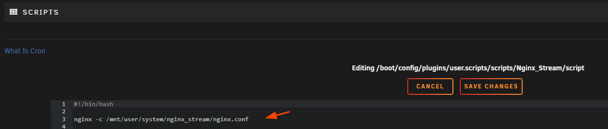

but as sample, i run the nginx from host as 2nd instance also for some stream services with a persistent config ...
for your issue, even if it would be now any other web app which Unraid would use, you can only use a port ONCE on an IP ... so in a custom br0 when a docker runs on its own IP, you can use any port you want, when you run in bridge, the exposed external port must not collide with anything else running on host or with any other exposed external ports ...

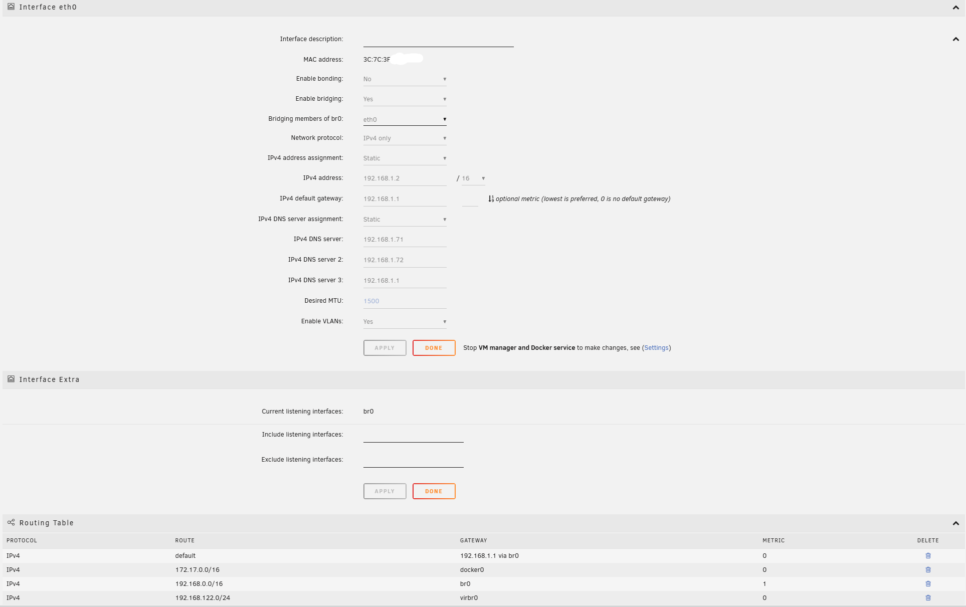

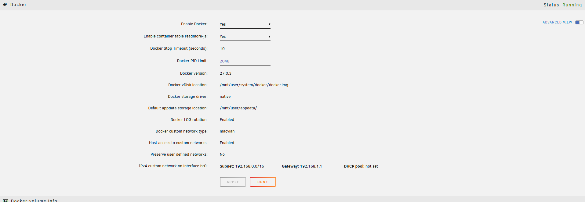

I am running into an issue that I can't seem to fix no matter what settings I try. When I try to use Nginx Proxy manager to proxy to an IP outside its subnet mask (Nginx is on a 192.168.1.0/24 subnet same as Unraid with services being accessed being on other subnets and Vlans), it always seems to throw error 502 Bad Gateway on services are on a different VLAN/Subnet but works fine if I set them on same subnet. Tried with multiple apps and services and made sure Unraid network type set to macvlan and custom network access enabled. From unraid CLI I can ping the ip address on the different subnet so it does not seem routing related issue.
Any ideas what could be causing this?
Different subnet shouldn't make a difference for the ability to connect/proxy. NPM on 10.8.8.2, container on 192.168.0.50 for example.
502 can happen with a misconfiguration of the proxy or container networking/webui even on the same subnet. Including forwarding to HTTP when the container is expecting HTTPS
I'm using custom bridged network type, br0 and macvlan in case it makes any difference.
Edited by Espressomatic
Thanks, my network type is same. Not sure what other settings I need to look at as most are default. Below are my settings, any suggestions from anyone on what to change to fix routing to a different VLAN? The issue seems Docker network settings related as pings from one docker running on base subnet to another seems to fail.
Edited by Teknowiz
I wish I had more advice but I can't think of anything else to look at. One thing to note is that while I can use different subnets, I don't have any VLANs set up anywhere at the moment.
Coincidentally, I thought I'd come across some failure of my NPM install earlier, but it turns out it's some oddity with pfSense/Unbound. I made a new override to resolve deemix.xee.to to my NPM host, the same way I have for so many other subdomains on the same FQDN, and it refused to work. Making one for "dmix" instead of "deemix" works fine. No idea why, but still the case if I do it all over again. *shrug*
