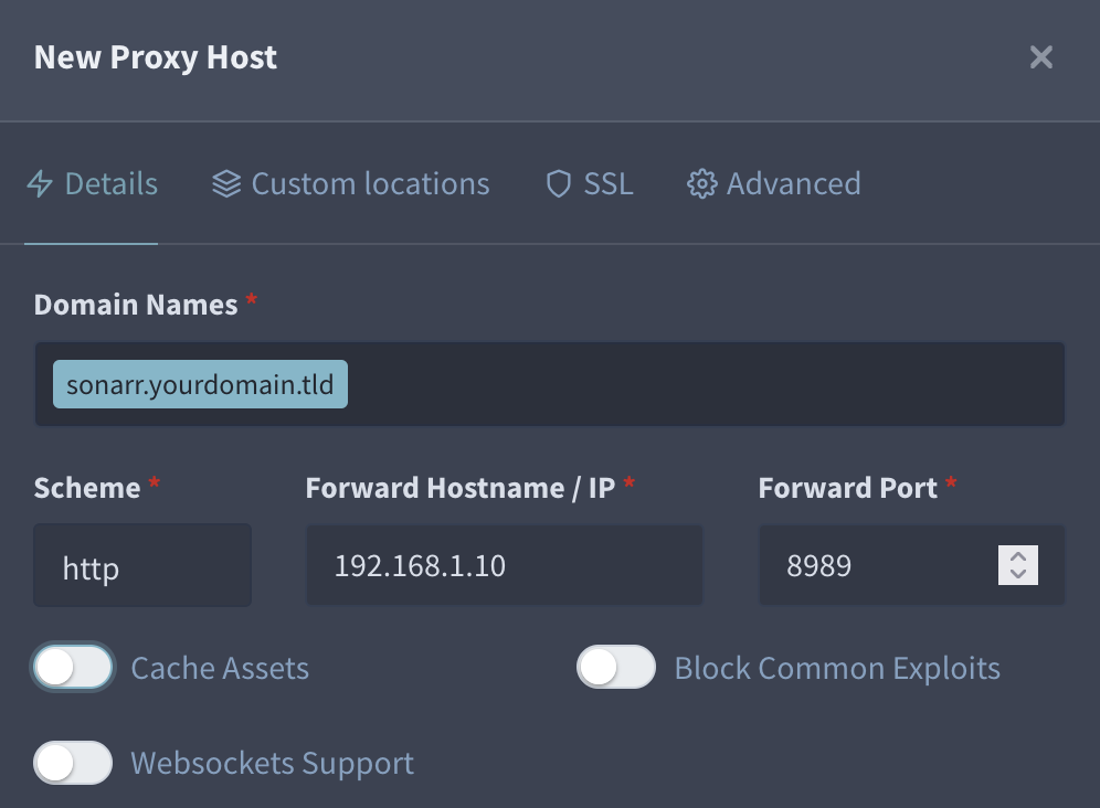

I'm trying to get Adguard Home and NPM and some apps like Sonarr, Radarr to work behind NPM.
NAS IP- 192.168.1.10
Adguard Home- 192.168.1.2
NPM IP- 192.168.1.99
I can reach NPM via something.home.com- I input the IP address of NPM in Adguard Home.
My question is, a lot of people says create a network.  I did, named it proxynet using the command docker network create proxynet.  If I assign Sonarr, Radarr to proxynet, how does it work behind NPM?  I think it will have an ip address of 172.x.x.x.
What's the way to fix this?

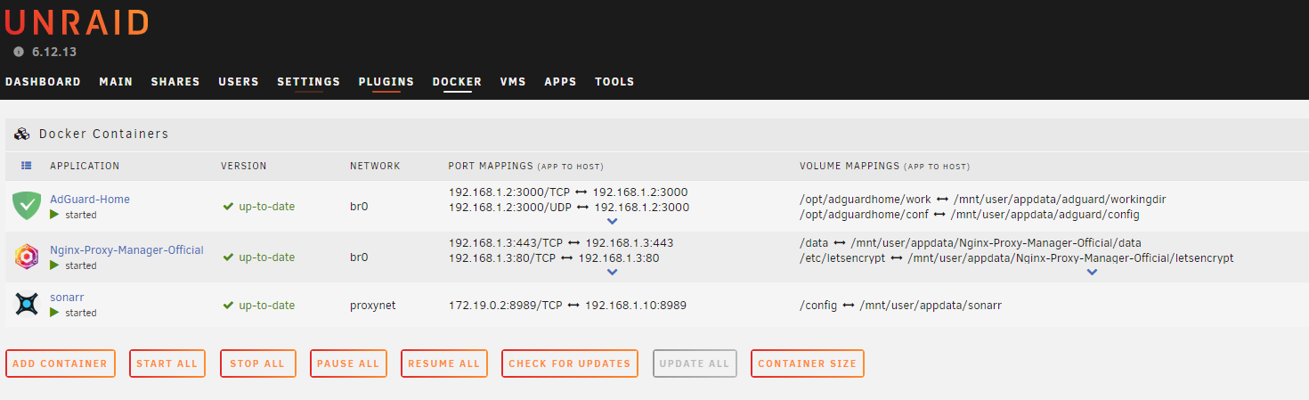

Update:
I redid the setup.  Selecting custom br0 for adguard home, assigned ip of 192.168.1.2
Installed nginx proxy manager, and used proxynet, an error occured.
"WARNING: Your kernel does not support swap limit capabilities or the cgroup is not mounted. Memory limited without swap.
b7c2e2cef967044f781812bece5c0be151faae7ac46b6875a7b6e9fa031b010a
docker: Error response from daemon: driver failed programming external connectivity on endpoint Nginx-Proxy-Manager-Official (1c106880a1f9168700163aa93143253e421c203b1bf839655532736103699c6a): Error starting userland proxy: listen tcp4 0.0.0.0:443: bind: address already in use."
When I select custom br0, it finishes successfully.  Custom br0 has subnet of 192.168.1.0/24.
Pasting my docker settings
Edited by jang430

Done!  If I use proxynet, I get the same IP address of the NAS.  To get to Nginx, I have to use NAS_IP:880.  Adguard Home DNS rewrites doesn't support NAS_IP:880.  How is it done?
NPM has to listen on 80 and 443. You need to change the ports used by Unraid, and then create an entry in NPM to point to Unraid.
This "catch-22" is why I put NPM on its own IP - and easily sharing that with Tailscale is why I didn't use the docker. :)
I thought so.  I think it would be better to have NPM on it's own IP.  But I cannot get it to work.  I don't know which network to choose for NPM.  Bridge, Host, Custom: br0 or Custom: proxynet (the one I created).  Whether I choose Bridge, or Custom: proxynet, I have to change ports of NPM.  How did you do it?
As Docker, it would be Custom br0 for its own IP within your subnet. That way it can use ports 80 and 443 without any conflicts.
I ran it this way for most of this year working very reliably. AdGuard Home also runs on br0 on a different IP. What I don't do is to any rewrites with AGH - it sends upstream to Unbound and I use Overrides on that to send FQDNs to NPM.
I only moved away from Docker when I also set up Tailscale with it.
Edited by Espressomatic
@Espressomatic

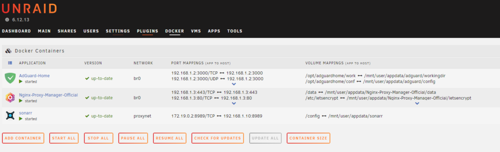

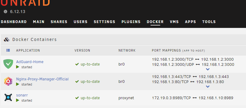

Can you share further how to make this work?  I have both Adguard Home and Nginx on Custom: br0.  They have 192.168.1.2 and 192.168.1.3 IPs respectively.  How will Nginx be able to forward to Sonarr if it's on proxynet?
Like this:
You can also change your AGH webUI port number to 80 if you want, as nothing else is on that IP.  Or you can leave it and just set 3000 as the port when you make a proxy host config for it in NPM.
