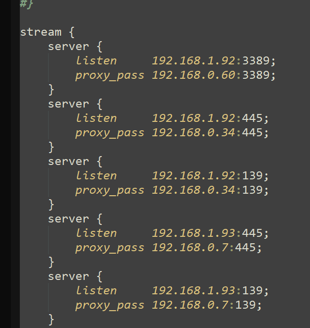

sample from a stream server nginx conf
you see here several mappings here ... usecase as sample, a homeoffice VPN Docker,
running nginx to map seeveral services in my LAN ...
simple TCP (or UDP) traffic routing, nothing else ... but needs its own port/s.

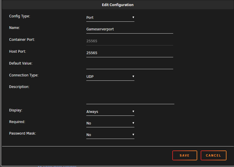

If I understand it correctly now, I open e.g. port 25565 from the router to unRAID and in unraid I create a new port config for the NGINX Docker? Like this:
and in NGINX a stream for the gameserver:
I'm hoping for more security if I run it via NGINX instead of directly to the game server
Edited by karola
Only as additional feedback:
Doing stream port forwarding does not really make sense as NPM does not add any functionality (it forwards the traffic of this port(s) simply 1:1).
The only function, which could be useful is to stop acces to the gameserver by disabling the stream port in NPM. But it should be the same effort to disable the Port in the router or by stopping the gameserver...
So you don't get more security or similar by putting NPM between the router and the target container.
Maybe in the future if NPM supports Geoblocking this could make more sense to use.
So if you don't need to control the port through NPM, you could even forward the port in your router directly to the IP/port of the gameserver
one more thing that occurred to me. If I have nginx in between, then I don't have to do port forwarding from router gameserverport to unraid hostip but to nginx. Isn't that more secure?
Otherwise I wouldn't know how to give the gameserver container its own ip address to which I can open the port from the router.
Nope. And it won't work anyway. Game servers aren't using http nor https, the only thing NPM is used for and the only thing it can apply certificates to.
Same as every other IP address on your network: DHCP - you can set a static lease (aka fixed lease, static assignment, static IP, fixed IP, etc.) from your router, which assigns your chosen IP to a specific MAC address (of your game system)
Edited by Espressomatic
