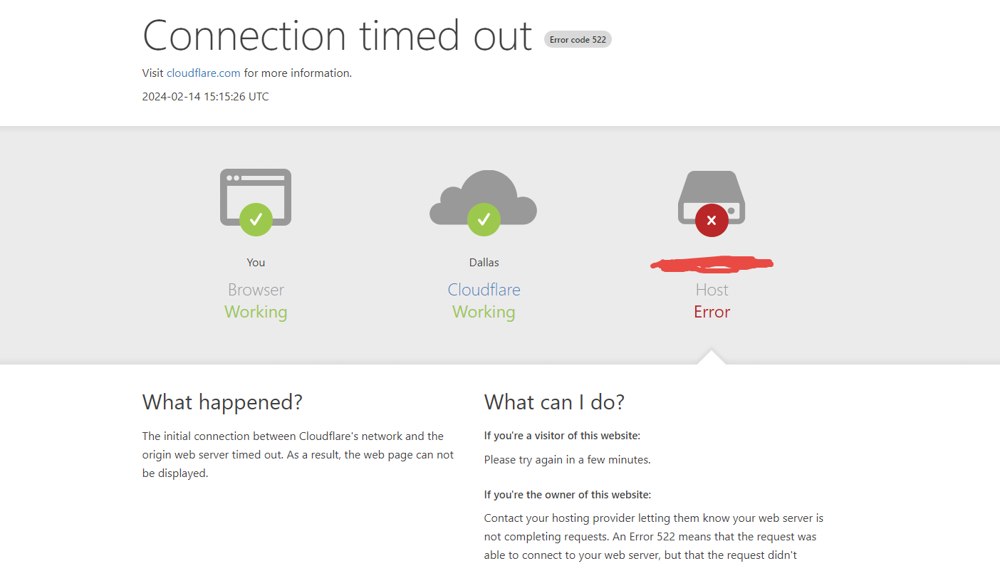

31 minutes ago, coltonc18 said:
Good morning,
I'm not sure what has happened....everything was working fine, but now all of a sudden, I'm getting 522 timeout errors.  Everything was working, but now none of my proxies work.  I have 11 setup and none work anymore.  I've got nothing in the logs either.
figured it out...damn Brightspeed changed my IP address, but not sure how to automatically detect that with cloudflare like I did with duckdns
  • Replies 1.2k

There are cloudflare ddns updater containers in Apps.
I'll look for one when I get home.
I guess most routers have the option as well. I update my IP from OPNsense.
I've got a containter setup for it now...I guess when I switched from duckdns to cloudflare I just never set it up, and forgot about that piece.

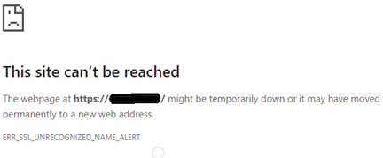

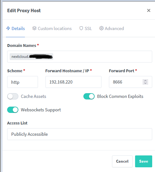

Server Error 502 Bad Gateway for Nextcloud
Running Nextcloud and NGINX Proxy Manager on UnRaid. When attempting to access Nextcloud through reverse proxy, I get a 502 Bad Gateway error. Previously I had Nextcloud setup behind a reverse proxy administered by SWAG. After a server issue in which I had to delete and rebuild my docker image file, I was unable to get SWAG working. SWAG docker is still installed on the Unraid server but is not running. I have since setup NPM to handle the reverse proxy duties. I have my own domain administered by Gandi.net; and I am using Duckdns.  I have NPM running successfully with Overseer and Bitwarden (Vaultwarden) dockers and BlueIris running in a Windows VM. I went through the steps in this post
1.)    Does the NPM container work?
Yes

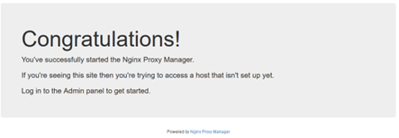

2.)    Is NPM online?
"http://XX.XX.XX.XX". Results in the following:
HTTPS gets:
3.)    Does your target container work?

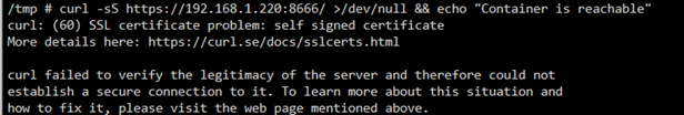

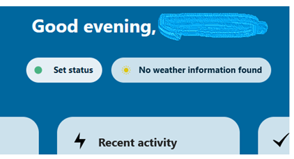

https://192.168.1.220:8666/apps/dashboard/#/
However, http://192.168.1.220:8666 results in
4.)    Does NPM reach your target container?
However, using HTTPS
All the dockers are running on the “Bridge” network.
5.)    Another reason could be that you selected the wrong scheme. For example, you used "http", but your target container only supports incoming connections through the scheme "https".
I have tried both http and https. I have tried with and without HSTS.
6.)    Or you used the wrong ports. So double check your proxy host settings!
I have checked the ports multiple times.
A weird, maybe related, side note: I cannot enter http://nextcloud.xxxxxxx.xxx , it always gets changed to https://nextcloud.xxxxxxx.xxx
Edited by crusemm
additional information
You need to use both the http port of the NC container and the http forwarding scheme. Seems you're using the https container port.
Edited by Kilrah
So how do I set that up? where is it and what changes do I need to make? Is it a NC  setting, or something in NPM?
All in NPM normally.
Are you talking about this? or is there another place to make the change?
That's it, but the whole point is to use the correct port. I don't know what your port maps for nextcloud are / whether 8666 is the correct http one and not https.

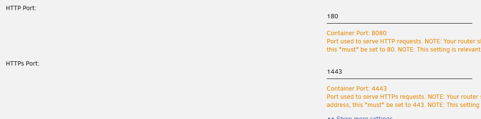

From the nextcloud docker
From the NPM docker settings
from the router Port Forwarding
Edited by crusemm
add information
That maps to 443 so it is the https port.
So how do I get NPM to send the https://nextcloud.mydomain.com to my NC docker? Or how do I get my NC to allow the http to connect through?
You've never shown the full template or mentioned which of the NC containers in CA you used, so maybe start with that.

I solved my Nextcloud issue. I had the wrong Ip address and port. I was using the Unraid IP and the NC port, when I needed to use the IP and port 443.
