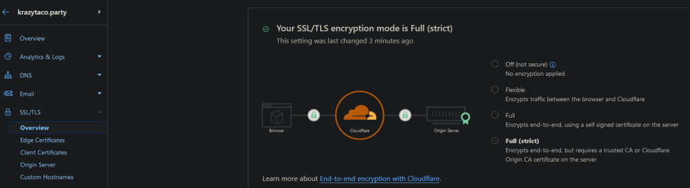

Update: I seem to have figured it out - I watched this video on how to create an SSL certificate from Cloudflare directly and use it in Nginx (as opposed to using Let's Encrypt).  In addition to the certificate, I also set my Cloudflare domain within Cloudflare to use Full (Strict) encryption
Once I did these two things I can now access the website via the internet.

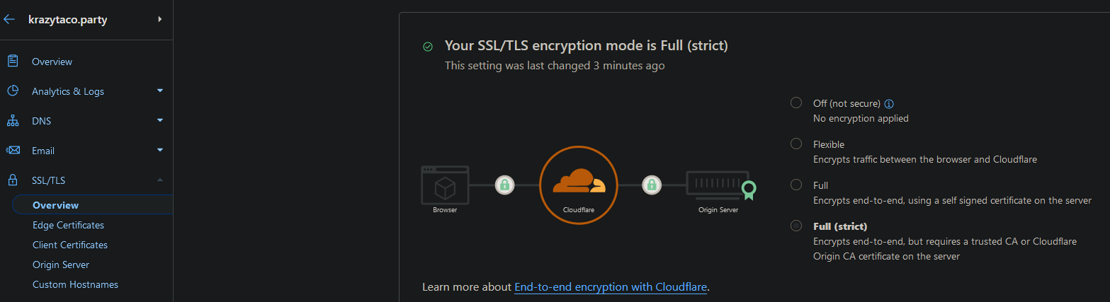

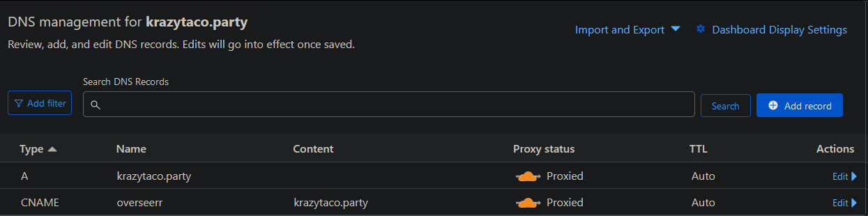

Hi there! I've gotten to the Nginx welcome page but I can't seem to get it configured to route traffic hitting my cloudflare domain name to overseerr.  I have a domain via cloudflare that's setup like below with the A record being automatically configured via the cloudfare-DDNS container in Unraid
My server runs off an Xfinity Modem/Router which doesn't allow ports to be forwarded to other ports, it only allows opening of ports - I've opened ports 80, 443, and 5055 on my router and then reconfigured Unraid to run its webUI on ports 180 and 1443
Nginx is configured to run on ports 80 and 443 - overseerr is installed and configured to run on port 5055
Within Nginx, I have a host setup to look at domain name of overseerr.krazytaco.party, scheme of https, forward hostname of 10.0.0.97, and forward port of 5055 - Let's encrypt is used to provide SSL.
image.png.8575356305ca370a47fe05d59cfcb899.pngimage.png.86e5d00c7385ddd04a59c8142398f646.png

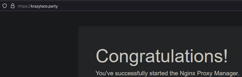

If I navigate to https:// or http://krazytaco.party I land on the Nginx congrats page
If I go to http://overseerr.krazytaco.party in either http or https form I get a bad redirect error in the browser.
What am I missing to make https://overseer.krazytaco.party accessible from the internet?
Edited by krazytaco
Added resolution details
5 hours ago, krazytaco said:
scheme of https
Probably need it to be http, that's between NPM and the service.
Whether I use http or https I have the same results it seems.
