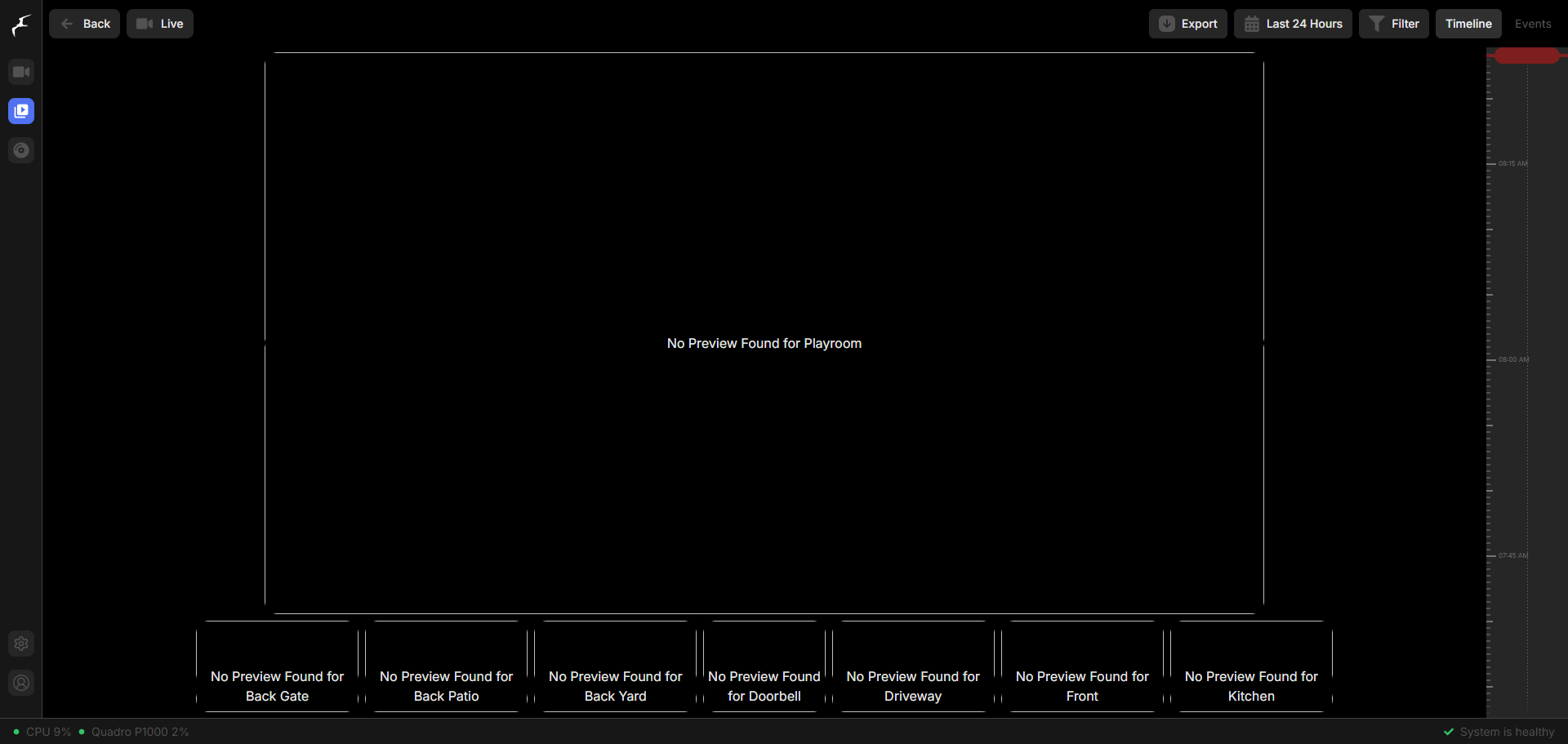

  17. Good morning, I'm having a weird issue, in the Web interface, I can see events, but when I click on them, I get an error of no events available, and I'm not sure what is happening. It was working at some point. Any thoughts? Thanks!
