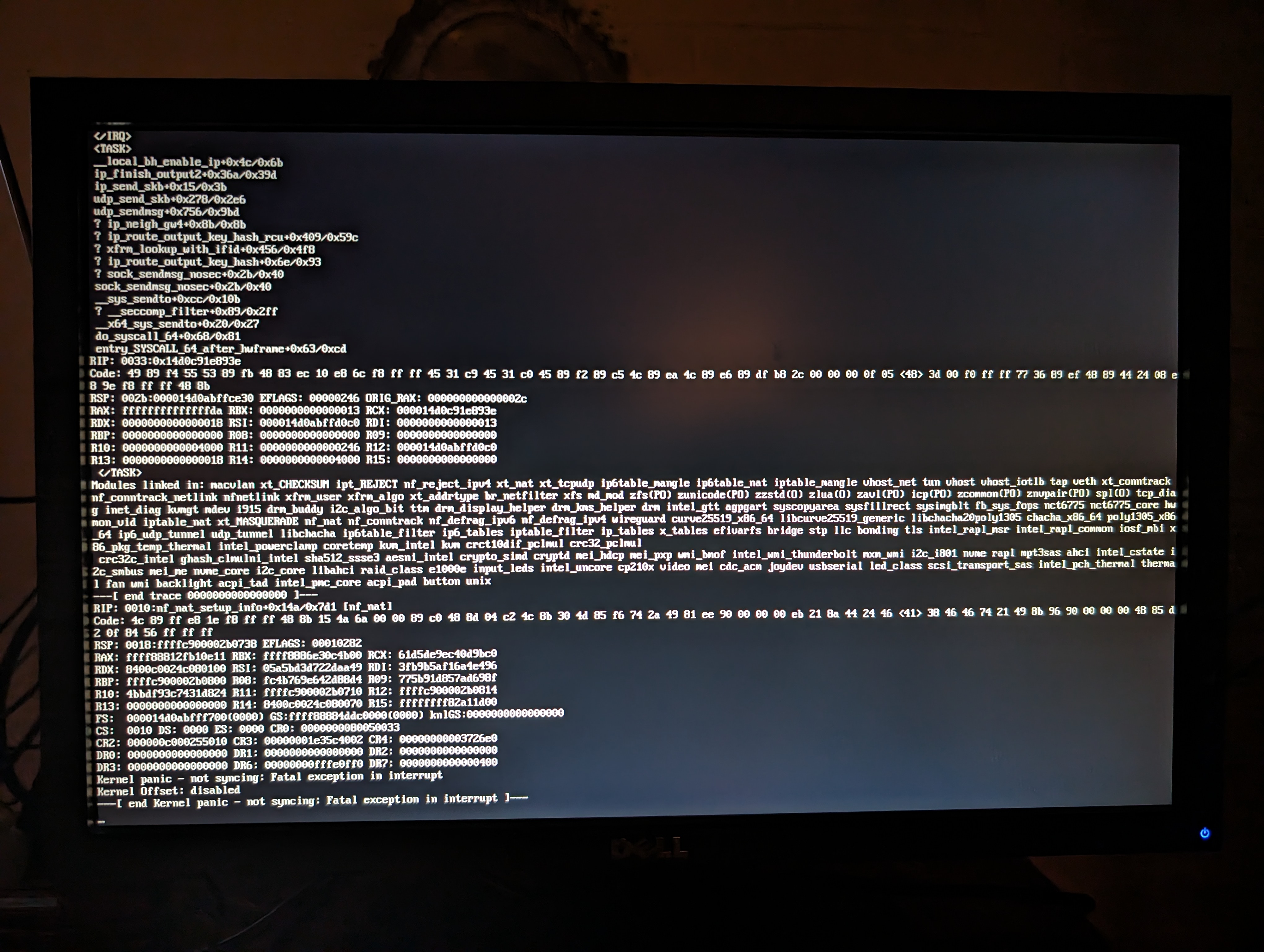

The issue happened again last night. I've attached the syslogs and what was on the screen when I found it down. I don't see anything in the logs this time around. Doesnt appear to be the RAM causing it. Any ideas on next steps? I'm going to try changing from macvlan to ipvlan to see if that might be the cause. Its the only thing I can see in the screenshot that might be the issue. syslog-192.168.0.150-20231219.log

Does that lead you to believe that macvlan is my issue and I need to configure ipvlan instead?
